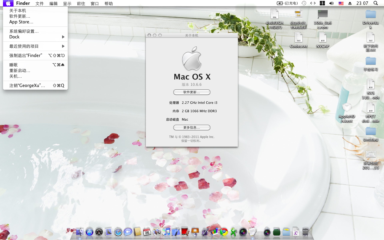

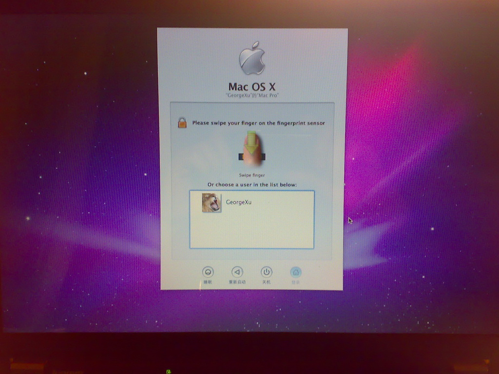

Hi, guys, I've done 10.6.6 on my "Little Black" T410.
model:ThinkPad T410i 2516A21
system:Mac OS X 10.6.3 Snow Leopard
Mac OS X 10.6.6 Snow Leopard
CPU : Intel® Core i3 M 350 @ 2.27GHz
Chipset : Intel Ibex Peak-M QM57, Intel Ironlake-M
Memory: 2 GB ( DDR3 1067MHz )
Graphic : Nvidia NVS 3100M ( 512 MB )
Sound : Conexant Cx20585

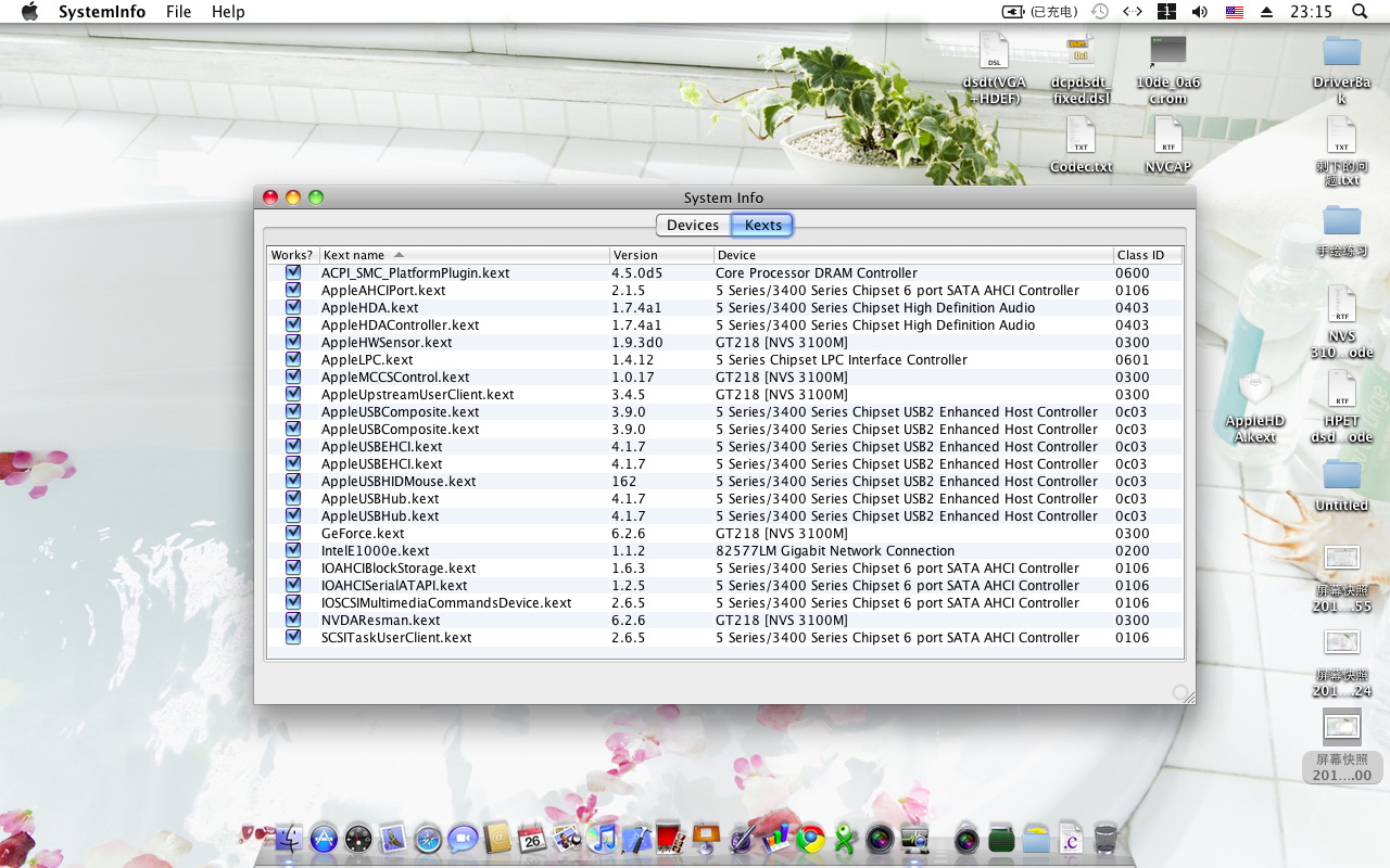

Kexts:
AppleACPIPS2Nub.kext
ApplePS2Controller.kext touchpad original
fakesmc.kext ver. 405(change REV to mbp 5.1)
IntelE1000e.kext S/L/E
NullCPUPowerManagement.kext del after dsdt
Nvtit.kext del after dsdt
PlatformUUID.kext del after dsdt
VoodooHDA.kext del after dsdt
AppleACPIBatteryManager.kext E/E
Applehda.kext S/L/E
Kexts:
Applehda.kext S/L/E
