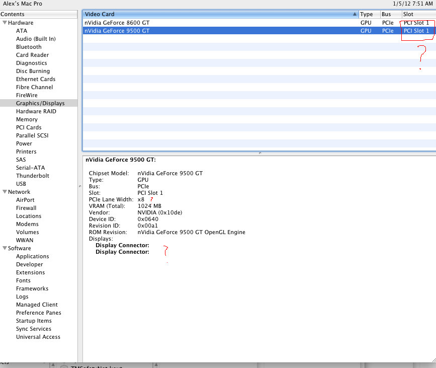

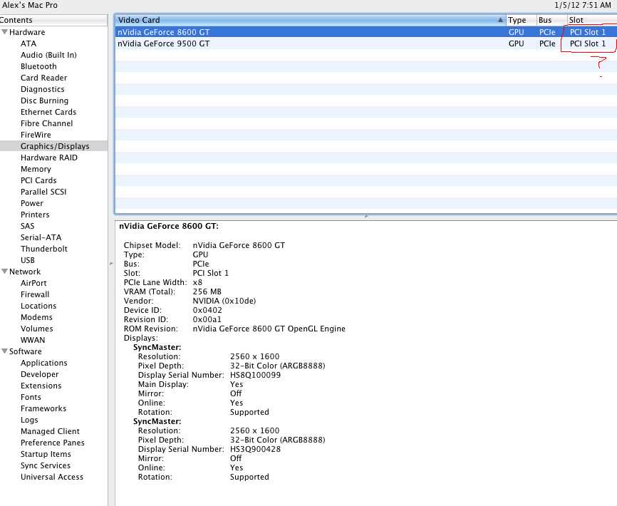

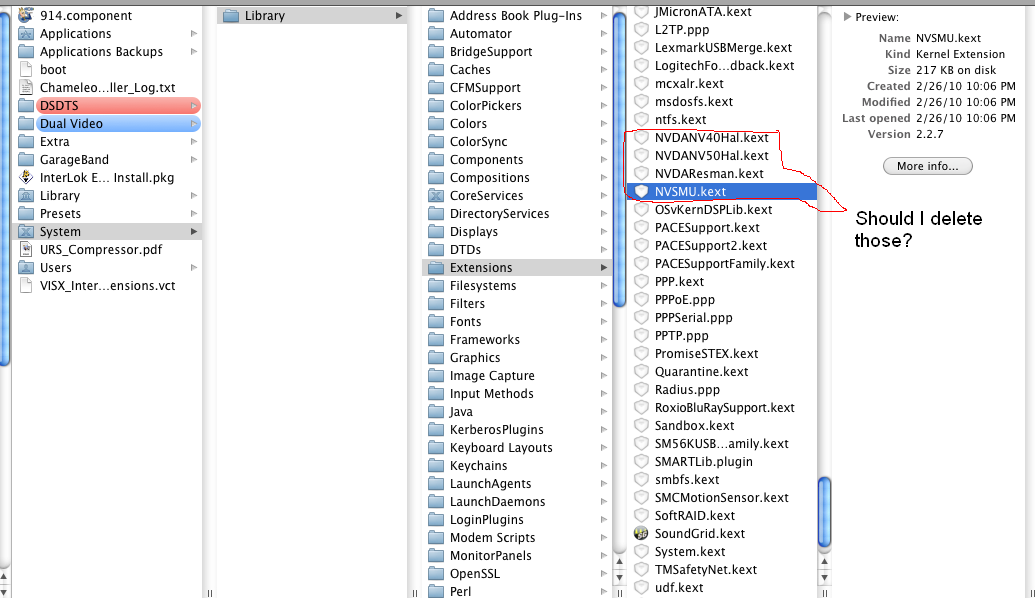

SoundForSoul Posted December 31, 2011 Share Posted December 31, 2011 I tried with Strings, but no results yet, back to DSDT method. Gigabyte x58a-ud3r rev. 2 with FF bios version, with Snow Leopard 10.6.8 I've been trying to install two graphic cards: a Gigabyte 8600 GT(256 mb) and a Gainward 9500 GT (1GB), and I got in the point where the I've put the 9500 GT in the 2nd PCI-X 16x slot, and the 8600 GT in the 4th PCI-X (8x) slot ( that was the easiest for me, as I have a moded G5 case, with the bios setting "PCI init dislpay set to PCI-X 8 ( 2 ), which is the slot that the 8600 Gt is mounted on . After selecting the partition that I want to boot from, the apple logo appears, with the white background, but without that spinning thingie, and, after few seconds, only the 2 monitors connected to the 8600 Gt are ligthing up. With the attached DSDT, both of the video card appear in the Graphic/Displays, the 8600 GT isperfectly working (at highest resolution ( 2560 x 1500 )), but the 9500 GT is not working (it is recognized, but has no outputs, even though I have two monitors plugged in its outputs). I have attached the dsdt. In the system – library – extensions – should I delete: " NVDANV40HAL.kext, NVDANVs0HAL.kext. , NVDARESMAN.kext and NVSMU.kext when using dsdt ? Are those injectors? I have edited the org.Chameleon.boot.plist in the \extra folder so that no strings or grahics enabler appears, i did that in the System configuration folder's boot.plist, too . Should I try to switch the position of the GFX Cards and put the 8600 GT in the second 16 pci-x instead of the 8x one or should I try to further edit the dsdt file, since both gfx cards appear to be in the 1st pci slot, in the Graphics/Display, section? Do you have any idea how to solve that ? I am willing to pay for somebody to help me, I have already lost 3 days of trying… If someone could recommend me a 4 output or at least 2 gfx that will work for sure with my setup, I could buy them. Thank you so much in advance! dsdt+png.rar Quote Link to comment https://www.insanelymac.com/forum/topic/247850-problem-ga-x58a-ud3r-nvidia-gt220-gt210-gt8600-dual-triple-cards/#findComment-1782459 Share on other sites More sharing options...
