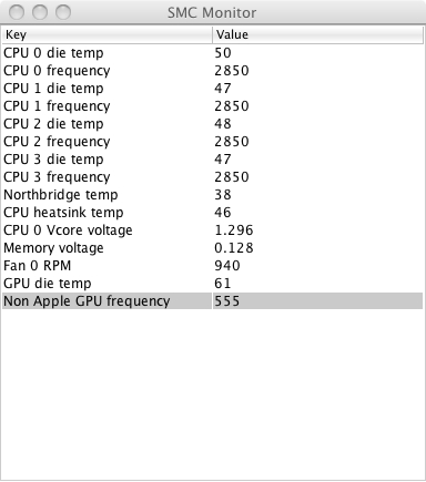

skysea76 Posted February 15, 2011 Author Share Posted February 15, 2011 SMC Monitor is reporting the right GPU freq: Link to comment https://www.insanelymac.com/forum/topic/246436-sluggish-operation-no-sleep-no-restart-no-shutdown/#findComment-1640077 Share on other sites More sharing options...
