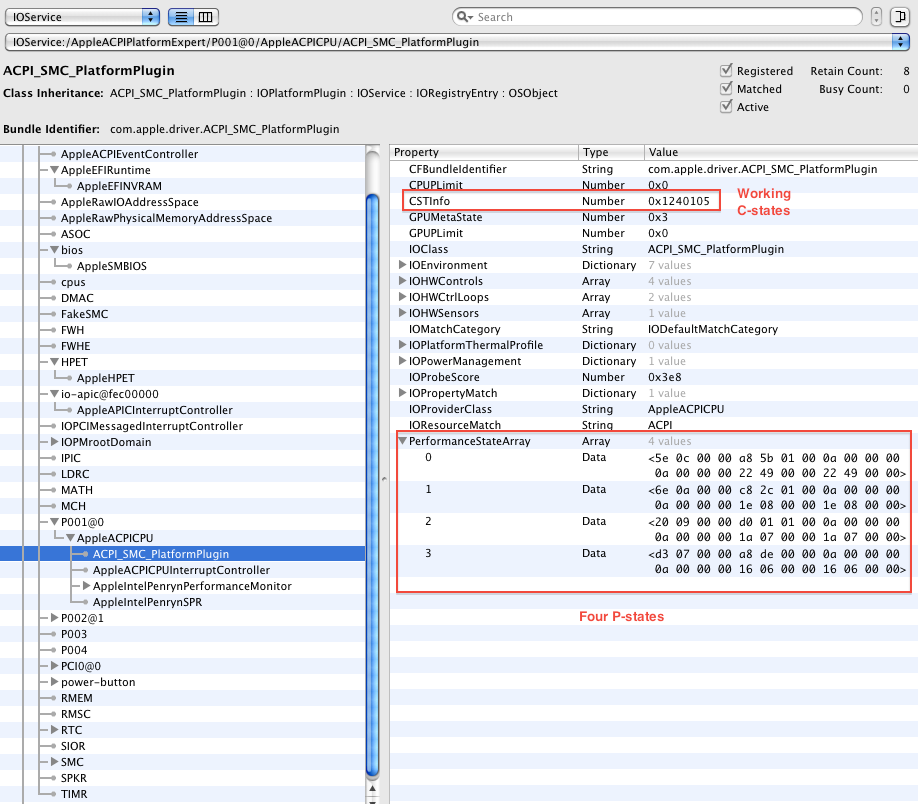

Gringo Vermelho Posted January 31, 2011 Share Posted January 31, 2011 I'm not familiar with [url="http://www.insanelymac.com/forum/topic/279450-why-insanelymac-does-not-support-tonymacx86/"]#####[/url]. I use my own install method, tailored to my hardware. Where do I start.. power management is many things. S3 sleep, hibernate and even shut down are "power management" as well. NullCPUPowerManagement.kext is a community provided kernel extensions that disables OS X's built-in CPU Power Management. This kernel extension (or disabler.kext) is required on hardware that isn't fully compatible, such as systems with an AMD- or older Intel CPU. Your hardware is compatible and, if you want native CPU Power Management to work, you should not be using NullCPUPowerManagement.kext. Follow the links I posted earlier to learn more. You can use ioregistryexplorer (comes with Apple dev tools) to see whether C-states are working, and how many CPU P-states are used. Here is an example from my system: The Apple Developer Tools can be found on your retail Snow Leopard install DVD, or you can download them for free from here: http://developer.apple.com/technologies/tools/ (registration required). Along with the latest fakesmc.kext and the proper hardware monitoring plugins, you can use iStat Menus (or Bresink's Temperature Monitor) to check your temps: To see your CPU switching states "live", you can use Mark-i: mark_i.zip I highly recommend that you follow the links I posted earlier and start reading a bit before asking further questions. Sorry, I'm very new to the Mac file system... A Mac is a hardware platform. Depending on what Operating System it is running, the filesystem used will vary. The default filesystem used by OS X is called HFS+. The default filesystem used by Windows 7 is NTFS. You can read about them here: http://en.wikipedia.org/wiki/HFS_Plus and http://en.wikipedia.org/wiki/NTFS I know that's not what you meant though. But now you know what a filesystem is. Link to comment https://www.insanelymac.com/forum/topic/245912-cant-enable-on-board-sound/#findComment-1632366 Share on other sites More sharing options...

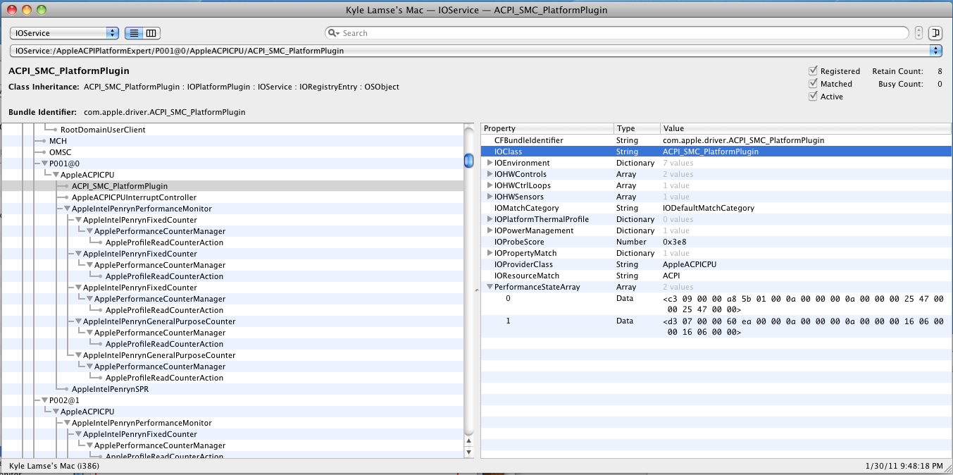

Scorxcho Posted January 31, 2011 Author Share Posted January 31, 2011 Here's what mine looks like Sadly, I STILL can't get sound to play properly I followed his steps, (step by step) Using the second method (w/o dsdt editing) The sound outputs/inputs show up in system preferences, but no actual output is coming out of my speakers. Sorry to hassle you so much, I hope I'm not bothering you... Link to comment https://www.insanelymac.com/forum/topic/245912-cant-enable-on-board-sound/#findComment-1632370 Share on other sites More sharing options...
Gringo Vermelho Posted January 31, 2011 Share Posted January 31, 2011 Sorry to hassle you so much, I hope I'm not bothering you... Of course not, and even if you were, it's my choice if I want to reply or not. Two P-states, your CPU probably can do at least four. Mine can be forced into doing eight but it didn't seem to use them all and four is good enough anyway. You have no C-states because you're using NullCPUPowerManagement.kext Link to comment https://www.insanelymac.com/forum/topic/245912-cant-enable-on-board-sound/#findComment-1632373 Share on other sites More sharing options...
