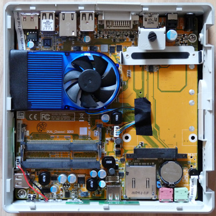

Darth Sith Lord Posted January 30, 2011 Share Posted January 30, 2011 Hallo GInGout, the new Harzard Snow Leopard 10.6.6i is annouced. Perhaps it would be a good choice to test it (doin' a new, clean install). I'm still waiting for this compilation. The adapted Chameleon (2RC3) for the ION I've also found a few month ago in the ion_itx package. This Chameleon works good, but you can't set the boot options with help of the system control panel (double click on Chameleon icon). The "build in" configurator for the *boot.plist in the Chameleon 2RC5 versions is a nice tool. Until now, I 've never tested the Asere bootloader. But perhaps soon. I' m on the search for a new ION- based mini PC. Zotac is okay, but the Foxconn box is a hard competitor. The Foxconn box without RAM and HDD is offered for 154,--€! Therefore one question about the Zotac box: "Did it have two SO-DIMM sockets for note- book RAM (dual mode), or is one socket for WLAN? Have a nice weekend. Quote Link to comment https://www.insanelymac.com/forum/topic/245149-zotac-zbox-hd-nd22/#findComment-1631984 Share on other sites More sharing options...

Darth Sith Lord Posted February 3, 2011 Share Posted February 3, 2011 Hallo GInGout, here are some answers: a: I ' m started with OSx86 on AMD based motherboards tree years ago. That's the reason why I do prefere AMD based (Snow) Leopard versions like Hazard, iPC or others. b: 18 month ago I took a deeper look into the hardware of Mac mini's and Macbooks. So I decided to test XFX and MSI mainboards with the ION chipset. c: Last September I bought a ASUS EeeBoxPC 1501U. The EeeBoxPC runs without modifications with the HDD's from the ION- based mainboards I 've tested before. d: Now I'm planning to build up the cheapest Mac clone. Therefore I think, the Zotac ND-22 is the best solution, because the Foxconn nt525 Box has only one SO-DIMM socket. The Zotac Box is planned to be placed behind a 24" full HD+ monitor. So it is a good alternative to a notebook. Bye. Quote Link to comment https://www.insanelymac.com/forum/topic/245149-zotac-zbox-hd-nd22/#findComment-1633934 Share on other sites More sharing options...
