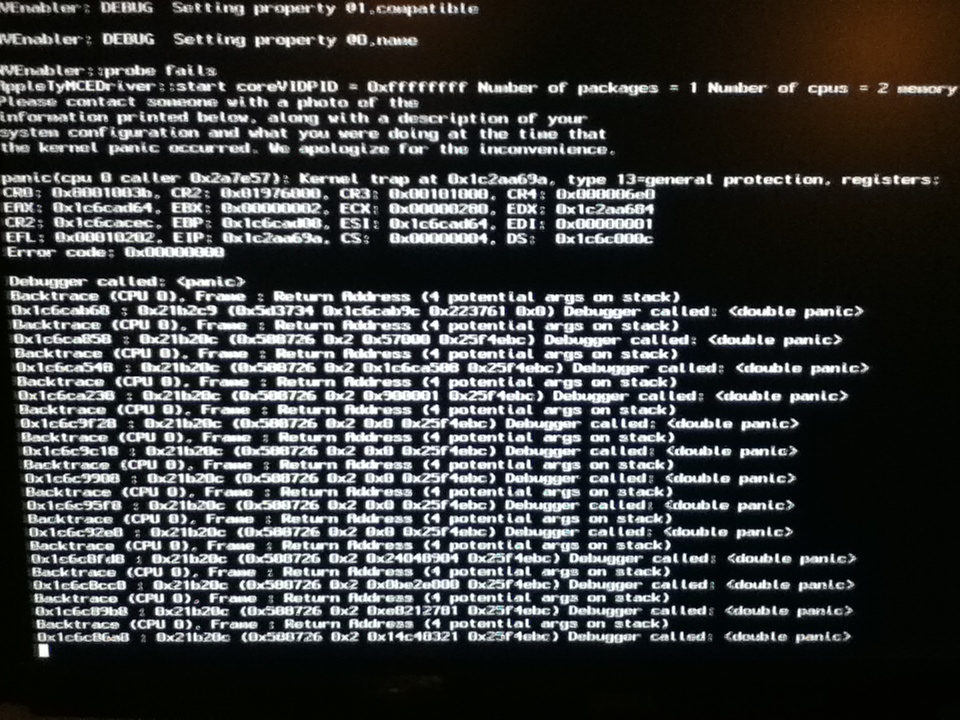

So I completed the install of 10.6.2, but I keep getting a CPU panic (see image).
If I choose -x for safe mode it boots fine (but I have no ethernet, or audio). There are no devices for ether in the System Preferences.
I was wondering if someone can help me with the following things:
1. find root cause/solution for the cpupanic (being able to boot without a panic and without going into safemode
2. Help install the correct kext for audio
3. Help installing the correct kext for network
4. Help installing correct/updated video drivers/kexts
4. Confirming that I have the correct video drivers installed.

gpu is too old i'm told. support was dropped in 10.6. nevertheless i've seen people do it with much dsdt hacking, which i don't understand yet. mine compiles, but not after messing w/ gpu related stuff.
anyway, try nv_disable=1 boot flag. that'll boot everything else except nv kexts, so you still have audio / ethernet etc till you figure it out / swap graphics cards.
