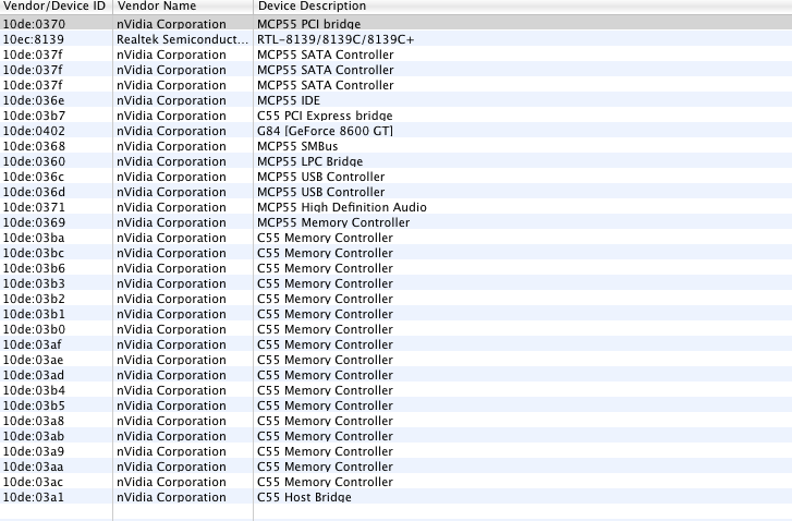

verdant Posted January 4, 2011 Share Posted January 4, 2011 Many thanks for taking time to reply. You said Jmicron port.My motherboard is XFX 680i sli and where can i find the jmicron port or find it is having one? I searched this forum as many have troubles with SATA dvd burning. It probably does not have a JMicron controller onboard.......but check by installing and running DPCIManager........ Quote Link to comment https://www.insanelymac.com/forum/topic/241460-xfx-680i-sli-90-working-please-help/#findComment-1614571 Share on other sites More sharing options...
mediamac Posted January 4, 2011 Author Share Posted January 4, 2011 It probably does not have a JMicron controller onboard.......but check by installing and running DPCIManager........ As you said i think it does not have Jmicron.So what shall i do purchase IDE burner or external USB converter.I have attached the screenshot of the DPCI manager. Thanks. Quote Link to comment https://www.insanelymac.com/forum/topic/241460-xfx-680i-sli-90-working-please-help/#findComment-1614589 Share on other sites More sharing options...
verdant Posted January 4, 2011 Share Posted January 4, 2011 As you said i think it does not have Jmicron.So what shall i do purchase IDE burner or external USB converter.I have attached the screenshot of the DPCI manager.Thanks. I would purchase a IDE DVDRW to put in the PC now and an external USB enclosure for the SATA DVDRW whenever you want later on.......but the choice is yours...... Quote Link to comment https://www.insanelymac.com/forum/topic/241460-xfx-680i-sli-90-working-please-help/#findComment-1614615 Share on other sites More sharing options...
