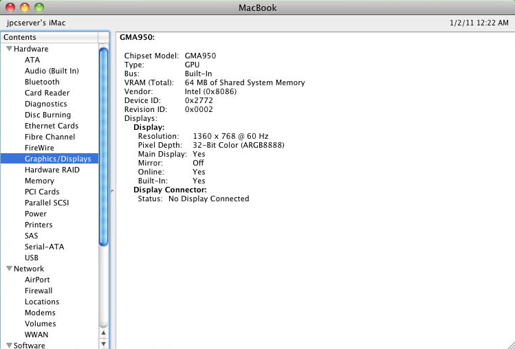

bricamac Posted January 1, 2011 Share Posted January 1, 2011 Introduction to the Shuttle X50 is with this specs: PROCESSOR Intel Atom 330 CPU CHIPSET Intel 945GC + ICH7 VGA Intel GMA 950 256bit 3D engine with a powerful 400MHz core and DirectX 9 3D hardware acceleration Dynamic Video Memory Technology(DVMT)3.0 supports up to 224MB of Video memory AUDIO Realtek ALC662 5.1 Channel High Definition audio ETHERNET RTL8111C 10MB/s,100MB/s,1GB/s LCD Panel 15.6" 16:9 Wide Panel, 1366 x 768 pixels … all seem nice to install macos on it… I could install 10.6.5 using PC EFI method without any problem ( PC EFI 10.6, DSDT modified with DSDTEditor, custom atom kernel). I could run the system with VESA mode. But if I patch my DSDT file i could active my GMA 950 card (device ID: 0x2772), but my internal screen isn't recognize. I could connect only an external screen.... So to see more, I have activated the remote manager then when I don't connect external screen , I could take a look the screen property( see the screen shot) Since severals days i try to be able to use my build-in screen but without any success. May you help me ? Seem my DSDT for my video: ..... Device (PEGP) { Name (_ADR, 0x00020000) Device (GFX0) { Name (_ADR, Zero) } Method (_DSM, 4, NotSerialized) { Store (Package (0x06) { "AAPL,HasPanel", Buffer (0x04) { 0x01, 0x00, 0x00, 0x00 }, "AAPL01,EDID", Buffer (0x80) { /* 0000 */ 0x00, 0xFF, 0xFF, 0xFF, 0xFF, 0xFF, 0xFF, 0x00, /* 0008 */ 0x00, 0x00, 0x17, 0x07, 0x00, 0x00, 0x00, 0x00, /* 0010 */ 0x0A, 0x0A, 0x01, 0x01, 0x0C, 0x1E, 0x17, 0xBE, /* 0018 */ 0xE8, 0x2D, 0xC9, 0xA0, 0x57, 0x47, 0x98, 0x27, /* 0020 */ 0x12, 0x48, 0x4C, 0x00, 0x00, 0x00, 0x01, 0x01, /* 0028 */ 0x01, 0x01, 0x01, 0x01, 0x01, 0x01, 0x01, 0x01, /* 0030 */ 0x01, 0x01, 0x01, 0x01, 0x01, 0x01, 0x00, 0x00, /* 0038 */ 0x00, 0xFE, 0x00, 0x53, 0x52, 0x58, 0x46, 0x61, /* 0040 */ 0x6B, 0x65, 0x45, 0x44, 0x49, 0x44, 0x0A, 0x20, /* 0048 */ 0x01, 0x01, 0x01, 0x01, 0x01, 0x01, 0x01, 0x01, /* 0050 */ 0x01, 0x01, 0x01, 0x01, 0x01, 0x01, 0x01, 0x01, /* 0058 */ 0x01, 0x01, 0x01, 0x01, 0x01, 0x01, 0x01, 0x01, /* 0060 */ 0x01, 0x01, 0x01, 0x01, 0x01, 0x01, 0x01, 0x01, /* 0068 */ 0x01, 0x01, 0x01, 0x01, 0x01, 0x01, 0x01, 0x01, /* 0070 */ 0x01, 0x01, 0x01, 0x01, 0x01, 0x01, 0x01, 0x01, /* 0078 */ 0x01, 0x01, 0x01, 0x01, 0x01, 0x01, 0x00, 0x5A }, "model", Buffer (0x07) { "GMA950" } }, Local0) DTGP (Arg0, Arg1, Arg2, Arg3, RefOf (Local0)) Return (Local0) } } } I found a problem that exist before with ubuntu ( https://bugs.launchpad.net/ubuntu/+source/x...tel/+bug/375545 ) but that have been resolve... perhaps that will talk to some Guru ;-) More information on the GMA card : 00:02.0 VGA compatible controller [0300]: Intel Corporation 82945G/GZ Integrated Graphics Controller [8086:2772] (rev 02) Subsystem: Holco Enterprise Co, Ltd/Shuttle Computer Device [1297:3151] Control: I/O+ Mem+ BusMaster+ SpecCycle- MemWINV- VGASnoop- ParErr- Stepping- SERR- FastB2B- DisINTx- Status: Cap+ 66MHz- UDF- FastB2B+ ParErr- DEVSEL=fast >TAbort- <TAbort- <MAbort- >SERR- <PERR- INTx- Latency: 0 Interrupt: pin A routed to IRQ 10 Region 0: Memory at fdf00000 (32-bit, non-prefetchable) Region 1: I/O ports at ff00 Region 2: Memory at d0000000 (32-bit, prefetchable) Region 3: Memory at fdf80000 (32-bit, non-prefetchable) Capabilities: [90] Message Signalled Interrupts: Mask- 64bit- Queue=0/0 Enable- Address: 00000000 Data: 0000 Capabilities: [d0] Power Management version 2 Flags: PMEClk- DSI+ D1- D2- AuxCurrent=0mA PME(D0-,D1-,D2-,D3hot-,D3cold-) Status: D0 PME-Enable- DSel=0 DScale=0 PME- Kernel modules: intelfb Thanks in advance for your help Link to comment https://www.insanelymac.com/forum/topic/241424-please-help-me-with-my-shuttle-x50/ Share on other sites More sharing options...
