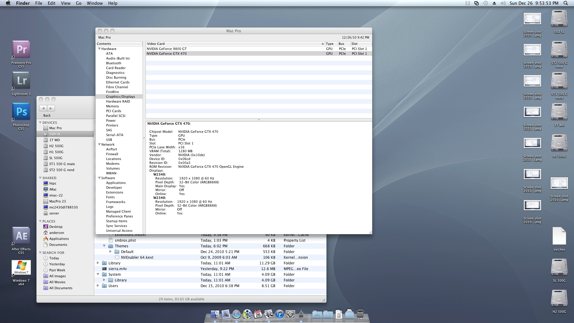

tetak Posted December 27, 2010 Share Posted December 27, 2010 Yes , you can find some guides . After so many hours i did but ....Got problem with pci slots - i change places all oround but stil same. both cards showing pci slot 1 !!!!!!. It works but main card is 9800GT , i like to be GTX 470 . All setup is in DSDT.aml file. Didn't use a in.plist or graphic enabler. Need help. p.s. I try all peg's in bios, still same GA-X58A-UD3R MY DSDT you can see as txt file (delete txt extension) DSDT.AML.TXT Link to comment https://www.insanelymac.com/forum/topic/240532-dual-gpu-in-snow-leopard-vanilla-only/#findComment-1609462 Share on other sites More sharing options...
