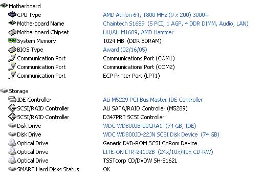

Black Knight Posted August 9, 2006 Share Posted August 9, 2006 I have been contacted upon many instances on how to get SATA and UDMA working on several different motherboards with a few different ULi Southbridges and since I now feel pretty confident that this method will work on each quite well, I wanted to summarize the several topics into one. First, getting UDMA modes for the ALi/ULi 0x522910B9 chip is as simple as adding 0x522910B9 to the SATA section of /system/library/extensions/AppleVIAATA.kext/Contents/Info.plist. That's right, I said the SATA section and not the PATA section. I don't know why this works, but it does. You must then remove or rename /system/library/extensions/IOATAFamily.kext/Contents/Plugins/AppleGenericPCATA.kext so that it will not conflict with the VIA kext. If you are only going for UDMA modes, then run in Terminal: chown -R root:wheel /system/library/extensions/ chmod -R 755 /system/library/extensions/ and finally repair permissions in Disk Utility. If you want SerialATA as well, wait and do these steps after the second step. Second, getting SATA to work on ALi/ULi 0x528810B9 (ULi 1575 southbridge) 0x528910B9 (ULi 1567 southbridge) and possibly 0x528710B9 (I submitted the idea to the person having trouble with this one and haven't heard back yet). To get these to work, you once again need to edit AppleVIAATA.kext/Contents/Info.plist and add these three (or just the one you have if you know which one already) device ID(s) to the SATA section. The last thing you must do is go into your BIOS and set your SATA controller from AHCI mode to Emulated PATA mode. This shouldn't apply to the 0x528910B9 device ID as it is only SATA I mode and doesn't support AHCI anyways. Good luck, Paul Link to comment https://www.insanelymac.com/forum/topic/24047-how-to-enable-sata-and-udma-modes-for-most-uli-chipsets/ Share on other sites More sharing options...
