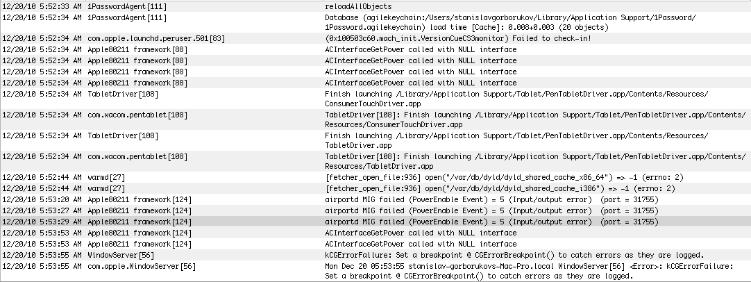

slavo234 Posted December 16, 2010 Share Posted December 16, 2010 Three days ago i have bought Asus WL138g v2 Wi-Fi card for my Osx. First time it works perfect but in next reboot this thing was not detected by PC. I have rebooted my PC three times but it not helped. Also i tried -arch=i386. And in fifth time reboot it worked. I need to reboot about three or four times every day for make my AirPort working. It's annoying. Any suggestions? My conf: Asus P5LD2-x /1333 Intel Core 2 Duo 2.22 Ghz nVidia GeForce EN9600GT 1G 2Gb of RAM. Hazard Snow Leopard 10.6 Link to comment https://www.insanelymac.com/forum/topic/240043-solved-please-help-with-wi-fi/ Share on other sites More sharing options...

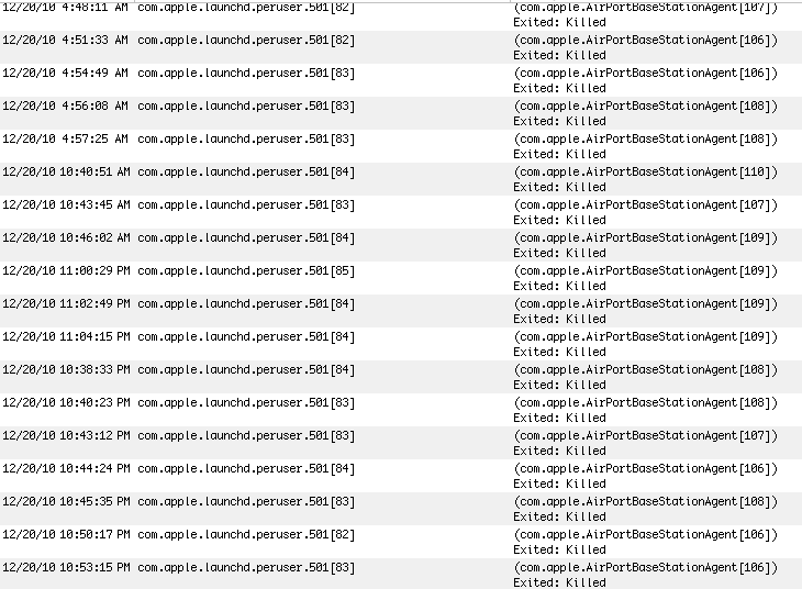

slavo234 Posted December 21, 2010 Author Share Posted December 21, 2010 Bump. and next screenshot Link to comment https://www.insanelymac.com/forum/topic/240043-solved-please-help-with-wi-fi/#findComment-1606418 Share on other sites More sharing options...
josephien Posted December 21, 2010 Share Posted December 21, 2010 try using another pci slot Link to comment https://www.insanelymac.com/forum/topic/240043-solved-please-help-with-wi-fi/#findComment-1606451 Share on other sites More sharing options...
slavo234 Posted December 21, 2010 Author Share Posted December 21, 2010 try using another pci slot Ok. I will try it now. If it worked i tell you. UPDATE: Big thanks! I can't believe that it's so simple! Link to comment https://www.insanelymac.com/forum/topic/240043-solved-please-help-with-wi-fi/#findComment-1606453 Share on other sites More sharing options...
