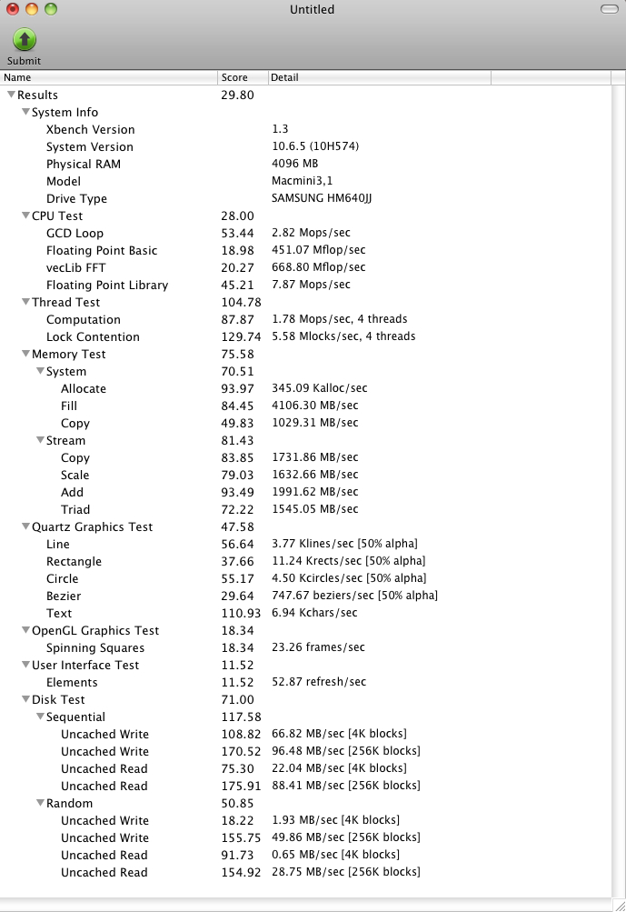

bowlman13 Posted December 14, 2010 Share Posted December 14, 2010 Hello breathless, thanks for finishing off my build, as I have been working on mine for about 3 weeks. Had that Dsdt for a couple of weeks, but never had the guts to use it, didn't want to mess up my dual book with a reinstall. I actually lost about 10% on my xbench score, but having proper USB is worth it! Speaking of xbench, Open GL and user interface are waaay low compared to a mac mini with the 9400M, we really need to find a way to bump those up, (OpenGL Graphics Test 20.50 & User Interface Test 19.59) any thoughts, or are yours better? Thanks again! Link to comment https://www.insanelymac.com/forum/topic/239382-guide-foxconn-nt330i-snow-leopard-guide-nvidia-ion-nettop/#findComment-1602190 Share on other sites More sharing options...
Breathless Posted December 14, 2010 Author Share Posted December 14, 2010 Hello breathless, thanks for finishing off my build, as I have been working on mine for about 3 weeks. Had that Dsdt for a couple of weeks, but never had the guts to use it, didn't want to mess up my dual book with a reinstall. I actually lost about 10% on my xbench score, but having proper USB is worth it! Speaking of xbench, Open GL and user interface are waaay low compared to a mac mini with the 9400M, we really need to find a way to bump those up, (OpenGL Graphics Test 20.50 & User Interface Test 19.59) any thoughts, or are yours better? Thanks again! I absolutely agree, the graphics performance is not where it needs to be. I haven't run those tests yet but I will when I get the chance and post back. If anyone has any ideas how we can bump up a graphics performance, feel free to chime in. Here are my Xbench Results: Link to comment https://www.insanelymac.com/forum/topic/239382-guide-foxconn-nt330i-snow-leopard-guide-nvidia-ion-nettop/#findComment-1602199 Share on other sites More sharing options...
bluebag Posted December 15, 2010 Share Posted December 15, 2010 I absolutely agree, the graphics performance is not where it needs to be. I haven't run those tests yet but I will when I get the chance and post back. If anyone has any ideas how we can bump up a graphics performance, feel free to chime in. Here are my Xbench Results: Thanks to both of you for all the hard work on this. What are the figures like on a Mac Mini? Link to comment https://www.insanelymac.com/forum/topic/239382-guide-foxconn-nt330i-snow-leopard-guide-nvidia-ion-nettop/#findComment-1602594 Share on other sites More sharing options...
Breathless Posted December 15, 2010 Author Share Posted December 15, 2010 Thanks to both of you for all the hard work on this. What are the figures like on a Mac Mini? That would be great to see. Bowlman, you have any xbench results for Mac Mini? Link to comment https://www.insanelymac.com/forum/topic/239382-guide-foxconn-nt330i-snow-leopard-guide-nvidia-ion-nettop/#findComment-1602778 Share on other sites More sharing options...
bowlman13 Posted December 16, 2010 Share Posted December 16, 2010 That would be great to see. Bowlman, you have any xbench results for Mac Mini? Take a look at these results for comparison Open GL and User Interface are the killers..By the way, We should search the IONITX threads for results from the Zotac.macmini.html So here is a Zotac to compare, Seems we aren't so bad!Zotac.html Link to comment https://www.insanelymac.com/forum/topic/239382-guide-foxconn-nt330i-snow-leopard-guide-nvidia-ion-nettop/#findComment-1603428 Share on other sites More sharing options...
