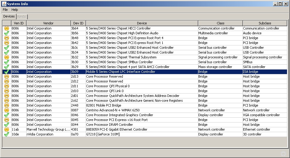

The village idiot Posted December 2, 2010 Share Posted December 2, 2010 Thanks, for some reason I couldn't find that the last several times I searched for it. Here is what it gives, the items with an * are the items with the unhappy face. Everything else either had a green check mark or happy face. * 8086 Intel Corporation 3b64 5 Series/3400 Series Chipset HECI Controller Communication controller Communication controller 8086 Intel Corporation 3b56 5 Series/3400 Series Chipset High Definition Audio Multimedia controller Audio device 8086 Intel Corporation 3b48 5 Series/3400 Series Chipset PCI Express Root Port 4 Bridge PCI bridge 8086 Intel Corporation 3b42 5 Series/3400 Series Chipset PCI Express Root Port 1 Bridge PCI bridge 8086 Intel Corporation 3b3c 5 Series/3400 Series Chipset USB2 Enhanced Host Controller Serial bus controller USB Controller 8086 Intel Corporation 3b34 5 Series/3400 Series Chipset USB2 Enhanced Host Controller Serial bus controller USB Controller * 8086 Intel Corporation 3b32 5 Series/3400 Series Chipset Thermal Subsystem Signal processing controller Signal processing controller 8086 Intel Corporation 3b30 5 Series/3400 Series Chipset SMBus Controller Serial bus controller SMBus 8086 Intel Corporation 3b29 5 Series/3400 Series Chipset 4 port SATA AHCI Controller Mass storage controller SATA controller 8086 Intel Corporation 3b09 Mobile 5 Series Chipset LPC Interface Controller Bridge ISA bridge 8086 Intel Corporation 2d13 Core Processor Reserved Bridge Host bridge 8086 Intel Corporation 2d12 Core Processor Reserved Bridge Host bridge 8086 Intel Corporation 2d11 Core Processor QPI Physical 0 Bridge Host bridge 8086 Intel Corporation 2d10 Core Processor QPI Link 0 Bridge Host bridge 8086 Intel Corporation 2d01 Core Processor QuickPath Architecture System Address Decoder Bridge Host bridge 8086 Intel Corporation 2c62 Core Processor QuickPath Architecture Generic Non-core Registers Bridge Host bridge 8086 Intel Corporation 2448 82801 Mobile PCI Bridge Bridge PCI bridge * 8086 Intel Corporation 0087 Centrino Advanced-N + WiMAX 6250 Network controller Network controller 8086 Intel Corporation 0046 Core Processor Integrated Graphics Controller Display controller VGA compatible controller 8086 Intel Corporation 0045 Core Processor PCI Express x16 Root Port Bridge PCI bridge 8086 Intel Corporation 0044 Core Processor DRAM Controller Bridge Host bridge * 11ab Marvell Technology Group Ltd. 4381 88E8059 PCI-E Gigabit Ethernet Controller Network controller Ethernet controller 10de nVidia Corporation 0a70 GT218 [GeForce 310M] Display controller 3D controller Quote Link to comment https://www.insanelymac.com/forum/topic/238677-driver-help-for-snow-leopard/#findComment-1595171 Share on other sites More sharing options...
Dellmantt Posted December 2, 2010 Share Posted December 2, 2010 Thanks, for some reason I couldn't find that the last several times I searched for it. Here is what it gives, the items with an * are the items with the unhappy face. Everything else either had a green check mark or happy face. * Is this for a samsung QX410 laptop, which this thread about or for a system that you have a topic about elsewhere? Quote Link to comment https://www.insanelymac.com/forum/topic/238677-driver-help-for-snow-leopard/#findComment-1595174 Share on other sites More sharing options...
The village idiot Posted December 2, 2010 Share Posted December 2, 2010 Is this for a samsung QX410 laptop, which this thread about or for a system that you have a topic about elsewhere? It is for a Samsung QX410, the only thread that came up in a search. Didn't feel it needed a separate thread but I'll certainly make one if you think it is best. What I needed was similar enough to make me just post in this thread and certainly does provide the information required about the hardware. These were $150 off last week in the USA so there may be other people interested in getting this laptop working. Quote Link to comment https://www.insanelymac.com/forum/topic/238677-driver-help-for-snow-leopard/#findComment-1595436 Share on other sites More sharing options...
Dellmantt Posted December 2, 2010 Share Posted December 2, 2010 It is for a Samsung QX410, the only thread that came up in a search. Didn't feel it needed a separate thread but I'll certainly make one if you think it is best. What I needed was similar enough to make me just post in this thread and certainly does provide the information required about the hardware. These were $150 off last week in the USA so there may be other people interested in getting this laptop working. No need for a new thread. Just checking was same hardware. Looks like the problem is going to be the Marvell Yukon 88E8059 PCI-E Gigabit Ethernet Controller, can't find anyone with it working. Quote Link to comment https://www.insanelymac.com/forum/topic/238677-driver-help-for-snow-leopard/#findComment-1595501 Share on other sites More sharing options...
