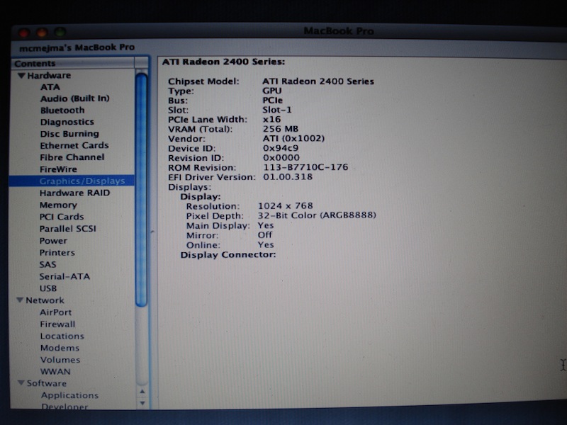

Larx Posted November 15, 2010 Share Posted November 15, 2010 Good news. I managed to run Ati Radeon 2400 at a resolution of 1024x768 on the internal monitor. Fujitsu Siemens PI2550 Core 2 Duo T8100 2.10 GHz Snow Leopard 10.6.5 Details about the process through a couple of hours. Testing in progress! Link to comment https://www.insanelymac.com/forum/topic/237224-ati-radeon-2400-hd-works/ Share on other sites More sharing options...

Larx Posted November 15, 2010 Author Share Posted November 15, 2010 Unbelievable! I installed iATKOS S3 ver.2 Asere 1.1.9 wint chameleon2 RC4 with graphic enabler. After completed installation restart of course, in safe mode -x mode. I deleted all ATI Radeon kexts except: ATI2400Controller.kext, ATIFramebuffer.kext and ATISupport.kext. Restart and boot in normal mode. No hardware acceleration , but the good thing is internal monitor works ! I am a beginner and this is my second hackitosh, but if this is something that can help on this, hm .... It would be great to have a Ati Radeon 2400 fully functional. Thank you. Here is the picture. A lot of people looking solution for this type of ATI Radeon! Hm! Here is a good base to continue to explore, i hope ! Link to comment https://www.insanelymac.com/forum/topic/237224-ati-radeon-2400-hd-works/#findComment-1584086 Share on other sites More sharing options...
dothacker Posted November 15, 2010 Share Posted November 15, 2010 yeah, 1024x768 works, but other than that, no QE/CI on Snow Leopard. here, read this: http://www.insanelymac.com/forum/index.php?showtopic=107526 Link to comment https://www.insanelymac.com/forum/topic/237224-ati-radeon-2400-hd-works/#findComment-1584115 Share on other sites More sharing options...

Larx Posted November 21, 2010 Author Share Posted November 21, 2010 Yeah! I've managed to install it on Leopard with QE / CI only an external monitor. As soon as I switch the internal monitor no QE / CI, The same with Snow ! Unbelievable! Thanks guys! Link to comment https://www.insanelymac.com/forum/topic/237224-ati-radeon-2400-hd-works/#findComment-1588813 Share on other sites More sharing options...
