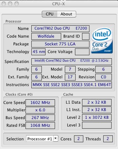

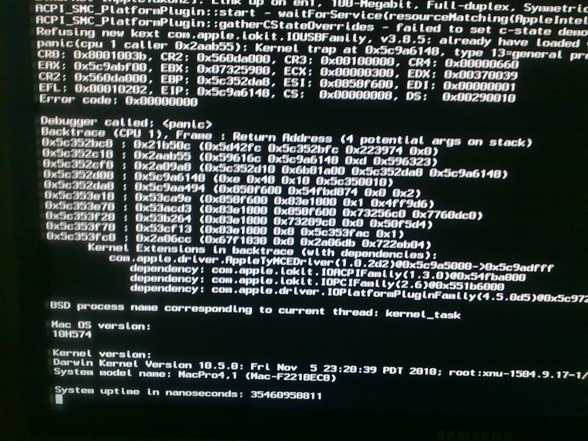

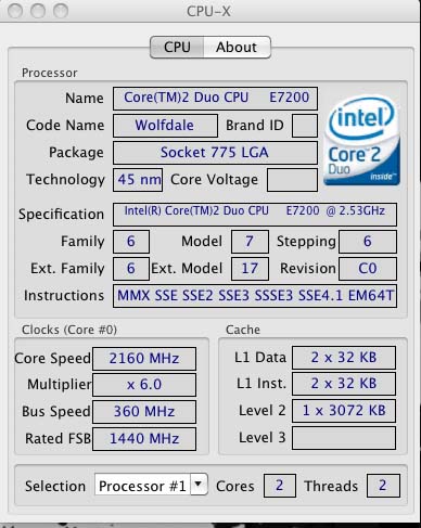

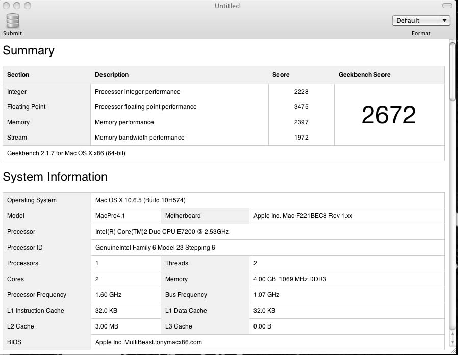

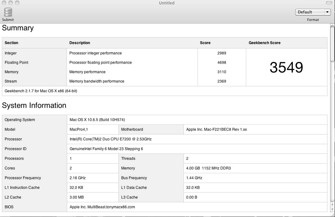

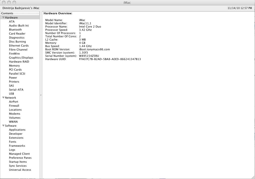

dimke_yu Posted November 14, 2010 Share Posted November 14, 2010 Ok here's the problem... I updated MAC OS X to 10.6.5 had little problems with usb but fixed them with [url="http://www.insanelymac.com/forum/topic/279450-why-insanelymac-does-not-support-tonymacx86/"]#####[/url]. My rig is ASUS P5K3 Deluxe, Intel E7200@3.43 GHz, 4GB Kingston DDR3 1333. Everything worked fine but i noticed with CPUX and in Geekbench that my CPU isnt recognized properly and in system profiler everything was correct but Geekbench score was too low about 3500. I attached pictures of sys profile and cpux. Then i wanted to fix this problem myself run [url="http://www.insanelymac.com/forum/topic/279450-why-insanelymac-does-not-support-tonymacx86/"]#####[/url] again and checked smbios.plist for iMac cus i have Intel Core 2 Duo everything went fine i restarted and after that when boot i got kernel panic everytime i turn on my computer... When i insert [url="http://www.insanelymac.com/forum/topic/279450-why-insanelymac-does-not-support-tonymacx86/"]#####[/url] for 10.6.5 i can boot my MAC OS and i am writing from there at the moment. Here are pics of verbose mode boot and error i get. If its important im runnig Chameleon V2.0 RC4_PCIEFI_10.5_AsereBLN. Quote Link to comment https://www.insanelymac.com/forum/topic/237110-iatkos-s3-intel-e7200-problem/ Share on other sites More sharing options...
dothacker Posted November 14, 2010 Share Posted November 14, 2010 i think you can delete the AppleTyMCEDriver.kext Quote Link to comment https://www.insanelymac.com/forum/topic/237110-iatkos-s3-intel-e7200-problem/#findComment-1583227 Share on other sites More sharing options...
dimke_yu Posted November 14, 2010 Author Share Posted November 14, 2010 Thanks for reply i did that and everything works... to only problem that remains is that cpux and geekbench see incorrect cpu speed... here is geekbench score Quote Link to comment https://www.insanelymac.com/forum/topic/237110-iatkos-s3-intel-e7200-problem/#findComment-1583295 Share on other sites More sharing options...
dothacker Posted November 14, 2010 Share Posted November 14, 2010 is your CPU overclocked? because E7200 is 2.53ghz, geekbench is right. if it's overclocked, well that's a different story. Quote Link to comment https://www.insanelymac.com/forum/topic/237110-iatkos-s3-intel-e7200-problem/#findComment-1583327 Share on other sites More sharing options...
dimke_yu Posted November 14, 2010 Author Share Posted November 14, 2010 Yes it is overclocked from stock speed to 3420 MHz... but i saw other ppl dont have this problem when they use overclocked CPU Quote Link to comment https://www.insanelymac.com/forum/topic/237110-iatkos-s3-intel-e7200-problem/#findComment-1583339 Share on other sites More sharing options...

dimke_yu Posted November 14, 2010 Author Share Posted November 14, 2010 Hmmmm ok i will try that but the main problem is that my cpu multiplier isnt detected correctly as you can see in cpux Quote Link to comment https://www.insanelymac.com/forum/topic/237110-iatkos-s3-intel-e7200-problem/#findComment-1583441 Share on other sites More sharing options...
dimke_yu Posted November 15, 2010 Author Share Posted November 15, 2010 Ok i searched the forum but all i saw was themes about chameleon and smbios.plist and everywhere ppl wrote that all changes are purely cosmetic... my problem isnt cosmetic as u can see in geekbench... i setted up my cpu to default setting in bios and situation is even worse than it was... As i said before problem is that geekbench and cpux read that my multiplier is 6 and its not it is 9.5 Quote Link to comment https://www.insanelymac.com/forum/topic/237110-iatkos-s3-intel-e7200-problem/#findComment-1583999 Share on other sites More sharing options...

dimke_yu Posted November 16, 2010 Author Share Posted November 16, 2010 Instaled CH 2.0 RC5 and stil same situation in geekbench and cpux i but in system profiler it says 3.43 GHz its realy confusing... but in both case when its not recognized properly it assumes that multi is 6 and its 9.5 Quote Link to comment https://www.insanelymac.com/forum/topic/237110-iatkos-s3-intel-e7200-problem/#findComment-1585267 Share on other sites More sharing options...

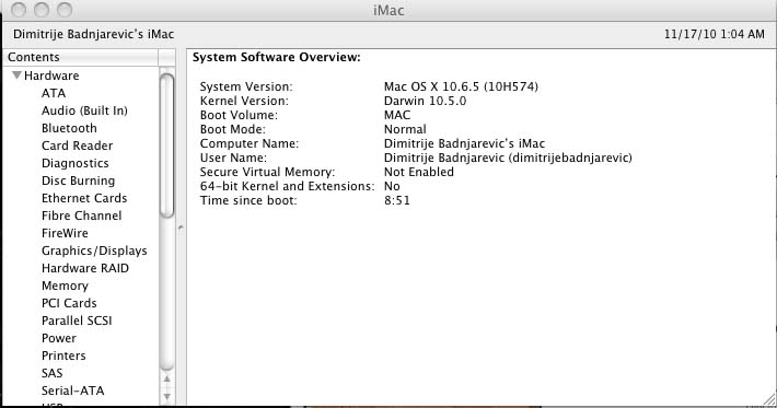

dimke_yu Posted November 17, 2010 Author Share Posted November 17, 2010 Heres pic from profiler... cus i dont know other way to see this... on 10.6.4 matter i didnt have geekbench and cpux but info in system profile was the same... the cpu speed is ok there Quote Link to comment https://www.insanelymac.com/forum/topic/237110-iatkos-s3-intel-e7200-problem/#findComment-1585305 Share on other sites More sharing options...
Dellmantt Posted November 17, 2010 Share Posted November 17, 2010 Heres pic from profiler... cus i dont know other way to see this... on 10.6.4 matter i didnt have geekbench and cpux but info in system profile was the same... the cpu speed is ok there For Kernel its uname -a in terminal. Without geekbench and cpux for 10.6.4 you can't compare to see if its 10.6.5 specific. Have a look in this searchhttp://www.google.com.au/search?hl=en&client=safari&rls=en-us&q=site%3Ainsanelymac.com+multiplier&aq=f&aqi=&aql=&oq=&gs_rfai= and this about FSB http://www.insanelymac.com/forum/lofiversi...t214528-50.html Quote Link to comment https://www.insanelymac.com/forum/topic/237110-iatkos-s3-intel-e7200-problem/#findComment-1585322 Share on other sites More sharing options...
