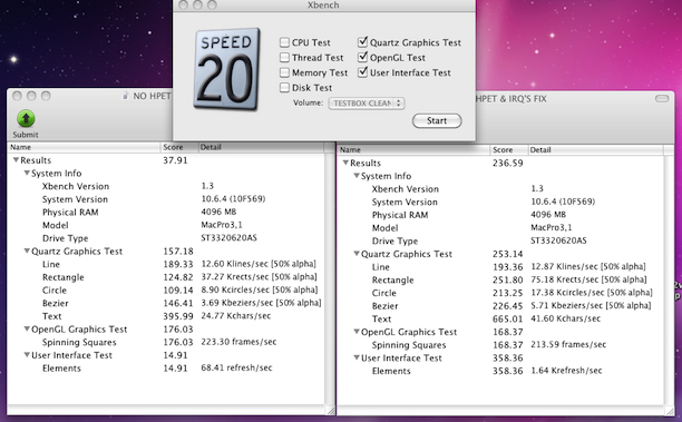

xavinoiz Posted November 11, 2010 Share Posted November 11, 2010 Hello guys, today i was doing some tests and noticed that my installation without a DSDT was showing very bad results under some XBench tests. After spending a lot of time trying to find which DSDT fix was resulting in such a great performance increase, i find its one of the most simple fixes one can do to his DSDT. Below are the results. In one i have added the IRQ's to HPET and removed IRQ's from PIC, RTC, TMR and COPR Devices. The other is when i dont use a DSDT or dont have this fixes on it. Posting this just out of curiosity, also i want to know if this fixes are THAT critical in ur systems too, performance-wise. Link to comment https://www.insanelymac.com/forum/topic/236765-dsdt-hpet-irqs-fixes/ Share on other sites More sharing options...
Hagar Posted November 11, 2010 Share Posted November 11, 2010 first try a different benchmark.. xbench is notoriously awful and generally considered meaningless. Link to comment https://www.insanelymac.com/forum/topic/236765-dsdt-hpet-irqs-fixes/#findComment-1580511 Share on other sites More sharing options...

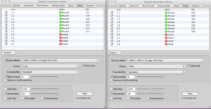

xavinoiz Posted November 11, 2010 Author Share Posted November 11, 2010 first try a different benchmark.. xbench is notoriously awful and generally considered meaningless. As u wish, heres the same test, different Benchmark: Edit: Resized img. Link to comment https://www.insanelymac.com/forum/topic/236765-dsdt-hpet-irqs-fixes/#findComment-1580536 Share on other sites More sharing options...
