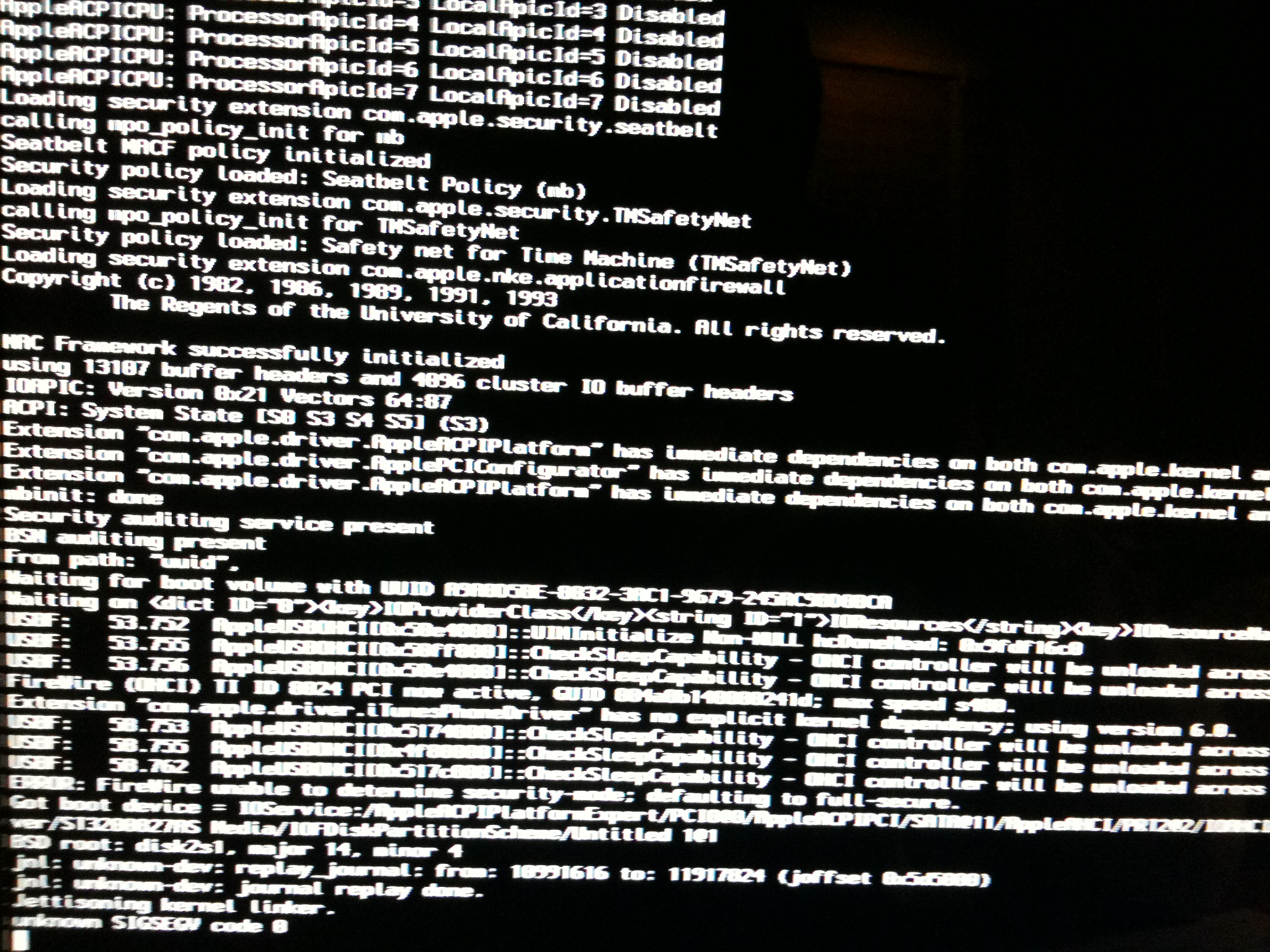

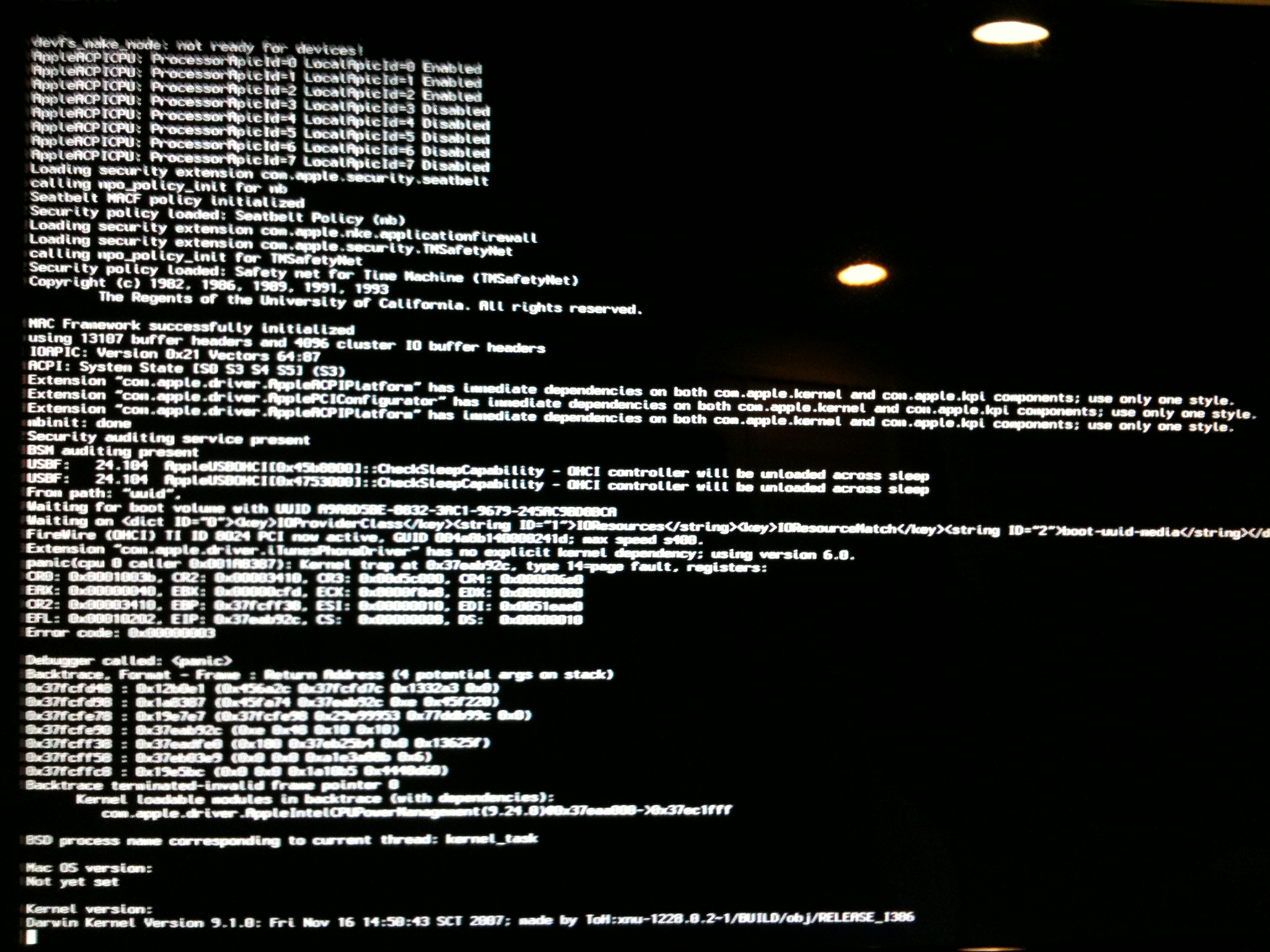

Kulocka Posted November 10, 2010 Author Share Posted November 10, 2010 ok it seems i have gotten a little further...but not exactly wut i wanted. i got iAtkos installed but its having trouble booting ...this is OS X Leopard not snow Leopard....i would love to get Snow on here but i think im gonna have to get Leopard then try to install snow from there this happens..there both the same screen but different pictures if theres trouble reading...this happens and then stops at the bottom there....idk wut to do plz help Quote Link to comment Share on other sites More sharing options...
Giorgio_multi Posted November 10, 2010 Share Posted November 10, 2010 Try to delete AppleIntelCPUPowerManagement.kext from /System/Library/Extensions (if you have windows on the PC with macdrive) Quote Link to comment Share on other sites More sharing options...

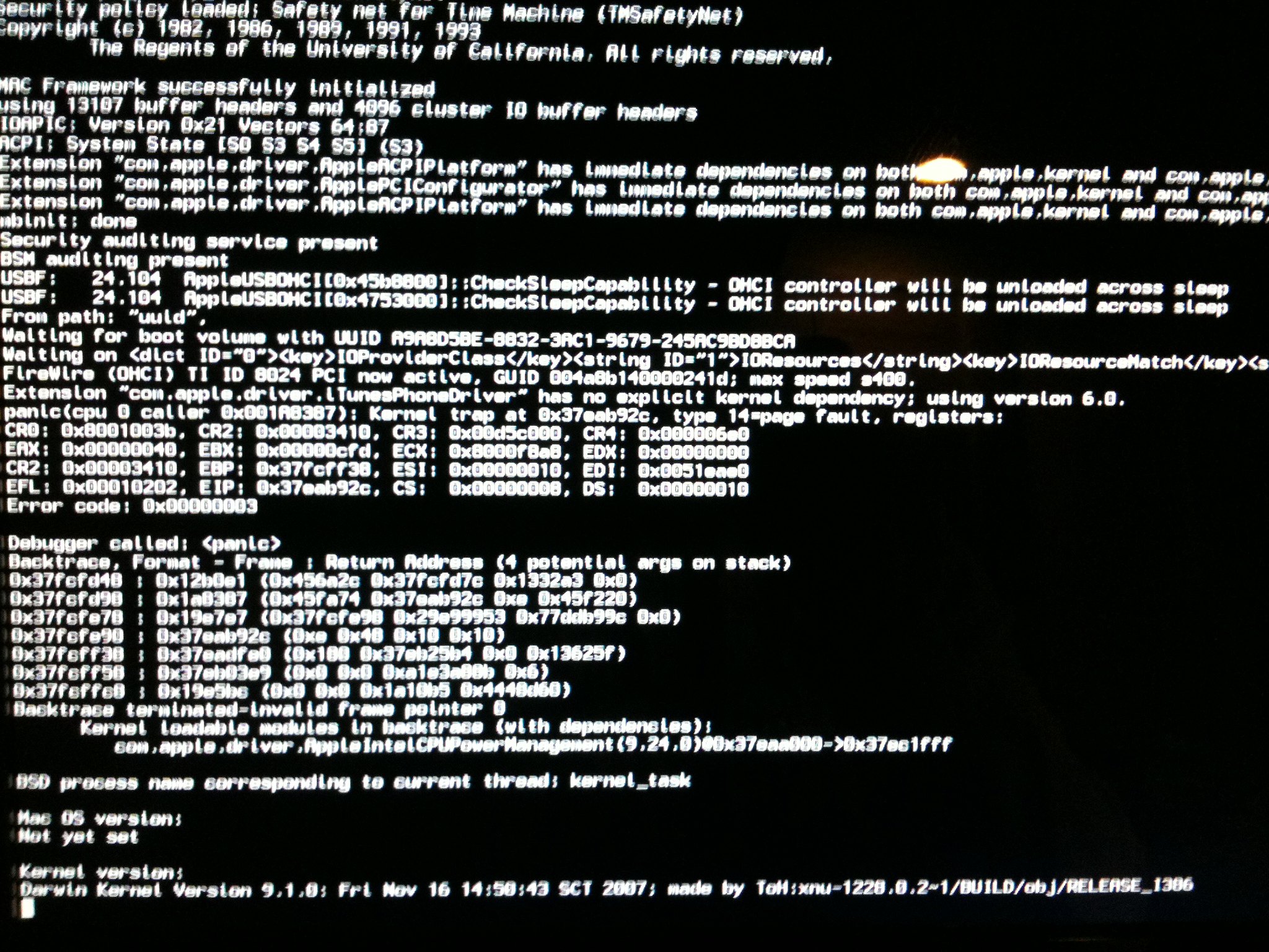

Kulocka Posted November 11, 2010 Author Share Posted November 11, 2010 thanx a lot, but it did not work completely it definitely changed something the picture will be below, if you can help me some more i would greatly appreciate it Quote Link to comment Share on other sites More sharing options...
Giorgio_multi Posted November 11, 2010 Share Posted November 11, 2010 Try to delete ATI5000controller.kext and ATIRadeonX3000.kext. If works, you must reinstall the drivers for ATI Graphics card (in graphics section there are many topics). Quote Link to comment Share on other sites More sharing options...

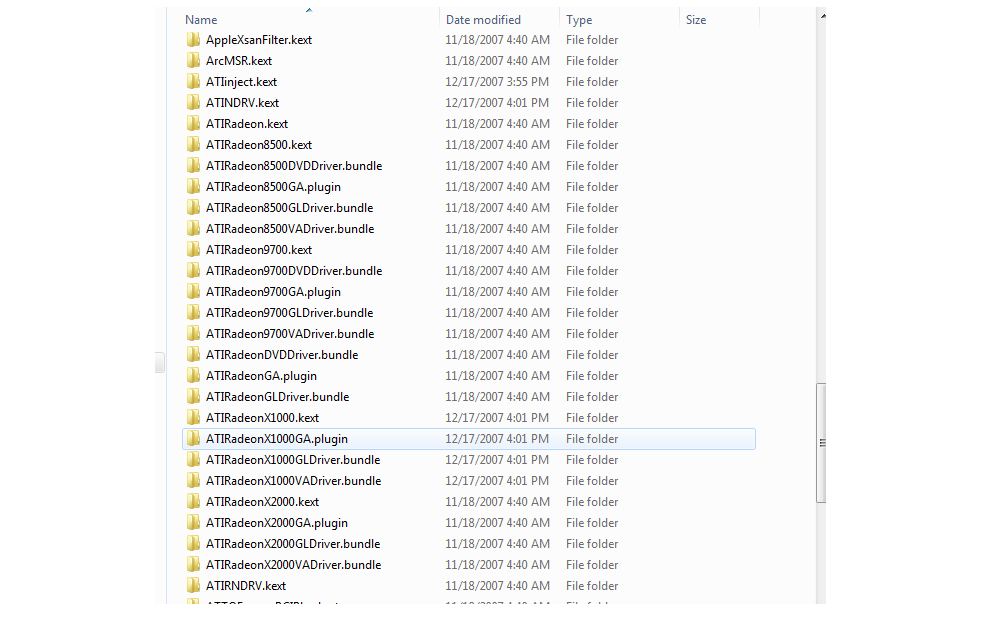

Kulocka Posted November 11, 2010 Author Share Posted November 11, 2010 i did not find the two kext you were telling me to delete, i did an entire search on the drive aswell. below is the picture from Extensions folder of what i do have....again thx a lot for helping me Quote Link to comment Share on other sites More sharing options...
Giorgio_multi Posted November 11, 2010 Share Posted November 11, 2010 This is an extremely common and well-known problem, I am surprised to see it suggested for use on this site. Transmac is generally preferred for simple usage. Transmac gives other problems ( in some systems sees the mac drives as read only, and others). There is not the perfect software, especially in cross-not supported-filesystems. I have helped many people, and I've never had problems with macdrive. Also gparted *still* eats partition tables sometimes, but is universal used. i did not find the two kext you were telling me to delete, i did an entire search on the drive aswell. below is the picture from Extensions folder of what i do have....again thx a lot for helping me Try to boot with -x flag Quote Link to comment Share on other sites More sharing options...

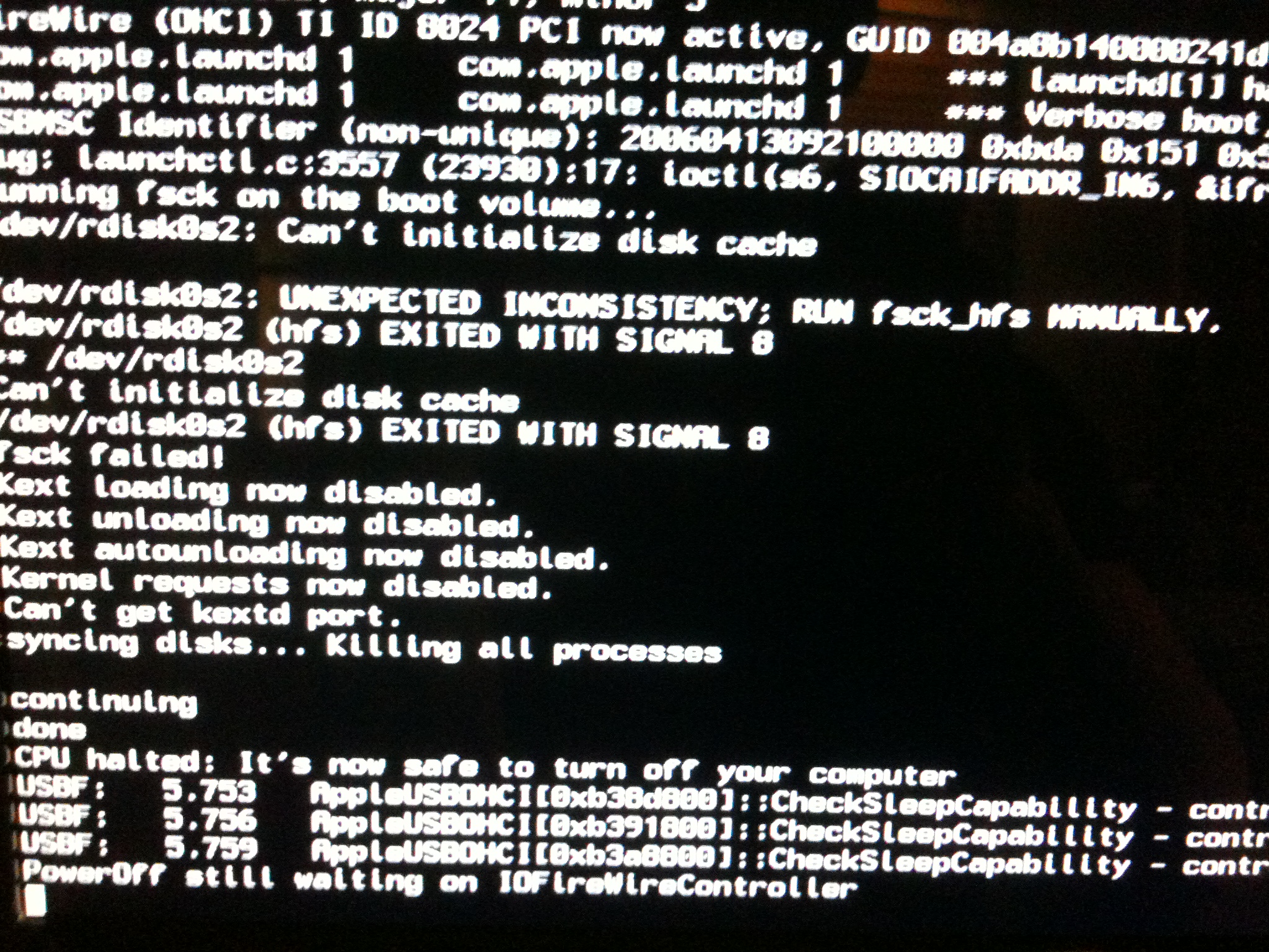

Kulocka Posted November 11, 2010 Author Share Posted November 11, 2010 Alright im real sorry to do this to you, but i now figured a way to install snow leopard, but its having some of the same issues, it will not boot, there are errors. If u can please help me with this one. This is the OS i was aiming for so i gave a try and i got it installed but it wont load. i followed the directions here and is booting up the the bootup cd they have posted. http://www.insanelymac.com/forum/lofiversi.../t227592-0.html but now im getting this error.... and ive been trying these guides but i do not have a /extra folder in the root of the drive...or anywhere Quote Link to comment Share on other sites More sharing options...
Giorgio_multi Posted November 11, 2010 Share Posted November 11, 2010 Is a problem of corruption of the HD. If you can format the HD and reinstall. Quote Link to comment Share on other sites More sharing options...
