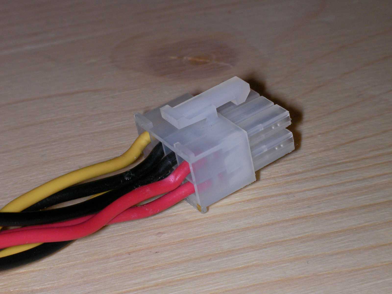

Buzze Posted October 28, 2010 Share Posted October 28, 2010 Hi, I attached a picture of my self-made cable. Colour code is as usual, 5V red, 12V yellow, GND black. Link to comment https://www.insanelymac.com/forum/topic/235115-g5-opticalhard-drive-power-cable/#findComment-1571539 Share on other sites More sharing options...
Gatorman Posted December 21, 2010 Author Share Posted December 21, 2010 Hey Buzze, What's the other side of that cable look like? Link to comment https://www.insanelymac.com/forum/topic/235115-g5-opticalhard-drive-power-cable/#findComment-1606641 Share on other sites More sharing options...
Buzze Posted December 22, 2010 Share Posted December 22, 2010 The other side of the cable is the connectors to my computer power supply, Enermax standard connectors. I made the complete wire from scratch. Link to comment https://www.insanelymac.com/forum/topic/235115-g5-opticalhard-drive-power-cable/#findComment-1606922 Share on other sites More sharing options...
