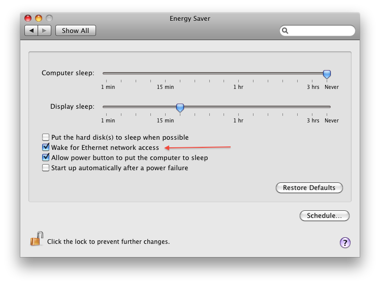

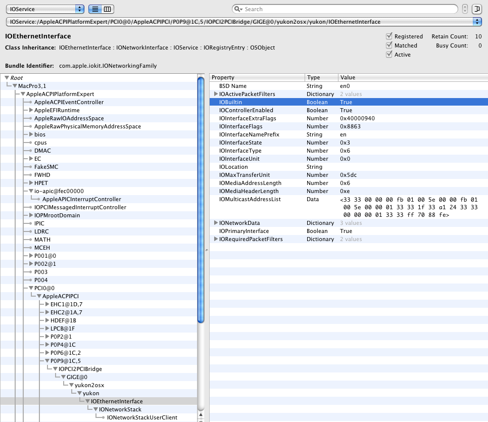

Gringo Vermelho Posted October 24, 2010 Share Posted October 24, 2010 Sleep and Shutdown are power states. You need working native power management to have WOL. Forget about Sleepenabler. Installing Chameleon is not enough, you have to configure it via /Extra/com.apple.Boot.plist as described in the release thread. http://www.insanelymac.com/forum/index.php?showtopic=225766 AppleLPC.kext and AppleHPET.kext must be loaded, you DSDT processor scope must be unmodified, etc etc: http://www.projectosx.com/forum/index.php?...ost&p=10065 Do you have this in Energy Saver prefs: Is your ethernet recognized by the OS as built-in? If not, set EthernetBuiltIn=y in /Extra/com.apple.Boot.plist. Link to comment https://www.insanelymac.com/forum/topic/234987-wake-on-lan-power-states-chameleon-ethernet-nic/#findComment-1569257 Share on other sites More sharing options...
