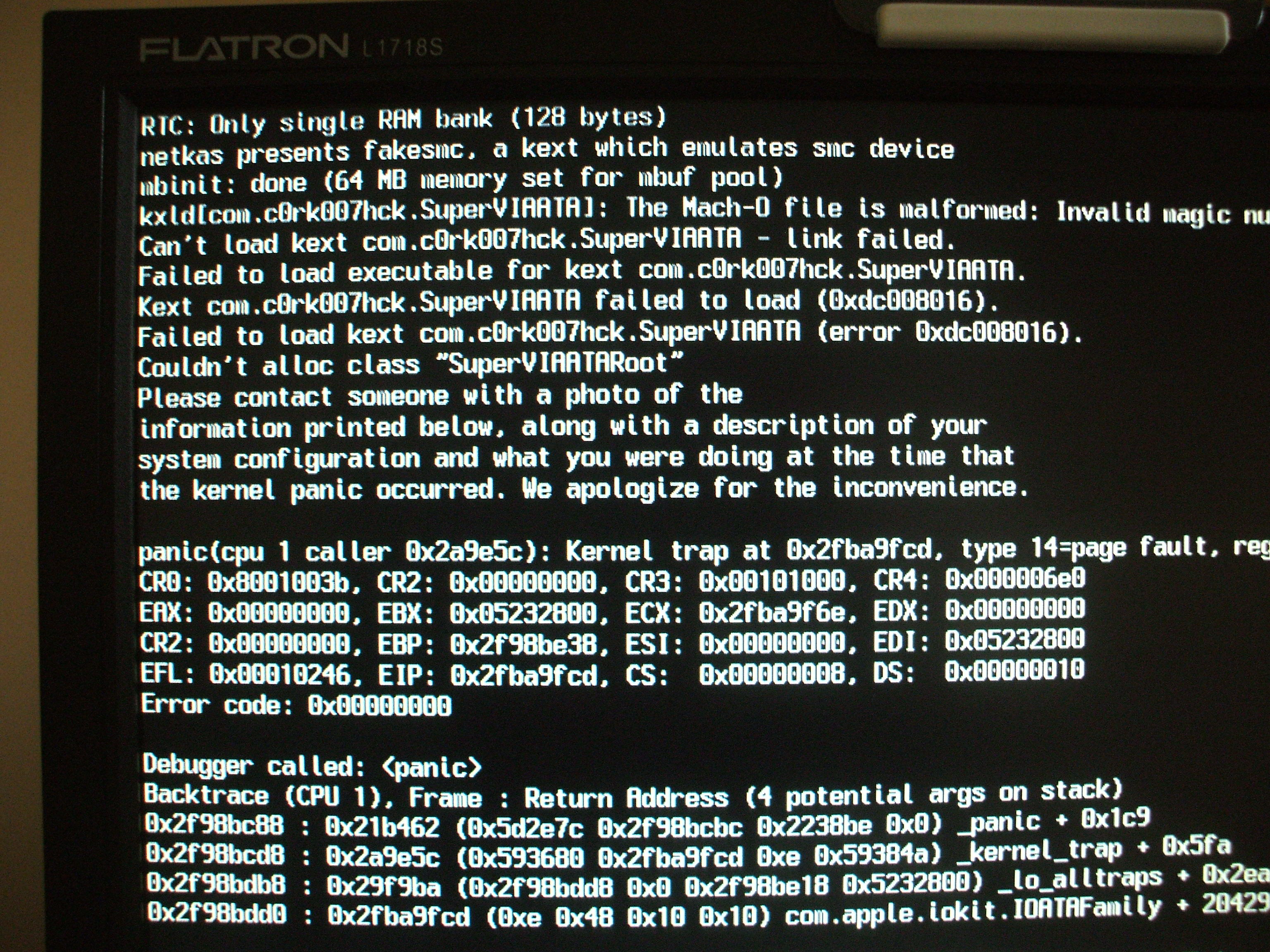

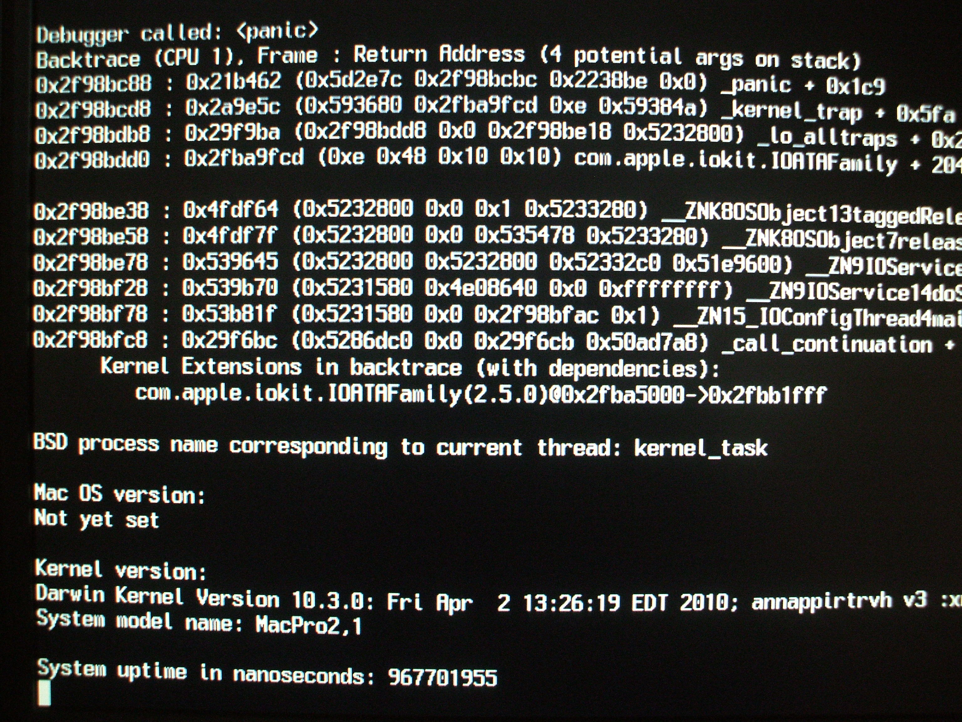

quake Posted October 16, 2010 Share Posted October 16, 2010 Hi, these are my specs,, MA78LM amd Athlon x2 ,,2gigs ddr2,,geforce 8500gt. I have tried Hazards 10.6.2 but keep getting this panic. I do have 10.5.8 on another partition so I can boot Leopard and manage files on the Snow volume if there are some kexts that have to be added or removed. The install finished but this is the panic on boot up. Link to comment https://www.insanelymac.com/forum/topic/234554-help-with-this-panic/ Share on other sites More sharing options...
quake Posted October 18, 2010 Author Share Posted October 18, 2010 Update,,What I did to fix this panic was booted into my Leopard partition,,inserted the Hazard install dvd and navigated through to the packages directory. I reinstalled the Superviaata package and also the IoataFamily package,,remembering to change the install location to my Snow Volume, rebooted, and Voila!! I'm not sure which one or if both of them solved the issue but whatever, it worked. After it booted, I installed my Ethernet, video, and sound kexts and all is well. I hope this helps others. Link to comment https://www.insanelymac.com/forum/topic/234554-help-with-this-panic/#findComment-1566360 Share on other sites More sharing options...
ilikecheese Posted October 27, 2010 Share Posted October 27, 2010 Update,,What I did to fix this panic was booted into my Leopard partition,,inserted the Hazard install dvd and navigated through to the packages directory. I reinstalled the Superviaata package and also the IoataFamily package,,remembering to change the install location to my Snow Volume, rebooted, and Voila!! I'm not sure which one or if both of them solved the issue but whatever, it worked. After it booted, I installed my Ethernet, video, and sound kexts and all is well. I hope this helps others. Quake i posted on another thread of yours and got my keyboard to work. Now I get the exact same problem above. I dont have another working os to reinstall packages. but i can access the drives when i boot to XP with with i think its called mactrans. Is reinstalling the kexts just a matter of moving files to folders or something else? Also i tried to just reinstall the whole thing with the IoataFamily option checked but I dont see a Superviaata option from the Hazard install disk. Would that be in the iAtkos s3 v2 disk? HEEELLPP!!!! LOL Link to comment https://www.insanelymac.com/forum/topic/234554-help-with-this-panic/#findComment-1571179 Share on other sites More sharing options...
