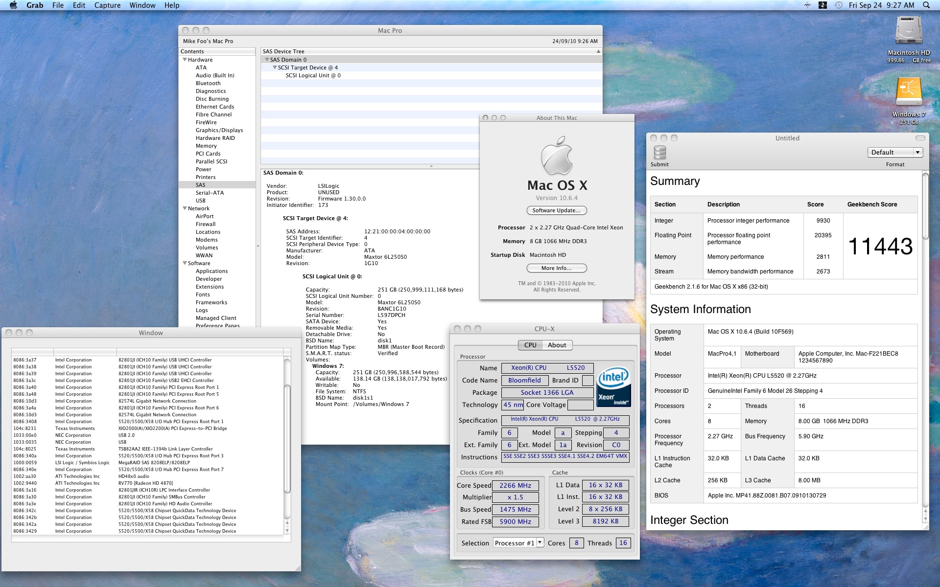

I already got an earlier machine working on X7DAL-E+ with dual Harpertowns for sometime now.
I'm currently working on the newer X8DAL-3 mobo. So far not too bad. Got it up working. Used Chameleon-2.0-RC5-r518. Still some items to work through.
I've got dual L5520 (low voltage) Nehalems installed and running. I had to boot into Ubuntu Live CD to grab the DSDT files first.
I had to edit AppleLSIFusionMPT.kext (pci1000,59) to get the onboard LSI 1068E SAS ports to work as regular SATA interfaces (also require firmware change to IT mode - provided by Supermicro). Can't boot from them ports though.
I also edited IONetworkingFamily.kext to get the two onboard Intel 82574L Gigabit Ethernet ports working.
I used IOAHCIBlockStorageInjector.kext to get rid of the orange icons so that the main harddrive (that's connected to the ICH10 interface) appears with the correct silver ones.
