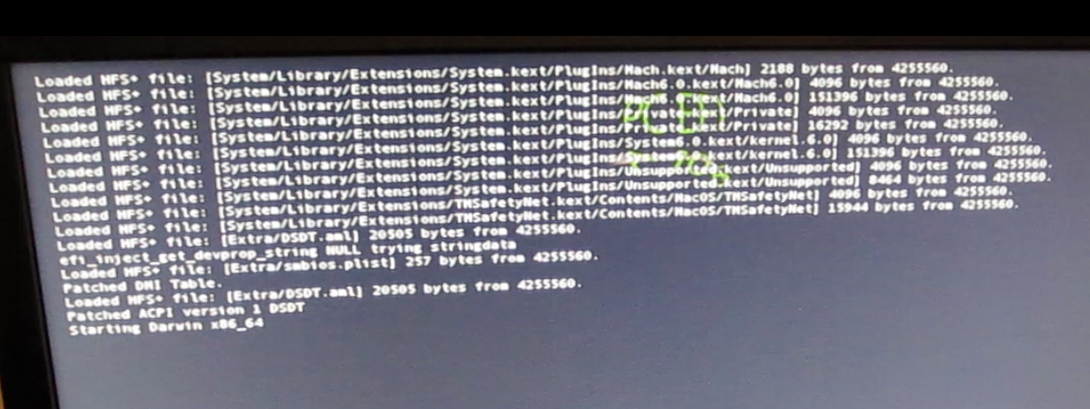

kubrik Posted August 28, 2010 Author Share Posted August 28, 2010 I tried following/adapting this tutorial on installing OS X via USB (it's a bit old, but I figure it should work), but again, I couldn't get my hackintosh to boot. Here are the exact steps I took: Installed Snow Leopard on my SSD from my MacBook Pro via my USB/SATA adapter using OSInstall.mpkg on my retail 10.6.0 disk image. Installed Chameleon 2.0 RC4 using the method described in the tutorial for installing to a USB thumb drive (though I installed directly to the SSD, as recommended). Replaced the "/boot" file with the PC EFI 10.6 version (the top file listed on netkas.org's "file server listing" page). Included the following kexts (in /Extra/Extensions.mkext; this is where I get pretty lost, because I'm not sure which, if any of them, I need): AHCIPortInjector.kext ATAPortInjector.kext Disabler.kext IOAHCIBlockStorageInjector.kext JMicronATAInjector.kext LegacyATI4800Controller.kext NullCPUPowerManagement.kext OpenHaltRestart.kext PlatformUUID.kext fakesmc.kext [*]Included a DSDT file (at /Extra/DSDT.aml) for my motherboard/bios, acquired from tonymacx86's DSDT database (DSDT-GA-P55A-UD3P-F13.aml). [*]Included a smbios.plist file (at /Extra/smbios.plist) with one key/value pair: "SMmemspeed" => "1333". As with the kexts, I don't know if this is sufficient or even necessary. [*]I did not include a com.apple.Boot.plist file, since I assume anything that goes there can simply be passed as arguments to the boot command, and the only flag passed in the guide is "-x32". It does mention something about an EFI string, which I'm unsure how to get. [*]I set the file ownership/permissions according to the guide. I connect my SSD via SATA to one of the Intel ports on my mobo. I am able to get into the PC EFI 10.6 bootloader screen, and I can see that my Snow Leopard install (on the same drive as the bootloader) is there. I pass the boot command "-x -v", and it starts loading kexts (including the ones I built into Extensions.mkext, telling me that I set permissions and filenames correctly). I get all the way to "Starting Darwin x86_64", after which the screen instantly goes black and my computer restarts (see attached screenshot). I'm hoping whatever I'm doing wrong is a stupid mistake with an easy fix. I just need someone to point it out for me! Thanks all. Quote Link to comment https://www.insanelymac.com/forum/topic/230309-help-installing-106-via-retail-discusb/#findComment-1538710 Share on other sites More sharing options...
Hangten Posted August 28, 2010 Share Posted August 28, 2010 DSDT.aml copy to root not EXTRA you need this com.apple.Boot.plist file its a must so your stuff works you need this: EXAMPLE ON my EVGA X58 <?xml version="1.0" encoding="UTF-8"?> <!DOCTYPE plist PUBLIC "-//Apple//DTD PLIST 1.0//EN" "http://www.apple.com/DTDs/PropertyList-1.0.dtd">'>http://www.apple.com/DTDs/PropertyList-1.0.dtd"> <plist version="1.0"> <dict> <key>Default Partition</key> <string>hd(0,2)</string> <key>Graphics Mode</key> <string>1920x1080x32</string> <key>GraphicsEnabler</key> <string>Yes</string> <key>Kernel</key> <string>mach_kernel</string> <key>Kernel Flags</key> <string>busratio=20</string> <key>Timeout</key> <string>2</string> </dict> </plist> *note: your busratio is different and I have an HD4850 so your card should work Safe with verbose mode looks like this: <?xml version="1.0" encoding="UTF-8"?> <!DOCTYPE plist PUBLIC "-//Apple//DTD PLIST 1.0//EN" "http://www.apple.com/DTDs/PropertyList-1.0.dtd"> <plist version="1.0"> <dict> <key>Default Partition</key> <string>hd(0,2)</string> <key>Graphics Mode</key> <string>1920x1080x32</string> <key>GraphicsEnabler</key> <string>Yes</string> <key>Kernel</key> <string>mach_kernel</string> <key>Kernel Flags</key> <string>busratio=20 -v -x</string> <key>Timeout</key> <string>2</string> </dict> </plist> Quote Link to comment https://www.insanelymac.com/forum/topic/230309-help-installing-106-via-retail-discusb/#findComment-1538784 Share on other sites More sharing options...

kubrik Posted August 30, 2010 Author Share Posted August 30, 2010 I've gotten a long way toward getting my system working. It turns out all I had to do to get past the kernel startup problem was apply the 10.6.4 combo update, since the i7-860 wasn't a supported processor when 10.6.0 came out. I'm still getting stuck at the boot process, this time after starting the kernel. I'm getting some errors related to my graphics card (most recently, a kernel panic when it tries to load the vanilla ATI X2000 kext). I've tried using GraphicsEnabler and legacy ATI4800Controller kext, but no luck yet. ...I have an HD4850 so your card should work What is your kext setup? I ended up doing a manual Chameleon install (as opposed to using [url="http://www.insanelymac.com/forum/topic/279450-why-insanelymac-does-not-support-tonymacx86/"]#####[/url] or another installer), so I'm just kind of fishing around for kext info now. Quote Link to comment https://www.insanelymac.com/forum/topic/230309-help-installing-106-via-retail-discusb/#findComment-1540052 Share on other sites More sharing options...
kubrik Posted August 30, 2010 Author Share Posted August 30, 2010 Nevermind! I'm up and running with 10.6.4 (albeit without LAN or sound). In the end, I was just overthinking things, I guess... This is all I had to do: 1. Intall Snow Leopard directly to my hackintosh boot drive from the 10.6 retail disc image (via USB from my other Mac). 2. Run the 10.6.4 combo update. 3. Run [url="http://www.insanelymac.com/forum/topic/279450-why-insanelymac-does-not-support-tonymacx86/"]#####[/url] with the UserDSDT option and DSDT.aml for my mobo (thanks to tonymacx86). 4. Boot, and, miraculously, it works. If you're curious, here are the contents of com.apple.Boot.plist that got it working for me: <?xml version="1.0" encoding="UTF-8"?> <!DOCTYPE plist PUBLIC "-//Apple//DTD PLIST 1.0//EN" "http://www.apple.com/DTDs/PropertyList-1.0.dtd"> <plist version="1.0"> <dict> <key>Kernel</key> <string>mach_kernel</string> <key>Kernel Flags</key> <string>arch=i386</string> <key>GraphicsEnabler</key> <string>Yes</string> <key>Timeout</key> <string>1</string> <key>Legacy Logo</key> <string>Yes</string> <key>EthernetBuiltIn</key> <string>Yes</string> </dict> </plist> Thanks again for the help, and if you have any tips on networking or sound I'd be glad to hear them, although I can probably get it working with some more effort. Quote Link to comment https://www.insanelymac.com/forum/topic/230309-help-installing-106-via-retail-discusb/#findComment-1540085 Share on other sites More sharing options...
