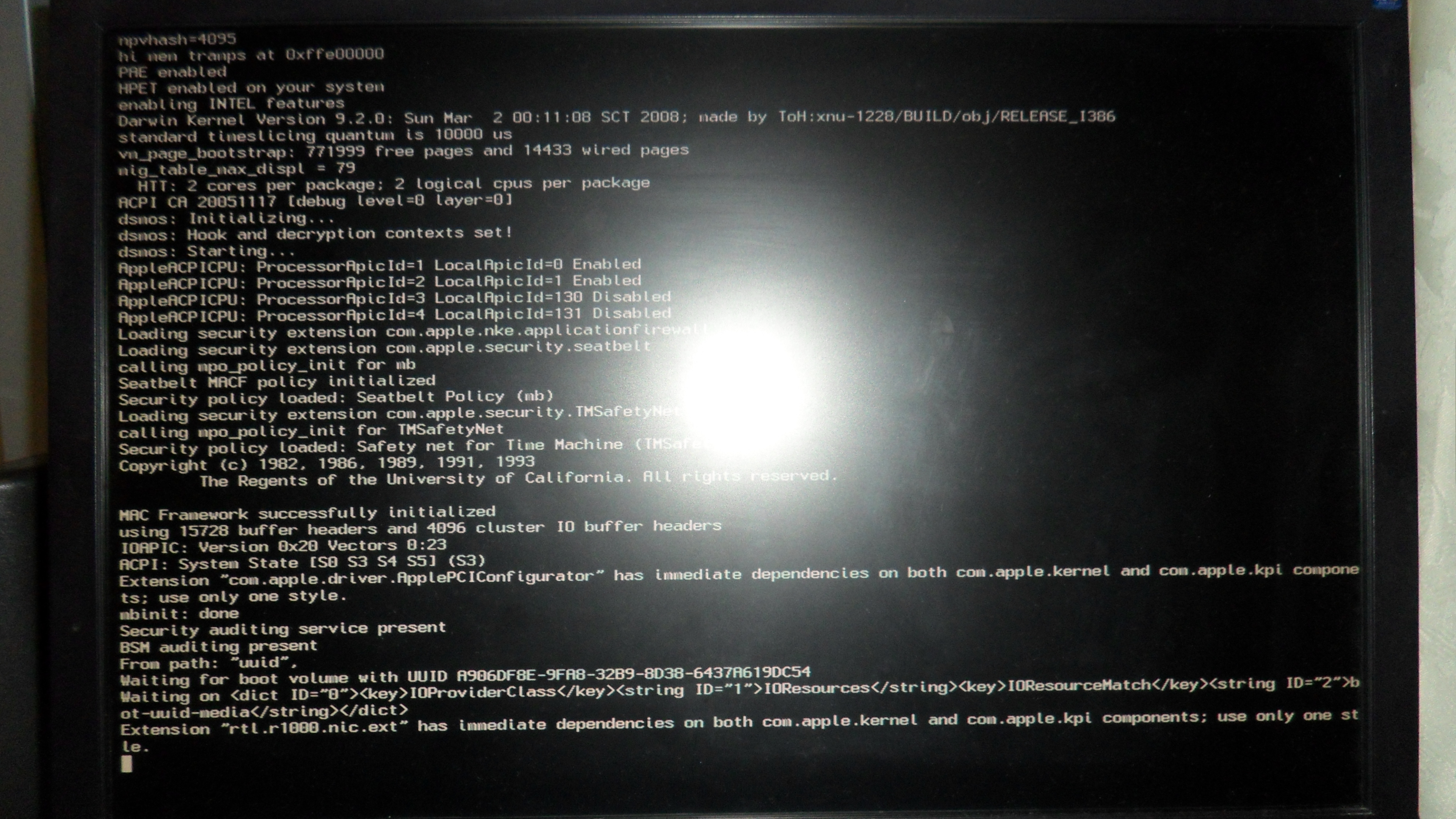

Maximus1001 Posted August 24, 2010 Share Posted August 24, 2010 Wont' even begin to install. Got this screenshot from attempting to boot from disc with the -v argument... OSX Snow Leopard BTW. Has anyone else had this problem? Quote Link to comment https://www.insanelymac.com/forum/topic/229857-problem-while-installing-osx86-leopard/ Share on other sites More sharing options...
Gringo Vermelho Posted August 28, 2010 Share Posted August 28, 2010 In the BIOS, enable ACPI 2.0 and ACPI APIC. Enable all CPU features except CPUID Limit. If it still does the same thing, try disabling on-board LAN. The last message is from a Realtek driver. You can enable it later and fix things post-install. If you leave it there and there's a message saying "Still Waiting for Root Device", set your SATA controller to AHCI mode. If it doesn't work after doing that, make sure your hard drive is connected to the primary drive controller of the South Bridge on your motherboard, rather than an off-chip Marvell or JMicron controller. If you're unsure which ports belong to which controller, look in your motherboard manual. If it still doesn't work, try another distro. Also, for the love of god post specs when asking for help, and don't use the camera flash when photographing a reflective surface!! Use an indirect light source. Quote Link to comment https://www.insanelymac.com/forum/topic/229857-problem-while-installing-osx86-leopard/#findComment-1538713 Share on other sites More sharing options...
