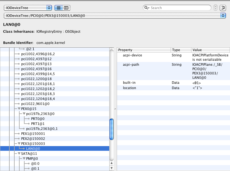

sirbow2 Posted July 22, 2010 Author Share Posted July 22, 2010 well im waiting for tonymacosx86 to say something, he should be receiving his mobo w/ alc892 soon. on to another dsdt question. i used this code form one of master chief's dsdt for lan, im assuming that i need to edit it for lan to work with my setup: Device (LAN0) { Name (_ADR, 0x00) Name (_PRW, Package (0x02) { 0x09, 0x03 }) Method (_DSM, 4, NotSerialized) { Store (Package (0x04) { "built-in", Buffer (One) { 0x01 }, "location", Buffer (0x02) { "1" } }, Local0) MCDP (Arg2, RefOf (Local0)) Return (Local0) } } Method (_PRT, 0, NotSerialized) { If (LNot (PICF)) { Return (PIC3) } Else { Return (API3) } } } i put it in Pex3 in my dsdt, which is pci-e, i think? i now have Ev0reboot, nullcpu, networking kext and fakesmc in my /E/E i think i can get rid of Ev0reboot by doing something in my dsdt. is thier a way to automatical mount my efi partiton whenn osx starts, its really annoying having to open terminal every time for these commands: sudo mount_hfs /dev/disk0s1 /Volumes/EFI mkdir /Volumes/EFI its pretty amazing i have been able to fix ever error so far in modding my dsdt since your _WAK error help!!! dsdt.aml.zip Link to comment https://www.insanelymac.com/forum/topic/225659-dsdt-compile-warnings-help/page/2/#findComment-1516675 Share on other sites More sharing options...

sirbow2 Posted July 23, 2010 Author Share Posted July 23, 2010 FIRST i had LAN0 injected in the DSDT at PEX3, and the etherent0(the device in ioreg created by the kext drivers) was at PCEA, LAN0 showed in ioreg as LAN0 under PEX3 but no info such as vendor id etc SECOND i moved LAN0 from PEX3 to PECA in the DSDT, in ioreg ethernet0 didnt show in PCEA, instead LAN0 did, ethernet still worked like this but the kexts were still in place in /E/E THIRD i removed the ethernet kexts from /E/E, when the ethernet kexts werent in /E/E LAN0 still showed in ioreg, with all teh ethernet info but ethernet didnt work io-reg-explorer ethernet.zip attachment shows ethernet0 in ioreg in FIRST LAN0.png attachment shows LANO in FIRST LAN0 w/ kext.zip attachment shows SECOND lan0 no kext.zip attachment shows THIRD hope this makes sense if not ask!! NOTE: it shows up in network tab in sysprefs but it says cable unplugged, after looking up "cable unplugged" i found that it was because the ethernet card wasn't receiving power which is why i get the cable unplugged error, a device not getting power sounds like something that could be fixed in the DSDT ioregistryexplorer_ethernet.zip lan_0_no_kext.zip LAN0_w__kext.zip Link to comment https://www.insanelymac.com/forum/topic/225659-dsdt-compile-warnings-help/page/2/#findComment-1516743 Share on other sites More sharing options...
