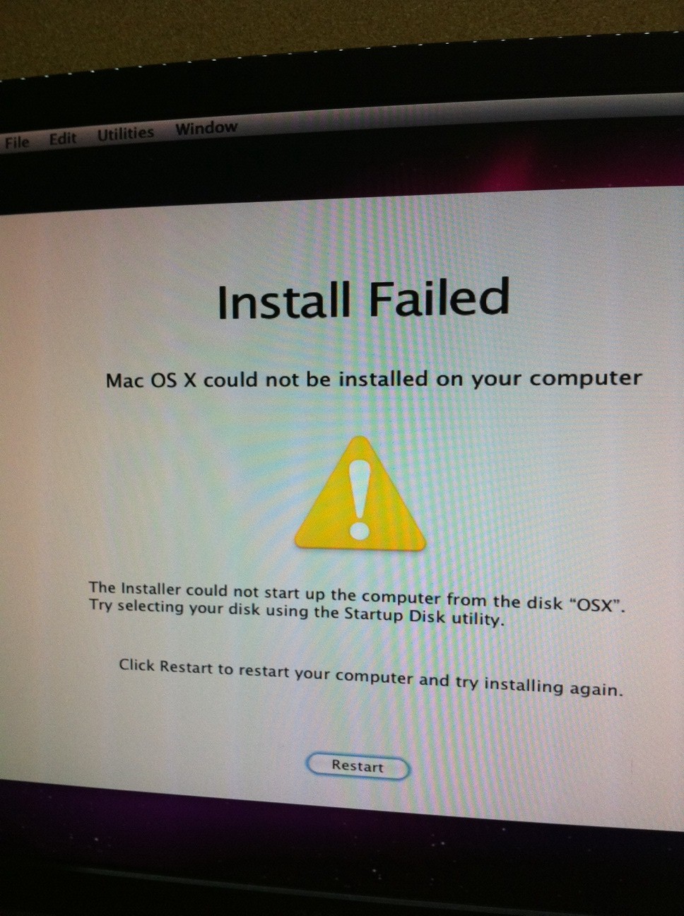

Spingjp Posted July 17, 2010 Author Share Posted July 17, 2010 yes i am using empire EFI 1.085r2 when i partition the hdd and select guid partition it give me like a estimated 20 min to install when install is complete i get this warning saying Install failed, mac osx could not be installed on your computer. The installer could not start up the computer from the dsik. I read on this fourm and others saying that error is false and it still installs.the thing i do is reboot the pc after the install failed error and then i put the efi disc in and select the hdd which it is installed.. then i get the error cpu halted and the pc reboots by it self... i will try your way when it says restart eject the disc and put the efi in and boot that way.. i will try it around sunday or monday i will keep you posted Link to comment Share on other sites More sharing options...
penguingt Posted July 17, 2010 Share Posted July 17, 2010 yes i am using empire EFI 1.085r2 when i partition the hdd and select guid partition it give me like a estimated 20 min to install when install is complete i get this warning saying Install failed, mac osx could not be installed on your computer. The installer could not start up the computer from the dsik. I read on this fourm and others saying that error is false and it still installs.the thing i do is reboot the pc after the install failed error and then i put the efi disc in and select the hdd which it is installed.. then i get the error cpu halted and the pc reboots by it self... i will try your way when it says restart eject the disc and put the efi in and boot that way.. i will try it around sunday or monday i will keep you posted After the install OS X partition (or drive) still can't boot by itself until you install the "My hack" from the cd...so yes once the install is complete, restart with 1.085r2 disc, install the "my hack" on the OS X partition (or drive)once loaded and then you should be able to boot. Once you boot off the empire efi disc, you should see your new partition (or disc) in the list of drives and should be able to load OS X from there. If you select the OS X partition (or drive) and it still does the same thing then I don't know. Try reformating and installing again? Or perhaps a seperate hard drive for OS X? Mine didn't give me any errors on the install. You have the Dell bios set up as per empire efi page (AHCI and all that?). Do you know what bios # your machine is? Mine is A15. Let us know how it goes. Sorry not more help. Link to comment Share on other sites More sharing options...
