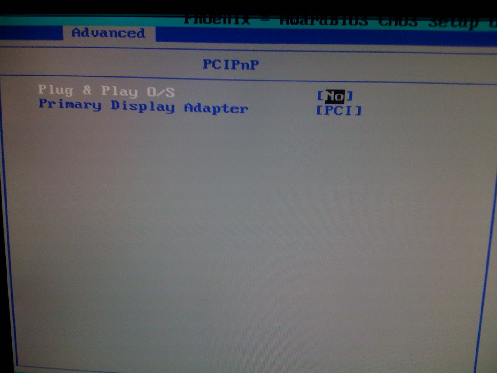

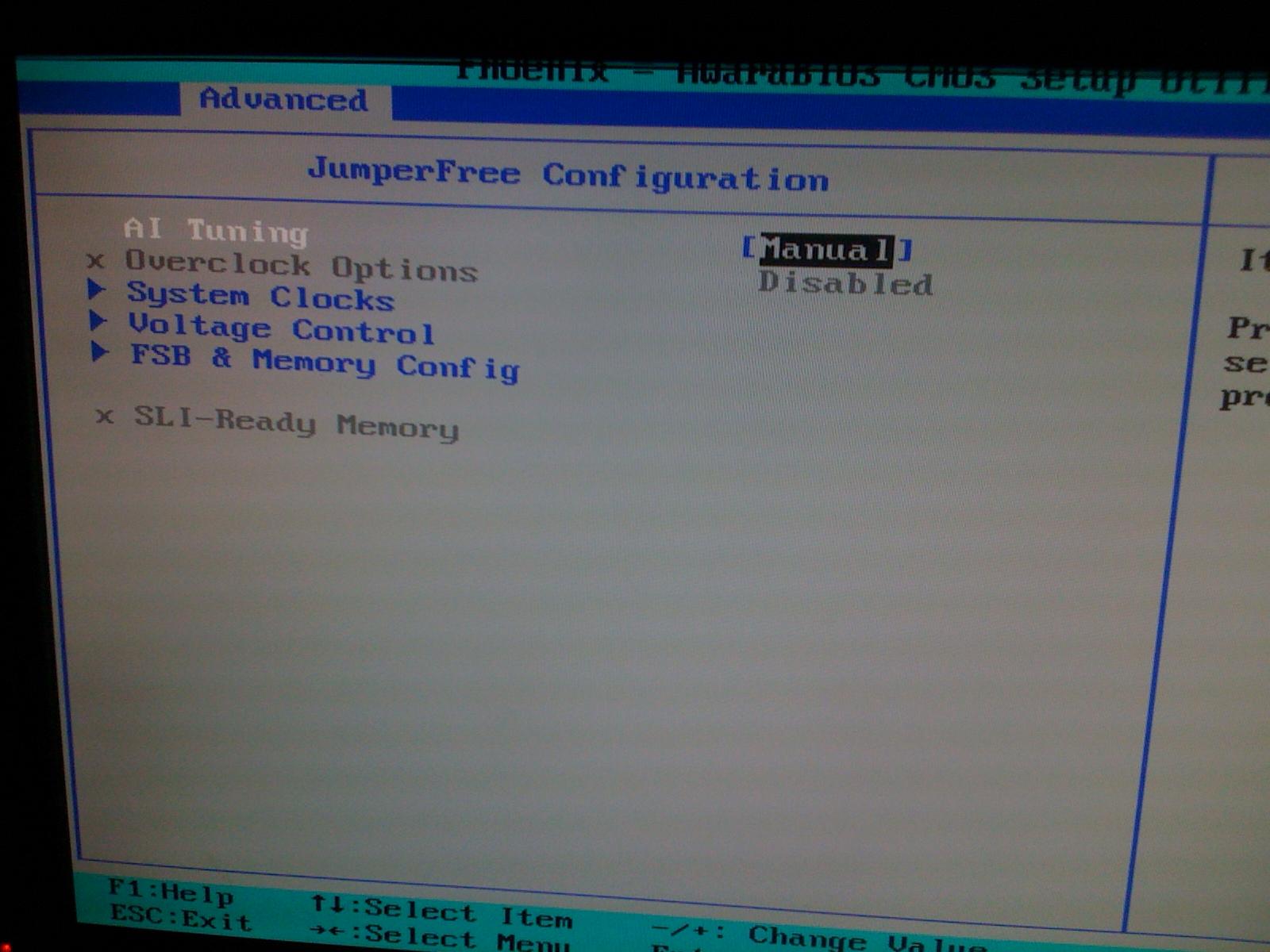

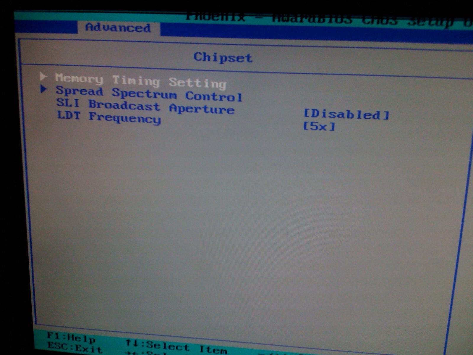

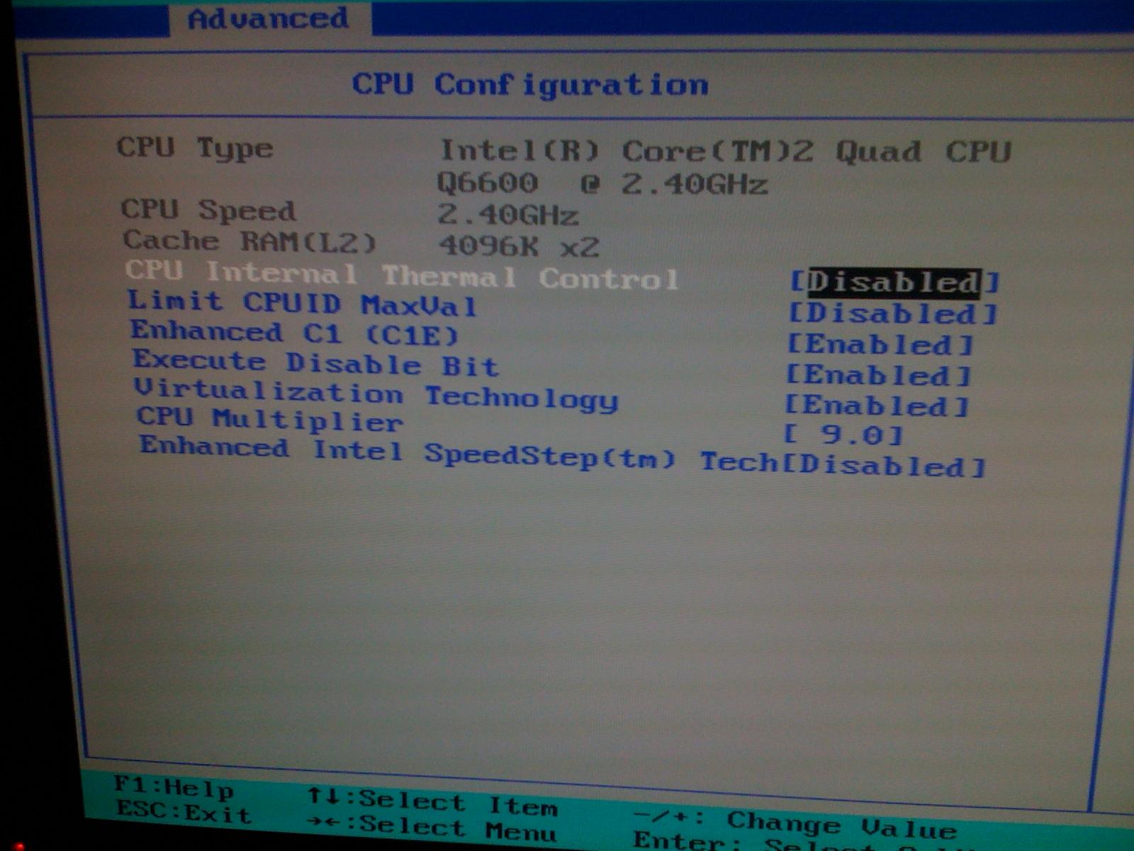

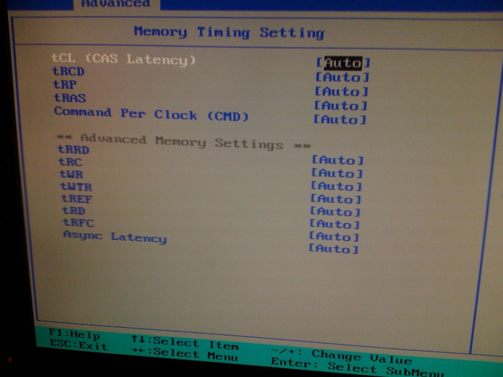

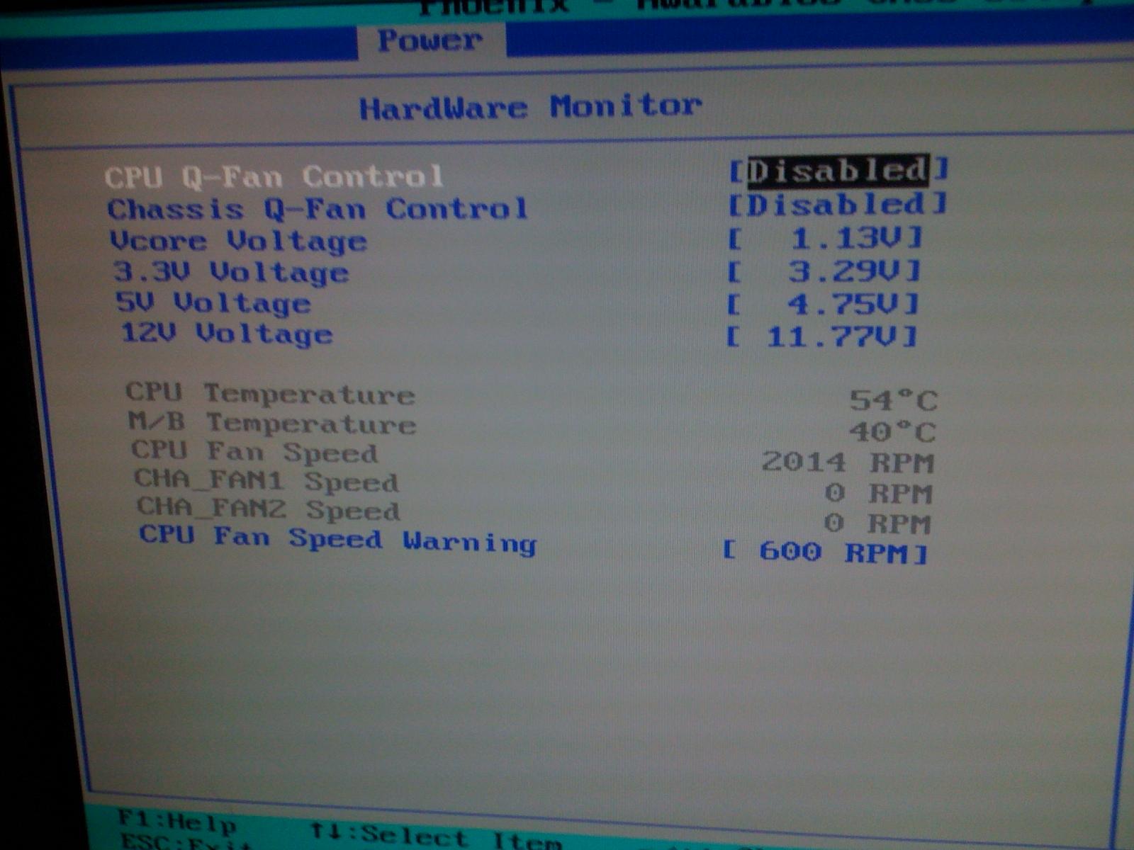

Your BIOS settings are not correct!.........
Download my BIOS settings template in Part B. here and use the settings for 650i............

I followed your guide and verdant's template for the bios settings and it worked for ALL except the wake up feature. It went to sleep and never wake up. Did you get it fixed somehow? Thank you very much!
