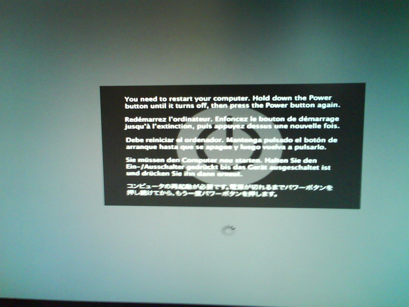

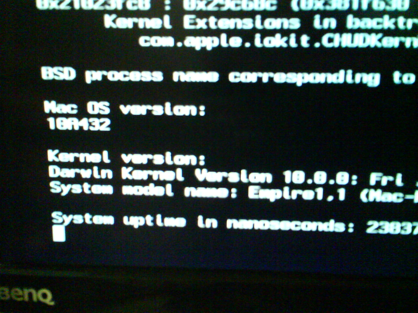

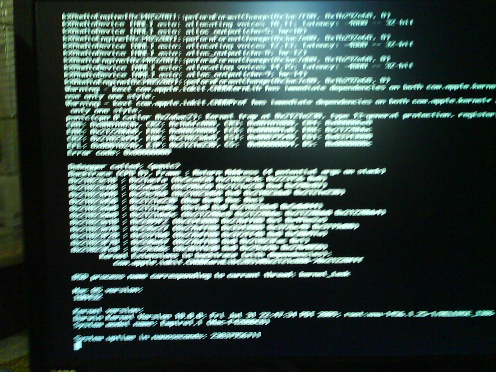

ZokkeR Posted July 7, 2010 Share Posted July 7, 2010 Hey guys, I was finally able to install and boot without -x flags the Snow Leopard Retail DvD. So, I tried this time the mach_Kernel_test7 Kernel and it obviosly worked, SL booted fast and without any flags, Sound was there (Creative Audigy) and my resoltution (ATI HD4850) worked with tons on .dmg files. So, I was on my desktop and decided to install Xcode, well, while it installed, I decided to load iTunes and Skype, I putted Skype into Applications and surfed a little bit. But after the Skype thing (or Xcode finished, idk) I got a screen with a power button sign and it said, that I should hold the power button until my PC shut down and reboot. I did it, same result. So I tried Efi with Verbose mode, it says that there is a kernel panic but why? I thought mach_Kernel_test7 worked?! So, here are the images: Please, I need help! =( Link to comment https://www.insanelymac.com/forum/topic/224219-kernel-panic-after-xcode-installation/ Share on other sites More sharing options...
MaLd0n Posted July 7, 2010 Share Posted July 7, 2010 the problem is here --> CHUDKernLib.kext I do not know if deleting this kext will solve the problem try with -s mount -uw / rm -rf /system/library/extensions/CHUDKernLib.kext exit if you are unable to access the single user use the installation DVD(terminal) delete kext cd /Volumes/YOUR-VOLUME-NAME/System/Library/Extensions rm -rf CHUDKernLib.kext move kext mv /Volumes/PARTITION NAME/System/Library/Extensions/CHUDKernLib.kext /Volumes/PARTITION NAME/FOLDER Link to comment https://www.insanelymac.com/forum/topic/224219-kernel-panic-after-xcode-installation/#findComment-1506636 Share on other sites More sharing options...
