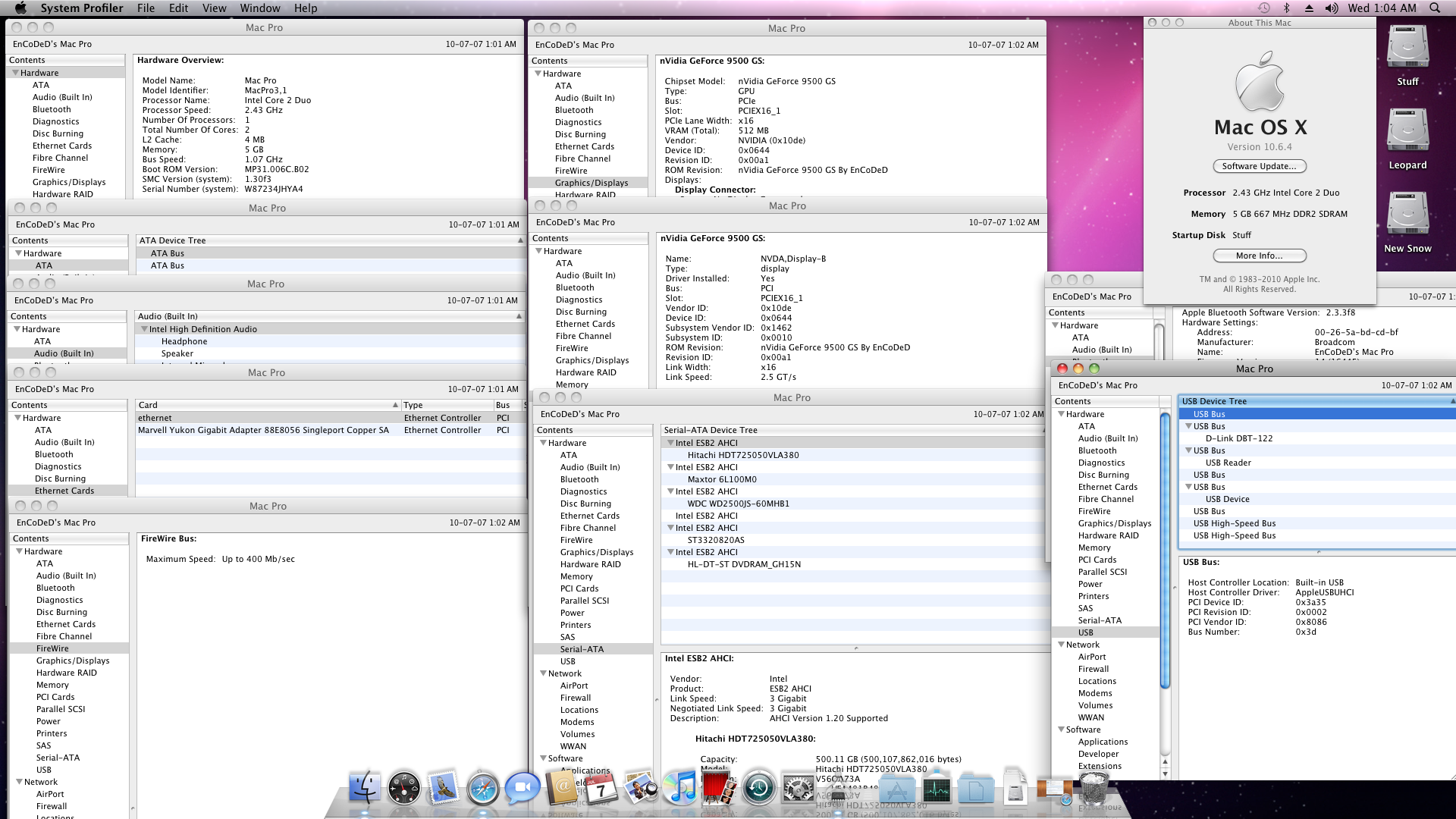

Well it's been a long time now since I posted last here and I just thought that I would share with you my new install.
I have Snow Leopard 10.6.4 Installed and working on my Asus Blitz Formula Special Edition.
Blitz Formula SE
Intel Core 2 Duo E6600 2.43GHz
5 Gb of ram
nVidia Geforce 9500GS 512meg
D-Link DBT-122 Bluetooth USB
HL-DT-ST DVDRAM_GH15N SATA
Marvell Yukon Gigabit Adapter 88E8056
Marvell 88E8081 Ethernet
Hitachi HDT725050VLA380
Maxtor 6L100M0
WDC WD2500JS-60MHB1
ST3320820AS
Apple Bluetooth Keyboard, and mighty mouse
Restart, shutdown both work! (sleep not used/tested)
I have taken a new screen shot of my updated setup...
Everything works for my right now but I would like to tweak the DSDT file to add the sound (ad1988b), GFX (nvidia 9500GS 512), SATA and USB fixes. But for now everything is working. No need to fix what isn't broken.

EDIT: Well I have messed with the DSDT now and got everything working like I wanted too.
I have my DSDT.aml file, com.apple.boot.plist, smbios.plist and my Extentions.mkext file with only 6 kext files..
FakeSMC
AD1988Bfix
OSXRestart
EvOreboot
IONetworkingFamily (for Marvel Yukon 80e8056)
Skge (only if I turn on the 2nd network adapter)
EDIT #2: Well after a few days of testing I now have my Extensions down to 4 Kexts only!
FakeSMC 2.5
AD1988BFix
EvOReboot
IONetworkingFamily (has driver for Marvel 80E8056 (Yukon2) and skge for Marvel 80E8001)
same DSDT.aml and boot.plist as before
Still haven't tested Sleep yet (still not needed) but since I think I have it running as good as I can right now I will start to test things out. Will keep you posted
DSDT.aml had these fixes added:
Added GFX0 under P0P2 device to give me full resolution and QE/CI on my Geforce 9500 GS (no need for any Nvidia injectors or anything in com.apple.boot.plist)
Added USB fix to have all USB port show as internal
Added SATA fix, all HDD show up as internal(not Orange) and all SATA port listed show as ESB2 just like a Mac Pro (no need for the IOAHCIBlockStarage or AHCIPortInjector files)
Added RTC0, TMR, and HEPT fixes, (no need for NullCPUPowerManagement or AppleRTC)
