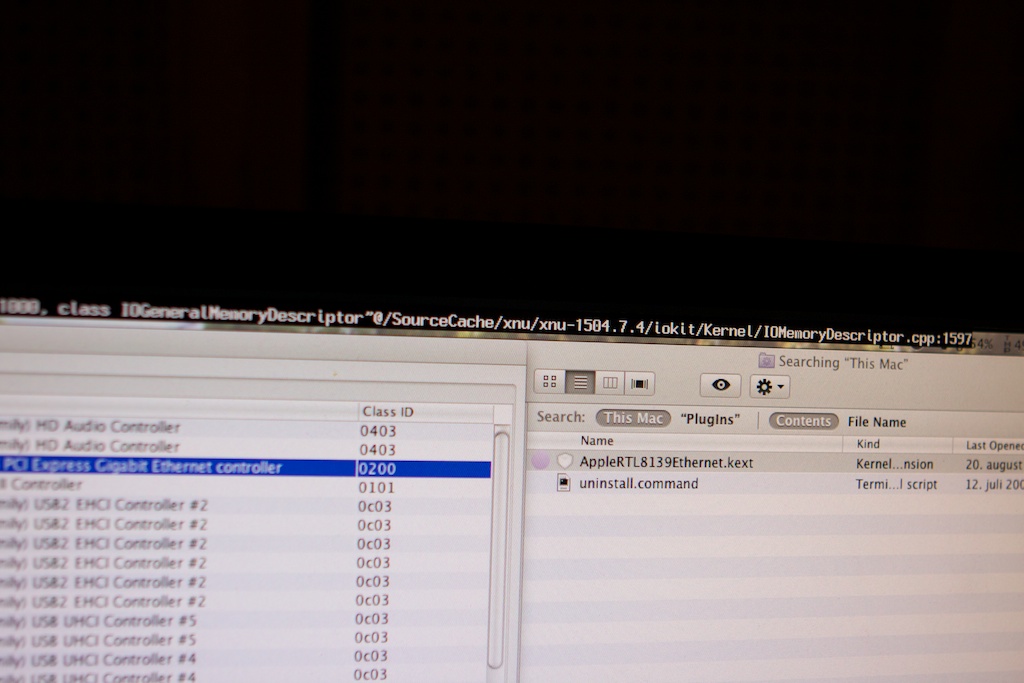

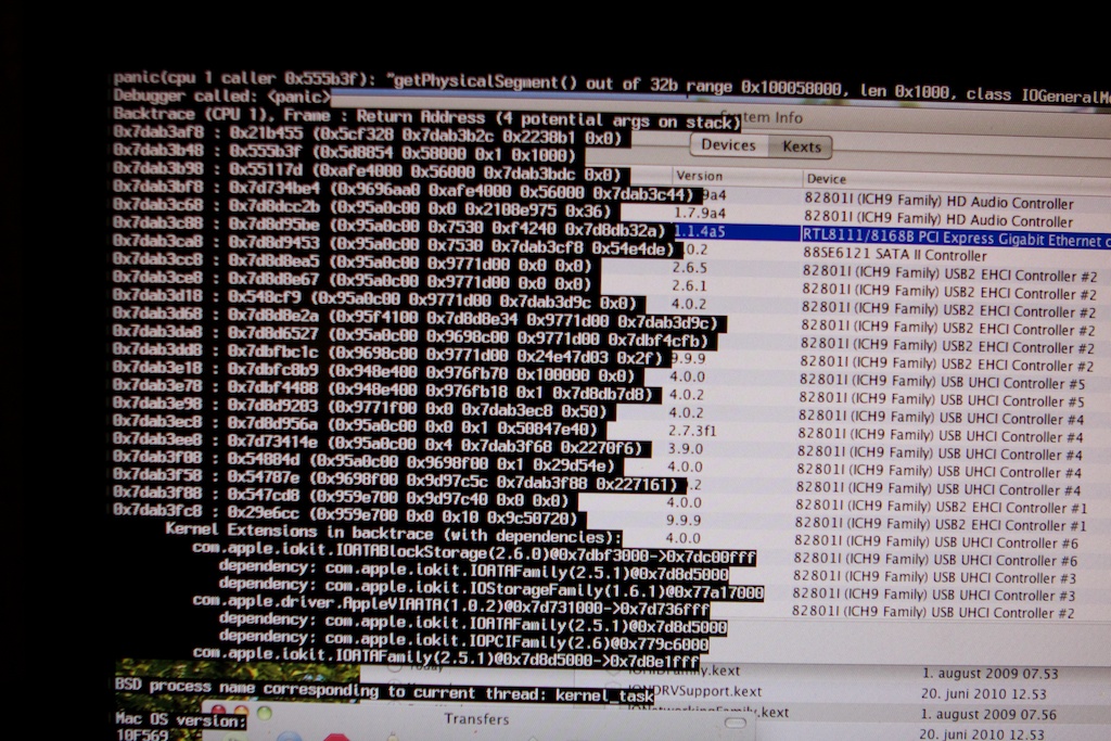

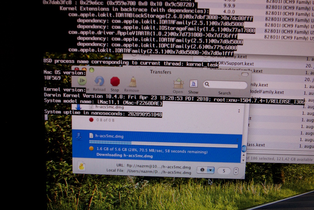

nazrm Posted June 22, 2010 Author Share Posted June 22, 2010 Managed to actually catch a kernel panic. Happened when I tried to download a file via ftp. After googling a bit it seems like this KP is due to the VIAATA kext not supporting 32bit (?) Trying this: http://www.insanelymac.com/forum/index.php?showtopic=127611 EDIT: No go. Unable to boot. (couldnt find HDD) EDIT2: If I go with 2GB ram installed (usually have 6gb) - the transfer goes through without a KP! Gonna let this ride and see if I get any other KPs, or if this was the root cause. EDIT3: Updated IOATAFamily.kext to SL/64bit, can now run 6gigs of ram and transfer file over FTP without kp. Link to comment Share on other sites More sharing options...

nazrm Posted June 22, 2010 Author Share Posted June 22, 2010 http://www.kexts.com/view/319-ioatafamily.kext.html That's the one. Haven't had any KPs since I installed it, so fingers crossed it won't happen! (hope I didn't just jinx myself ) Link to comment Share on other sites More sharing options...

D.Moscowstar Posted June 28, 2010 Share Posted June 28, 2010 my problem is with IOATAFamily.kext and it happens on machines with more than 2gigs of RAM. I found another IOATAFamily but only 2 SATA ports are being detected. So may be someone has the correct "mixed" kext? btw nazrm's linked kext doesn't work on my conf. Link to comment Share on other sites More sharing options...
terrorgen Posted June 28, 2010 Share Posted June 28, 2010 I renamed AppleIntelPIIXATA.kext and AppleVIAATA.kext in /E/E and installed this attached IOATAFamily.kext to /S/L/E. I think I got it work, but sadly I couldn't verify it now because my hard drive corrupted and am waiting for a warranty replacement. (Ouch!) Let me know the results... IOATAFamily.kext.zip Link to comment Share on other sites More sharing options...
