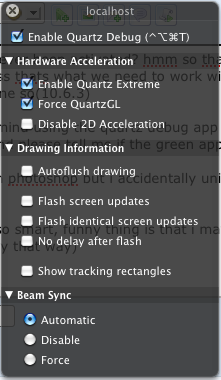

ertepechis Posted July 29, 2010 Share Posted July 29, 2010 wait quartzgl has never been activated? hmm so thats why theres all these bugs(like green screen) in my apps... i guess thats what we need to work with first, this might fix the green apple problem that has eluded some so(10.6.3 users mostly) anarchintosh, you mind using the quartz debug app and force enable QuartzGL as shown in the picture attached, and please tell me if the green apple problem persists i would try this with photoshop but i accidentally uninstalled it(that was my only green screen example i had) i got to quit talkin so smart ++EDIT++ heres my idea of why the dvi port wont work, its being classified as vga(just a theory though) hd4350.plist.zip Link to comment https://www.insanelymac.com/forum/topic/219362-replacing-graphicsenabler-with-an-efistring/page/2/#findComment-1520869 Share on other sites More sharing options...
ANARCHiNTOSH Posted July 29, 2010 Author Share Posted July 29, 2010 wait quartzgl has never been activated? hmm so thats why theres all these bugs(like green screen) in my apps... i guess thats what we need to work with first, this might fix the green apple problem that has eluded some so(10.6.3 users mostly) anarchintosh, you mind using the quartz debug app and force enable QuartzGL as shown in the picture attached, and please tell me if the green apple problem persists i would try this with photoshop but i accidentally uninstalled it(that was my only green screen example i had) i got to quit talkin so smart ++EDIT++ heres my idea of why the dvi port wont work, its being classified as vga(just a theory though) ok, well i forced QuartzGL and nothing happened, i think Quartz and Quartz Extreme are working fine. when experimenting in photoshop i went to preferences > performance and discovered this (see attached tiff image file.) when i disabled OpenGL Drawing in photoshop, i could use it normally, free of the green problem. Interestingly, photoshop cs4 tells us that 4350 owners are using a prototype OpenGL driver. (see attached tiff) i think this explains the green problem. The Green problem is completely within the OpenGl driver i think. The ati4350 opengl driver can be found in S/L/E as ATIRadeonX2000GLDriver.bundle (below details how i found it) doing some experimentation i used this command to find out what kexts i had loaded: i typed into terminal kextstat > /my_loaded_kexts.txt this gave me text file in root which told me. anyway specific ATI kexts that ATI4350 is dependent on are ATI4500Controller, ATISupport.kext, ATIFramebuffer.kext, ATIRadeonx2000.kext and its various plugins. I was interested in ATIRadeonX2000GLDriver.bundle which is the ATI RadeonX2000 OpenGL Driver I was thinking back to OSX 10.6.2, when 4350 worked, but worked free of the green problem (i think, at least there was no green apple, i never checked photoshop). In the past i have tried to get ATI kexts from 10.6.2 to work on 10.6.3, but it never worked. Now i wonder if it might make any difference deleting this one, and using the one from 10.6.2, if that doesnt result in a kernal panic. Ive uploaded the one from 10.6.2 if you want to try it ertepechis, ill also give it a go. BACK to efistrings: @errandwolfe i am interested in knowing what you mean by: we are FORCING a boot onto a (theorized) non-existing ADC port. the reason i feel so incredulous as to why the efistring dump of what graphicsenabler injects doesnt straightaway work (both for me and you), is because it so should.... theoretically it is exactly the same as what graphicsenabler injects........ so there must be some gap in my knowledge which would explain why it isnt working. I think what needs to be done is the question needs to be posed to real experts of osx86: "Why does my ioreg dump, which should be the same hex code as that injected by graphicsenabler, not work when i put it in boot.plist as a device-properties entry?" This should be a resolvable issue... as the efistring for ATI4850 shows (see first post) I think i might try to get in touch with the insanelymac user hawgguy, as he is credited at this topic for the efistring. 10.6.2_ATIRadeonX2000GLDriver.zip Enable_Disable_OpenGL.tiff Link to comment https://www.insanelymac.com/forum/topic/219362-replacing-graphicsenabler-with-an-efistring/page/2/#findComment-1521073 Share on other sites More sharing options...

ertepechis Posted July 29, 2010 Share Posted July 29, 2010 ok, well i forced QuartzGL and nothing happened, i think Quartz and Quartz Extreme are working fine. when experimenting in photoshop i went to preferences > performance and discovered this (see attached tiff image file.)when i disabled OpenGL Drawing in photoshop, i could use it normally, free of the green problem. Interestingly, photoshop cs4 tells us that 4350 owners are using a prototype OpenGL driver. (see attached tiff) i think this explains the green problem. The Green problem is completely within the OpenGl driver i think. The ati4350 opengl driver can be found in S/L/E as ATIRadeonX2000GLDriver.bundle (below details how i found it) doing some experimentation i used this command to find out what kexts i had loaded: i typed into terminal kextstat > /my_loaded_kexts.txt this gave me text file in root which told me. anyway specific ATI kexts that ATI4350 is dependent on are ATI4500Controller, ATISupport.kext, ATIFramebuffer.kext, ATIRadeonx2000.kext and its various plugins. I was interested in ATIRadeonX2000GLDriver.bundle which is the ATI RadeonX2000 OpenGL Driver I was thinking back to OSX 10.6.2, when 4350 worked, but worked free of the green problem (i think, at least there was no green apple, i never checked photoshop). In the past i have tried to get ATI kexts from 10.6.2 to work on 10.6.3, but it never worked. Now i wonder if it might make any difference deleting this one, and using the one from 10.6.2, if that doesnt result in a kernal panic. Ive uploaded the one from 10.6.2 if you want to try it ertepechis, ill also give it a go. BACK to efistrings: im going to try it n if i dont post results in 12 hours then i got KP... wish me luck some interesting ati 4350 stuff, unfortunately non-efistring related. i gleaned this from a Chinese/Japanese website, and had to use Google Translate, so its a bit confusing.again this is about kexts. 0X954F1002 is 4350 device-id, so its definitely for 4350. the gist of what he is saying is on 10.6.3 use PC_EFI 10.6 graphicsenabler, and use from these kexts from 10.6.2: ATI4500Controller.kext (with device-id) + atiframebuffer.kext + atisupport.kext Ive uploaded those kexts to this post I wonder if these deal with the green apple problem..... However im not sure if its worth it, because i think the choice of resolution might be affected...... i'd try this but i dont got a dvi screen yet(not enough money to spare for a good one) Link to comment https://www.insanelymac.com/forum/topic/219362-replacing-graphicsenabler-with-an-efistring/page/2/#findComment-1521160 Share on other sites More sharing options...
