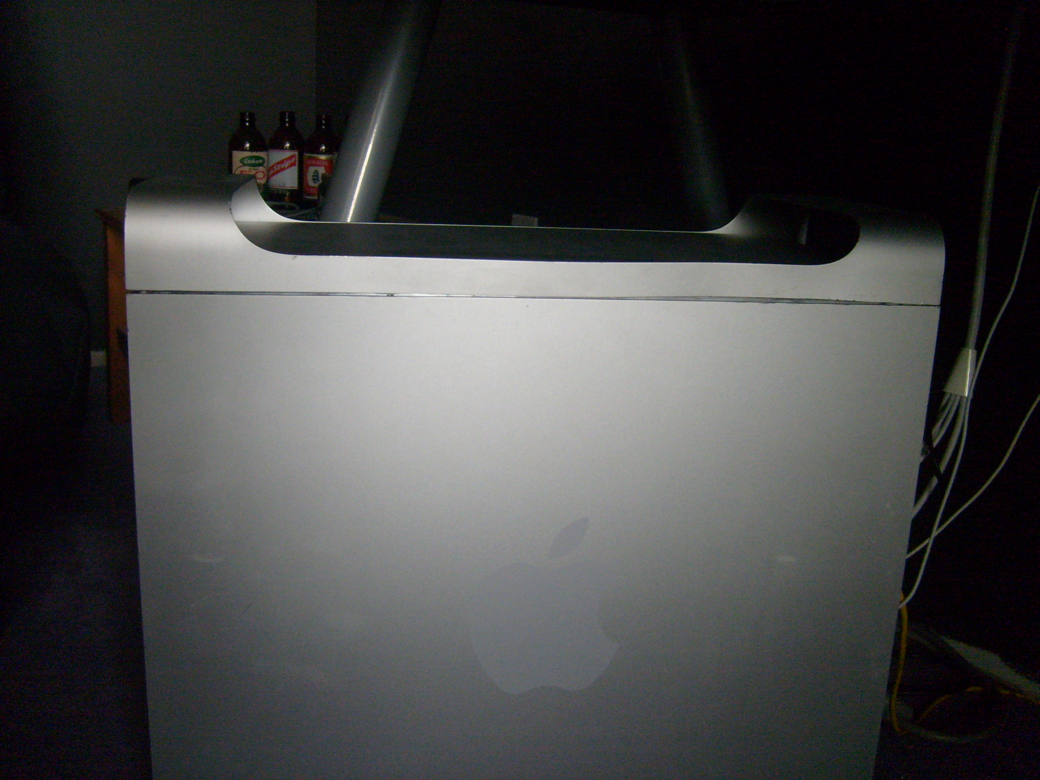

misterchose Posted May 19, 2010 Share Posted May 19, 2010 when i bought my case it was bent like yours, but i glue it with jb weld, and i let it it dry for 2 days, this is the result Link to comment https://www.insanelymac.com/forum/topic/218868-how-can-i-repair-popped-out-g5-rivets/#findComment-1471626 Share on other sites More sharing options...
