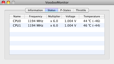

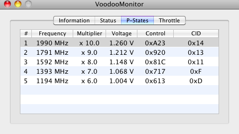

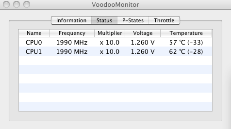

peach-os Posted January 27, 2011 Author Share Posted January 27, 2011 with the new HW Sensors from here http://www.projectosx.com/forum/index.php?showforum=165 a comfortable measuring is available to control temps for cpu, graphics,cpu voltage and other sensors. great work! install the HW Sensors to S/L/E IntelCpuMonitor doesn´t work from Extra. I deleted in SuperIOFamily already all plugins that aren´t needed to make boot time shorter to get proper speedstepping you have to check first Generate P-States, Generate C-States and Drop SSDT in Chameleon preferences. but it won´t start throttling before setting the needed model id in smbios.plist according to the hardware specs of the Acer6292 it should be MacBook3,1 , because the closest match is the MacBook late 2007 - but this won´t work! MacPro3,1 would give you speedstepping, but avoid some functions. to keep everything working (i.e. coolbook if needed) I decided to follow silencers guide here http://www.insanelymac.com/forum/index.php?showtopic=211705 and to create a legacy.kext for the acer6292. all credits to him ! put the attached legacyAcer6292.kext in Extra and set the model to MacBook3,2 in SMBios.plist, reboot - et voilá! speedstep is working! you can proof it with voodoomonitor p-states in vodoomonitor - throttling at lowest p-state - highest p-state you can see the throttling also in the free version of coolbook and use it to raise the cpu load for testing all needed files are in the attached package, except iStat for measuring - look for last free version 2.0 or you have to buy it for 16 bucks ! EDIT: if you experience kernel panics, get rid of iStat or other hardware sensors ! acer6292_speedstep.zip Link to comment https://www.insanelymac.com/forum/topic/218555-how-to-install-snow-leo-on-acer-6292/page/3/#findComment-1630106 Share on other sites More sharing options...

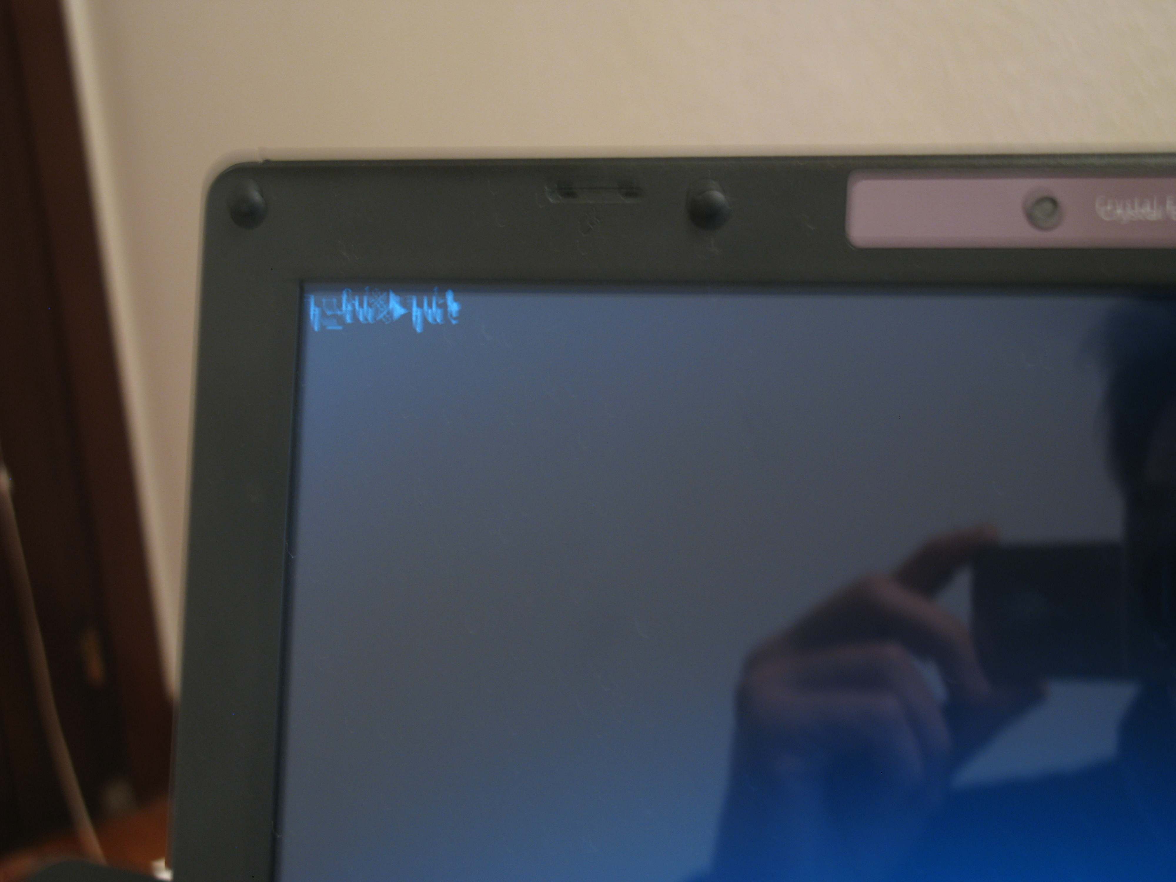

marcussebe Posted March 28, 2011 Share Posted March 28, 2011 Hi peach-os, I use your guide to install SL on my Acer 6292, but when I reboot the system I don't have the chameleon menù (Look the image, alphanumeric characters meaningless) Can you help me? My HD partition is MBR: Partition 1: Win XP Partition 2: Win 7 Partition 3: Snow Leopard Boot flag fingerprint is enable Thanks by Marcuss Link to comment https://www.insanelymac.com/forum/topic/218555-how-to-install-snow-leo-on-acer-6292/page/3/#findComment-1662084 Share on other sites More sharing options...
peach-os Posted March 28, 2011 Author Share Posted March 28, 2011 sorry I can´t analyze what is wrong, but I can tell you how it works. is there a specific reason you are using MBR partition? because Win XP ? (who needs that ?) this way it works: partitition your HD with GUID in two partititions. format first with HFS and the second with FAT. now reboot and install WIN 7 on second partition ( with FAT it could be recognized and reformated with ntfs) after this install Mac OS X on first partition and apply Chameleon. If Win doesn´t boot afterwards, just use the repair function of the WIN 7 DVD and it will work. as far as I remember you will always have problems booting chameleon from any other partition than the first. please someone correct me if I´m wrong. it might also work also with a third XP partition - but I never tried, because I´m really happy not to use ths f***** OS any more Link to comment https://www.insanelymac.com/forum/topic/218555-how-to-install-snow-leo-on-acer-6292/page/3/#findComment-1662180 Share on other sites More sharing options...
marcussebe Posted March 29, 2011 Share Posted March 29, 2011 sorry I can´t analyze what is wrong, but I can tell you how it works. is there a specific reason you are using MBR partition? because Win XP ? (who needs that ?) this way it works: partitition your HD with GUID in two partititions. format first with HFS and the second with FAT. now reboot and install WIN 7 on second partition ( with FAT it could be recognized and reformated with ntfs) after this install Mac OS X on first partition and apply Chameleon. If Win doesn´t boot afterwards, just use the repair function of the WIN 7 DVD and it will work. as far as I remember you will always have problems booting chameleon from any other partition than the first. please someone correct me if I´m wrong. it might also work also with a third XP partition - but I never tried, because I´m really happy not to use ths f***** OS any more Hi Peach-os GREAT GREAT GREAT, THANKS THANKS THANKS I partitition HD with GUID in two partititions. Format first with HFS+ and the second with FAT...and the system start!!!! I use Win XP for a old application to flash my phone. Well now the problems I followed the 15 point of step B, but at first boot: mouse, keyboard, LAN don't work I install all file from directory Extra\Extensions, com.apple.Boot.plist, dsdt.aml ...the file voodoohdahelper, VoodooHDA.prefPane, Extensions.mkext, the directory Themes .... I have to install them??or not!! Can I install all files S:L:E ? and "LAN fixed ! - workin with these extensions" before upgrade the Snow Leopard 10.6 ??? Thank for your disponibility by Marcuss Link to comment https://www.insanelymac.com/forum/topic/218555-how-to-install-snow-leo-on-acer-6292/page/3/#findComment-1662565 Share on other sites More sharing options...
peach-os Posted March 29, 2011 Author Share Posted March 29, 2011 connect an usb keyboard mouse. first try to repair permissions with disk utility. if not possible you have to reinstall the BSD package as described. next step: copy the kexts to Extra and install to S/L/E with kext utility and repair permissions with disk utility after reboot everything should work Link to comment https://www.insanelymac.com/forum/topic/218555-how-to-install-snow-leo-on-acer-6292/page/3/#findComment-1662650 Share on other sites More sharing options...

marcussebe Posted April 28, 2011 Share Posted April 28, 2011 with the new HW Sensors from here http://www.projectosx.com/forum/index.php?showforum=165 a comfortable measuring is available to control temps for cpu, graphics,cpu voltage and other sensors. great work! install the HW Sensors to S/L/E IntelCpuMonitor doesn´t work from Extra. I deleted in SuperIOFamily already all plugins that aren´t needed to make boot time shorter to get proper speedstepping you have to check first Generate P-States, Generate C-States and Drop SSDT in Chameleon preferences. but it won´t start throttling before setting the needed model id in smbios.plist according to the hardware specs of the Acer6292 it should be MacBook3,1 , because the closest match is the MacBook late 2007 - but this won´t work! MacPro3,1 would give you speedstepping, but avoid some functions. to keep everything working (i.e. coolbook if needed) I decided to follow silencers guide here http://www.insanelymac.com/forum/index.php?showtopic=211705 and to create a legacy.kext for the acer6292. all credits to him ! put the attached legacyAcer6292.kext in Extra and set the model to MacBook3,2 in SMBios.plist, reboot - et voilá! speedstep is working! you can proof it with voodoomonitor p-states in vodoomonitor - throttling at lowest p-state - highest p-state you can see the throttling also in the free version of coolbook and use it to raise the cpu load for testing all needed files are in the attached package, except iStat for measuring - look for last free version 2.0 or you have to buy it for 16 bucks ! EDIT: if you experience kernel panics, get rid of iStat or other hardware sensors ! acer6292_speedstep.zip Hi Pech-OS, I have some questions to your speedstepping guide: 1) now I have S.L. 10.6.2. Your guide works in S.L. 10.6.3, 10.6.4 ..... ? 2) ....you have to check first Generate P-States, Generate C-States and Drop SSDT in Chameleon preferences... I insert DropSSDT=Yes in the config file of Chameleon how check Generate P-States, Generate C-States ? 3) ...put the attached legacyAcer6292.kext in Extra and set the model to MacBook3,2 in SMBios.plist... How can I set the model to MacBook3.2 ?? Thank you for your help by Marcussebe Link to comment https://www.insanelymac.com/forum/topic/218555-how-to-install-snow-leo-on-acer-6292/page/3/#findComment-1675656 Share on other sites More sharing options...
