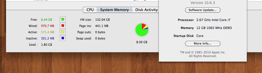

Pier25 Posted May 14, 2010 Share Posted May 14, 2010 I'm having some problems using 3 dimms of memory in my hackintosh. System profiler detects 3 dimms, but activity monitor only 2... My mobo is a gigabyte ex58 ud3r Anyway, I decided to flash the bios of the mobo to see if that helps. The thing is I downloaded an exe from gigabyte and I don't have windows installed in my hackintosh. Will I be able to flash the bios from parallels or fusion? Do I have to install windows in a new partition to do that? What about using an ultimate boot cd or something like that? TIA Link to comment https://www.insanelymac.com/forum/topic/218388-flashing-bios-from-parallels/ Share on other sites More sharing options...

Pier25 Posted May 14, 2010 Author Share Posted May 14, 2010 Yeah I imagined that a virtual machine in a higher layer couldn't do that.... but I wasn't really sure. According to gigabyte the qflash cna only be used from a floppy... if I can do it from a USB then great! Here's the info from top about the memory. As you can see only 8gb, and not 12Gb as it should. MemRegions: 7878 total, 400M resident, 19M private, 188M shared. PhysMem: 804M wired, 512M active, 290M inactive, 1606M used, 6835M free. Edit: I can't flash bio from usb, only from floppy... I haven't had a floppy for years in my computers Reedit: It seems Qflash is not the same version accessing from inside the bios, or from the splash screen... In the one at the splash screen I couldn't load it from a USB either, but I could from a small fat 32 partition I left unused for installing windows at some point. So I flashed the bios with no problems, but still can't use the 12Gb of ram... sigh Link to comment https://www.insanelymac.com/forum/topic/218388-flashing-bios-from-parallels/#findComment-1468328 Share on other sites More sharing options...
