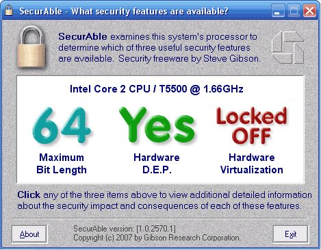

kleong Posted May 16, 2010 Share Posted May 16, 2010 Firstly go to www.grc.com and run the Securable program there. Post the output and then we can see what is possible. Thanks Donk. I have ran the program and attached is the output. Pls advice if it is possible to turn it on. Thanks Link to comment Share on other sites More sharing options...
Donk Posted May 16, 2010 Share Posted May 16, 2010 Thanks Donk. I have ran the program and attached is the output. Pls advice if it is possible to turn it on. Thanks Sorry it can't be enabled as it is in the "Locked Off" state. That is because the BIOS has switched VT-x off and locked the MSR registers such that VT-x cannot be enabled in software. Maybe there is a hacked BIOS someone has made to enable it, but I couldn't find anything on the web. Sorry to have to give you the bad news. Link to comment Share on other sites More sharing options...
