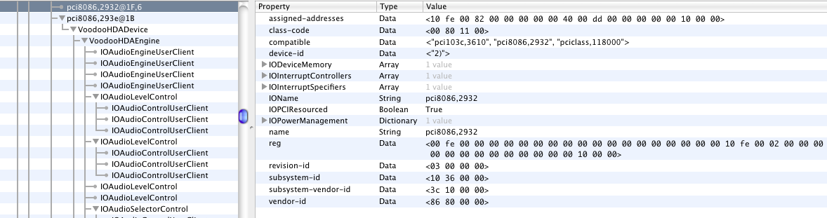

from lspci there is this device:
00:1f.6 Signal processing controller [1180]: Intel Corporation 82801I (ICH9 Family) Thermal Subsystem [8086:2932] (rev 03)
looking for it on ioregexplorer, I see this
it doen't seem to be recognized either,
please if anybody over here could give some guidance on that, it would be really great
https://www.insanelymac.com/forum/topic/214805-thermal-subsystem/
even if temperature monitors show good values, I don't feel like my fan gets changing (have no FAN device on dsdt either)
