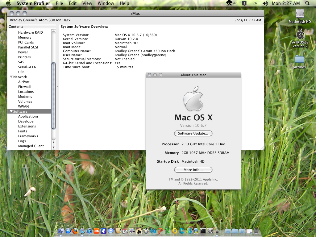

Brad Greene Posted May 18, 2011 Share Posted May 18, 2011 I got 64 bit!! I updated to 10.6.7 (using the combo update) used [url="http://www.insanelymac.com/forum/topic/279450-why-insanelymac-does-not-support-tonymacx86/"]#####[/url] to install AppleHDA and USB rollback, upon reboot I got nothing... Just the BIOS splash and a reboot... So I hooked the drive to another hack laptop I had, installed chameleon RC5 on it... and booted to a kernel panic no matter what I tried... so out of desperation I hooked it back up to the laptop and deleted mach_kernel from the hard drive, and installed the 10.7.0 kernel. I deleted AppleHPET.kext to get USB 2.0 working. P.S. I have this board overclocked to 2.13Ghz and it's stable (48 hours now) Link to comment https://www.insanelymac.com/forum/topic/214771-sl-on-asus-at3iont-i-deluxe/page/2/#findComment-1685686 Share on other sites More sharing options...

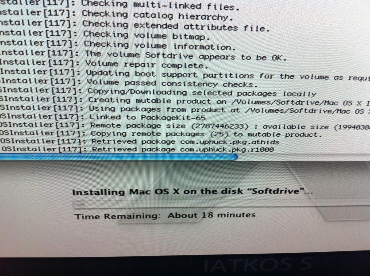

ge0 Posted February 5, 2012 Share Posted February 5, 2012 Hi! I have an Asus AT3IONT-I Deluxe too and I've been trying to install OS X using iATKOS S3 v2 without success I get to the point where it starts installing an it says how much time is left. It loads to about 5% and then freezes there and tells me it's 18 minutes left. I've let it run for around 7 hours, multiple times, with no luck. The last time(s) I took a look in the installation log and it seems that it freezes at the same point every time: "Retrieved package com.uphuck.pkg.r1000". I've tried booting using cpus=1 but the result is the same. How do I fix this? I have made sure the bios settings are as similar as http://thebackpackr....-bios-settings/ as possible. I don't think it matters but I've overclocked the CPU to 2ghz. It should theoretically not affect the installation process... right? I guess this does not actually affect the installation process either, but in customize I choose... bootloader option: Graphics enabler 32-bit boot [*]kernel patch for Atom [*]VGA -> nVidea [*]Network: Wired -> Realtek RTL8168 Wireless -> Atheros Have I missed a patch or anything? What bootloader should I use? There seems to be quite a lot of people who get stuck at 18 minutes (http://lmgtfy.com/?q=iatkos+18+minutes), but there's no straight forward solution. And most of the answers is that the user should wait for a couple of hours and that the loading bar would just make a big leap. That has not happened. Link to comment https://www.insanelymac.com/forum/topic/214771-sl-on-asus-at3iont-i-deluxe/page/2/#findComment-1793301 Share on other sites More sharing options...
ge0 Posted February 17, 2012 Share Posted February 17, 2012 I finally managed to install OS X! But I had to do it in my own way I managed to fix WIFI which many of you had problems with. Just install this kext: http://www.osx86.net...ros_ar9285.html I have the following problems: 1. No sound via HDMI 2. Noisy sound. I don't know what kexts to use! And I've tried everything suggested. Fixed! 3. When I update to 10.6.8 using combo update, the OS won't boot. Going to try it again See steps 14-18 3. Can't get built in bluetooth to work. But my bluetooth usb dongle works great. 4. It doesn't say that Qe/CI is enabled (nor disabled, it doesn't say anything). 5. USB is behaving weird. Sometimes it works, sometimes it doesn't Don't install PXHCD.kext!!!! Here's my procedure: 0. Prepare AT3IOINT-I Deluxe machine with right BIOS config (http://thebackpackr....-bios-settings/) Configure SATA as [AHCI] 1. Format drive of interest as GPT partition 2. Install OS X from retail Snow Leopard Installation DVD (10.6.3) to external HDD using a Mac (be careful not to install to the Mac's real drive!). Btw, I used an ordinary HDD with a USB to SATA cable I didn't use a real "external" HDD. 3. Boot up from the external HDD and do the initial setup (still on the Mac!). 4. Install kexts using Kext Wizard (http://www.insanelym...howtopic=253395): IOAHCIBlockStorageInjector.kext Disabler.kext FakeSMC.kext RealtekRTL81xx.kext UUID.kext IO80211Family.kext (WIFI - http://www.osx86.net...ros_ar9285.html) PXHCD.kext DON'T!!!! SleepEnabler.kext 5. Download mach_kernel_atom [mach_kernel 10.3.0 (Mac OS X 10.6.3) Fixed 64-bit mode] and rename it to mach_kernel. 6. Replace mach_kernel in external drive's root-folder with the mach_kernel(_atom) you just downloaded. 7. chown -R 0:0 mach_kernel 8. Put HDD into the AT3IOINT-I Deluxe machine (Now using SATA). 9. Boot with "[url="http://www.insanelymac.com/forum/topic/279450-why-insanelymac-does-not-support-tonymacx86/"]#####[/url] Legacy" Disk. (http://www.tonymacx86.com/downloads) 10. Select HDD in the menu and boot 11. Install [url="http://www.insanelymac.com/forum/topic/279450-why-insanelymac-does-not-support-tonymacx86/"]#####[/url] (http://www.tonymacx86.com/downloads) with the following alternatives checked: - [url="http://www.insanelymac.com/forum/topic/279450-why-insanelymac-does-not-support-tonymacx86/"]#####[/url] - Drivers & Bootloaders -> Kexts & Enablers -> Miscellaneous -> PS/2 - Customizations -> Boot Options -> 32-bit Apple Boot Screen 12. Reboot using HDD this time. 13. I followed the installation-instructions for bluetooth in the thread: http://www.insanelym...howtopic=270370 The internal bluetooth did not work, however my bluetooth usb dongle did. So I did do not know if this does any different. But I did it anyway. 14. Install Combo Update to 10.6.8 (http://support.apple.com/kb/DL1399). When finished, DO NOT REBOOT!!! 15. Download patched kernel (it's an atom kernel for 10.6.8) from http://prasys.info/2...nd-intel-atoms/, extract it and move legacy_kernel-10.6.8 to Macintosh HD or root of your drive aka (/ ) 16. Open terminal and then run these commands: cd / sudo mv mach_kernel mach_kernel_old sudo mv /legacy_kernel-10.6.8 /mach_kernel sudo chown -R 0:0 mach_kernel sudo chmod -R 644 mach_kernel (long story short - replace old kernel with the one you downloaded) 17. Run [url="http://www.insanelymac.com/forum/topic/279450-why-insanelymac-does-not-support-tonymacx86/"]#####[/url] installer once again and install: - [url="http://www.insanelymac.com/forum/topic/279450-why-insanelymac-does-not-support-tonymacx86/"]#####[/url] - Drivers & Bootloaders -> Kexts & Enablers -> Audio -> Realtek ALC8xx -> ALC8xxHDA - Drivers & Bootloaders -> Kexts & Enablers -> Audio -> Realtek ALC8xx -> AppleHDA Rollback - Drivers & Bootloaders -> Kexts & Enablers -> Audio -> Realtek ALC8xx -> Non-DSDT HDAEnabler -> ALC887/888b - Drivers & Bootloaders -> Kexts & Enablers -> Miscellaneous -> PS/2 - Customizations -> Boot Options -> 32-bit Apple Boot Screen 18. Now, you may reboot Link to comment https://www.insanelymac.com/forum/topic/214771-sl-on-asus-at3iont-i-deluxe/page/2/#findComment-1797080 Share on other sites More sharing options...
