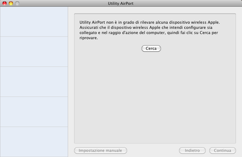

Emanuele3000 Posted February 5, 2010 Author Share Posted February 5, 2010 Versioni software: Menu extra: 6.0 (600.22) plugin configd: 6.1 (610.2) System Profiler: 6.0 (600.9) Preferenza network: 6.0 (600.22) Utility AirPort: 5.4.2 (542.23) Famiglia IO80211: 3.1 (310.6) questo sta nel menu airport ma non si connette come devo fare? Link to comment https://www.insanelymac.com/forum/topic/210042-aiuto-dell-dw-1390-su-snow/#findComment-1404334 Share on other sites More sharing options...

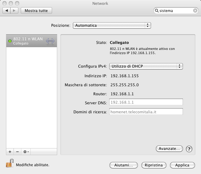

Giorgio_multi Posted February 5, 2010 Share Posted February 5, 2010 Versioni software:Menu extra: 6.0 (600.22) plugin configd: 6.1 (610.2) System Profiler: 6.0 (600.9) Preferenza network: 6.0 (600.22) Utility AirPort: 5.4.2 (542.23) Famiglia IO80211: 3.1 (310.6) questo sta nel menu airport ma non si connette come devo fare? Posta un'immagine di Preferenze di Sistema/Network e dell'icona Airport esplosa. Giorgio Link to comment https://www.insanelymac.com/forum/topic/210042-aiuto-dell-dw-1390-su-snow/#findComment-1404336 Share on other sites More sharing options...
Emanuele3000 Posted February 5, 2010 Author Share Posted February 5, 2010 Queste due? alla prima dice connesso xk ho una d-link usb collegata... Link to comment https://www.insanelymac.com/forum/topic/210042-aiuto-dell-dw-1390-su-snow/#findComment-1404343 Share on other sites More sharing options...

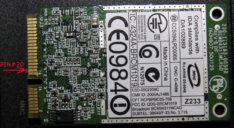

Giorgio_multi Posted February 5, 2010 Share Posted February 5, 2010 Queste due? alla prima dice connesso xk ho una d-link usb collegata... La dell NON viene riconosciuta. Prova coprendo il pin 20 con del nastro. Giorgio Link to comment https://www.insanelymac.com/forum/topic/210042-aiuto-dell-dw-1390-su-snow/#findComment-1404344 Share on other sites More sharing options...
Emanuele3000 Posted February 5, 2010 Author Share Posted February 5, 2010 quale sarebbe il ping 20? solo quello devo coprire? Link to comment https://www.insanelymac.com/forum/topic/210042-aiuto-dell-dw-1390-su-snow/#findComment-1404348 Share on other sites More sharing options...

fago88 Posted November 7, 2010 Share Posted November 7, 2010 si fatto così ma non è andato...che devo fare? ciao, anche io non riesco a far riconoscere la mia scheda di rete wireless dell dw1390, come hai risolto? ho provato a coprire il pin 20 ma niente, ho provato anche con windows..ma niente..help please! Link to comment https://www.insanelymac.com/forum/topic/210042-aiuto-dell-dw-1390-su-snow/#findComment-1578298 Share on other sites More sharing options...
