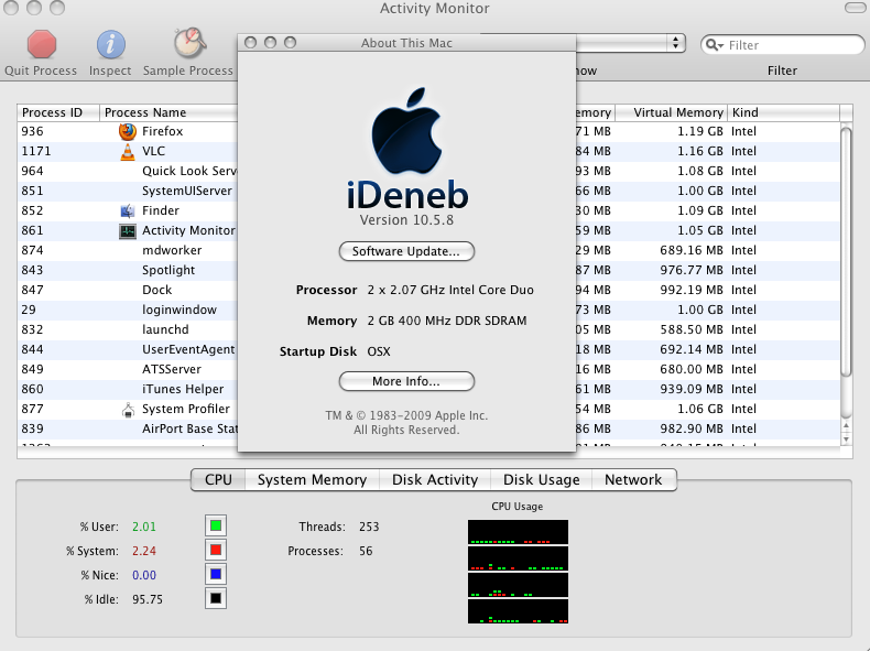

totaltechsvc Posted April 19, 2010 Share Posted April 19, 2010 I was able to get k8n-dre working with my sata harddrive from my phenom system. Its running ideneb 10.5.8 lite. I have 2x 270's that is sluggish with all four cores, it apears to tax the first core heavy. If I boot cpus=2 it runs 2 cores nice. Its almost as fast as my phenom. No Sleep though. I think to do all 4 cores... Need Modified Bios? or maybe its just a cpupower.kext, maybe speed spectrum? however, it could be a cooling issue do to the mounting of the heatpipe coolermaster 101a's,(its a tight fit) and they run at about 47c-52c. Any thoughts on this I would appreciate. I want to say thanks to el Kabong. Your posting on this site and overclockers made me deside to spend the 100 bucks or so Ive put into this system and it runs very nice so far. Just wish we could get all 4 cores running. Let me know if you have had any progress. *Update* Speed Spectrum Disabled in Bios. Then, I ran my ideneb 10.5.8 customized install to reloaded patches fixes and vodookernel, Now all 4cores are running fast & properly, system will try to sleep, turns off monitor, hard disk but fans are on, might be a bios issue. However, for now Im more than happy on how this hack turned out. I think Ill build 2. Link to comment https://www.insanelymac.com/forum/topic/208150-opteron-server-main-boards-with-osx-106-possible/#findComment-1451780 Share on other sites More sharing options...
