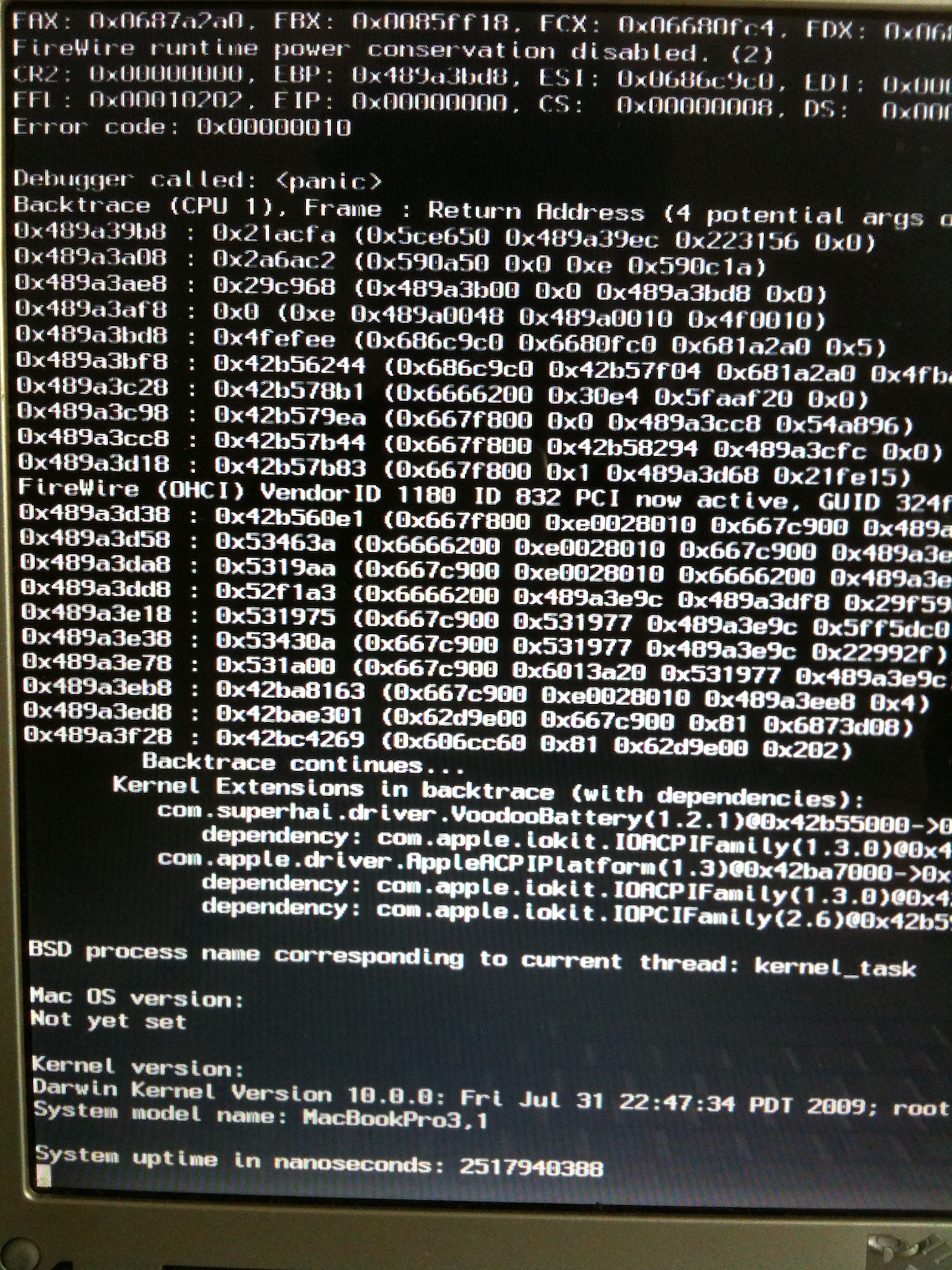

stlnation Posted December 29, 2009 Share Posted December 29, 2009 Booting a windows disc tells me there is no HD booting to OSX hangs at apple logo screen (asking me to power down) Booting to OSX disc Stats, hangs, then displays lines all across screen just want to format and start over here Dell Inspiron 1520 Link to comment https://www.insanelymac.com/forum/topic/204508-dang-kp-help-me/ Share on other sites More sharing options...
Marclh Posted December 30, 2009 Share Posted December 30, 2009 1. Boot in single user mode on your hard drive (Boot parameter: -s) You should get a bash shell soon 2. Enable writing to the disk by executing the 2 commands on the screen (fsck... and mount...) 3. rm -rf /System/Library/Extensions/VoodooBattery.kext 4. Reboot That might fix the problem. It has something to do with the Voodoo Battery kext I'm pretty sure. Link to comment https://www.insanelymac.com/forum/topic/204508-dang-kp-help-me/#findComment-1372277 Share on other sites More sharing options...
