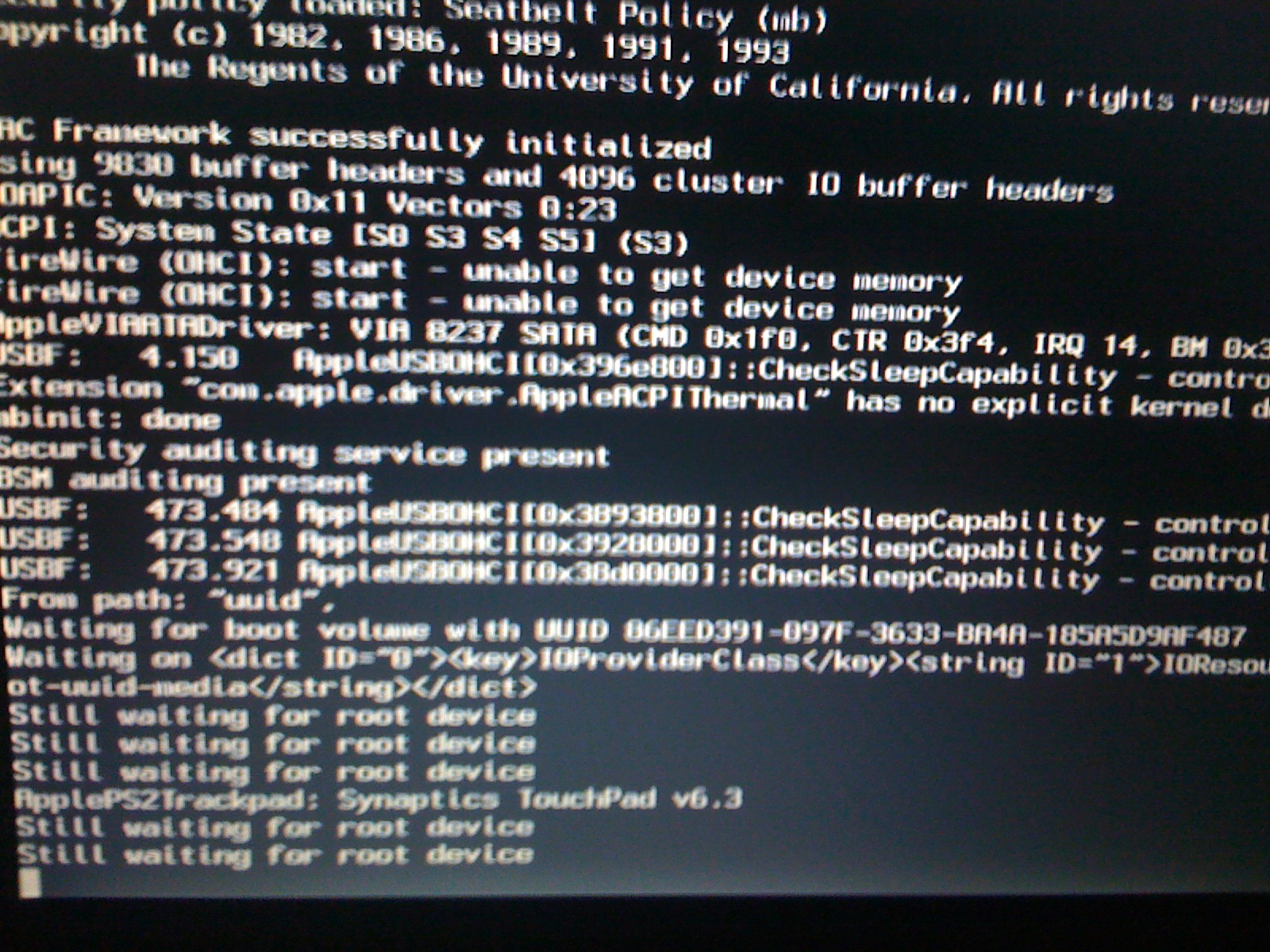

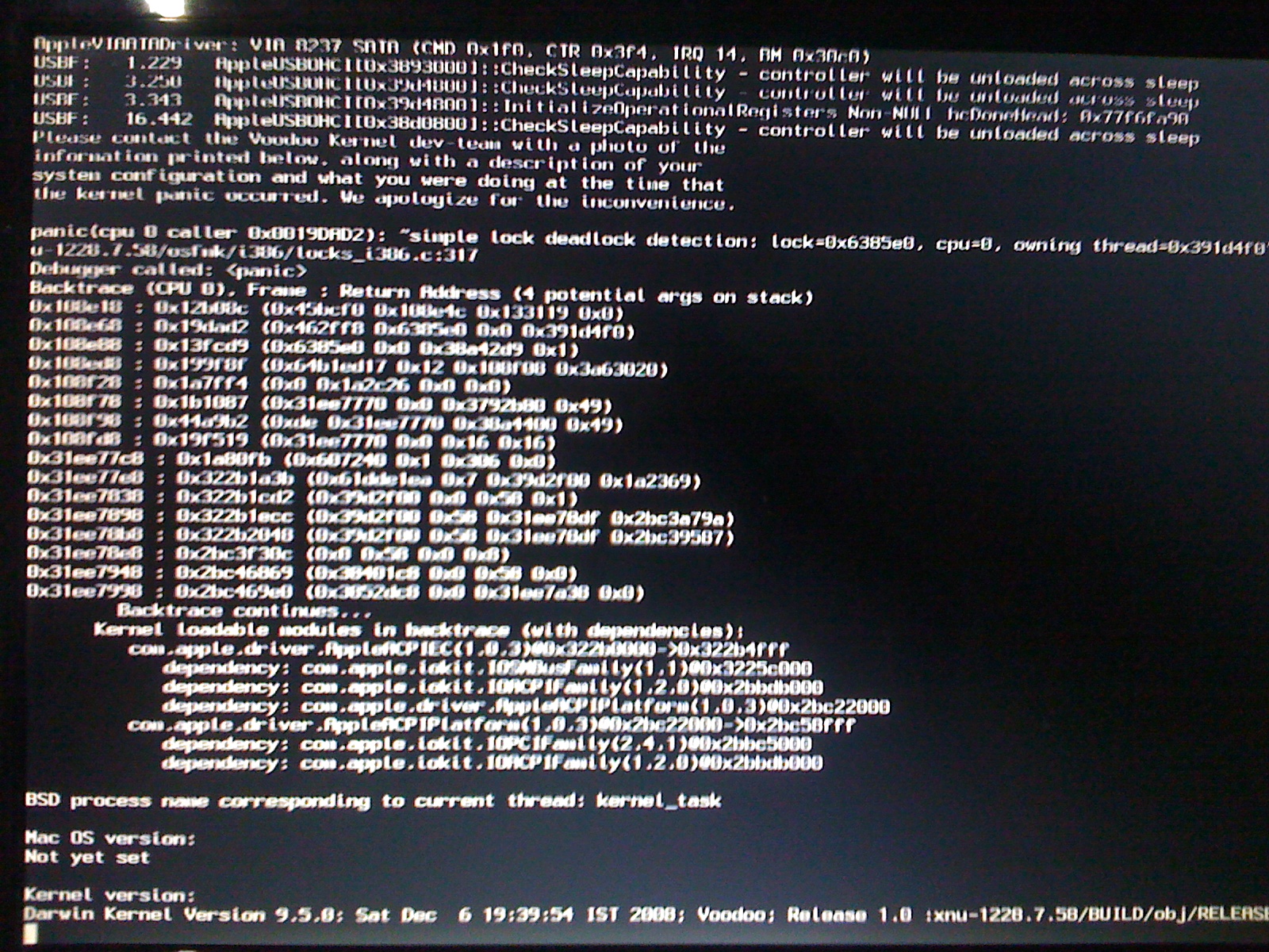

Jorge Iten Posted December 23, 2009 Share Posted December 23, 2009 Hi there I was trying to install the iPC 10.5.6 Universal PPF5(final) on my pc, but i had a trouble, and I need somebody to help me on this issue. My PC: Processor: Mobile DualCore AMD Turion 64 X2 TL-60, 2000 MHz (10 x 200) instructions: x86, x86-64, MMX, 3DNow!, SSE, SSE2, SSE3 MB: Quanta 30 CF MEM: 2GB DDR2 (Samsung M4 70T2864DZ3-CE6 ) chipset : nVIDIA nForce 7150M-630M (MCP67-M) I am booting from a ISO DVD, with the command -v, the error is printed below: So if you got any tip or experience with this version please help me thank you Link to comment https://www.insanelymac.com/forum/topic/203680-installing-ipc-on-hp-dv-6700/ Share on other sites More sharing options...
neil43 Posted December 24, 2009 Share Posted December 24, 2009 Try booting with this argument: -v -f idlehalt=0 cpus=1 My AMD installs have been somewhat weary and trouble prone. Good luck. neil Link to comment https://www.insanelymac.com/forum/topic/203680-installing-ipc-on-hp-dv-6700/#findComment-1367754 Share on other sites More sharing options...
Jorge Iten Posted December 24, 2009 Author Share Posted December 24, 2009 With this command the installation has progressed, but now stops waiting for some device, that i believe it is the hard disk, did you solve this problem too? Link to comment https://www.insanelymac.com/forum/topic/203680-installing-ipc-on-hp-dv-6700/#findComment-1368066 Share on other sites More sharing options...
neil43 Posted December 24, 2009 Share Posted December 24, 2009 Well you have made progress (from KP to stall waiting for root device). I have seen this error. I maybe wrong, but I think that the installer script is looking for the hard drive but does not find it at the anticipated location. If you have the ability to have your SATA HDD as your first device (lowest numbered SATA port). Do you have the ability to partition and pre-format your hard drive in OSX. If so try both MBR and GUID formatted partitions. Also, I suggest that you take notes as to what configurations you try and the result. neil Link to comment https://www.insanelymac.com/forum/topic/203680-installing-ipc-on-hp-dv-6700/#findComment-1368108 Share on other sites More sharing options...
