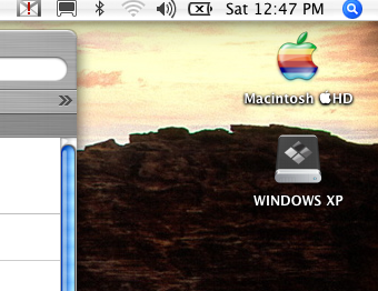

this is a 14 days old since i bought this macbook.... now... without the magsafe attached i cannot use the macbook..... i connect the magsafe and the baby boot-up..... but the battery icon say an x, and sense a no battery attached.... i called long distance apple care here in the philippines, and advices me to reset v ram by holding option-apple-pr and reset the baby... for 3 sets... yet with no able still i cannot start the macbook without plugging it in.... then the technician again advice me to drain the battery.... i am doing it now will im posting this....

thanks for the quick reply colonels1020.... i just did it now as you suggested.... while its still running... i removed the battery... using my thumb fingernail and after 5 sec the tilt the baby and put again the battery.... the reaction was... the battery icon turns from charging then just a few sec... turn again to battery icon with "x" with no battery available...
i have also done done this... turn off the unit... after a few sec... without the magsafe on.. i removed the battery and after a few sec... return it back and immediately press the power and its turn on to the system... then the bat icon turn from full to icon x..... wow this is driving me crazy..
i also try thiss... without the magsafe... remove the battery.... and after a few sec... return the bat back and just a few sec... lock the bat.... then press the power on... without rection from the macbook... it doesnt turn on... wow... and i am months away from going back to the store....

done it and i thought it cures it.... but the x icon battery is back again...

The exact same thing happened to my 15" mbp. It appeared that the battery had died, the battery led on the bottom would blink a couple of times quickly when the button was pressed then go out. An X on the battery meter.
