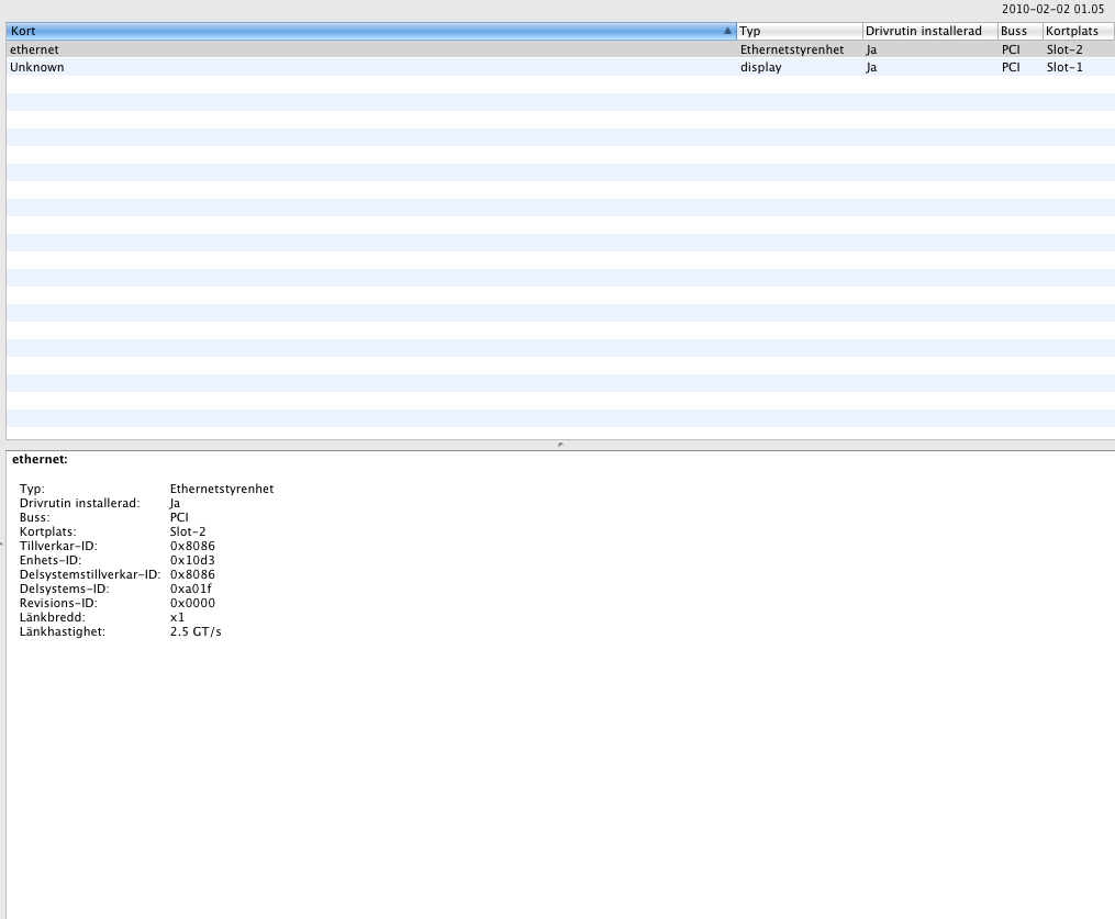

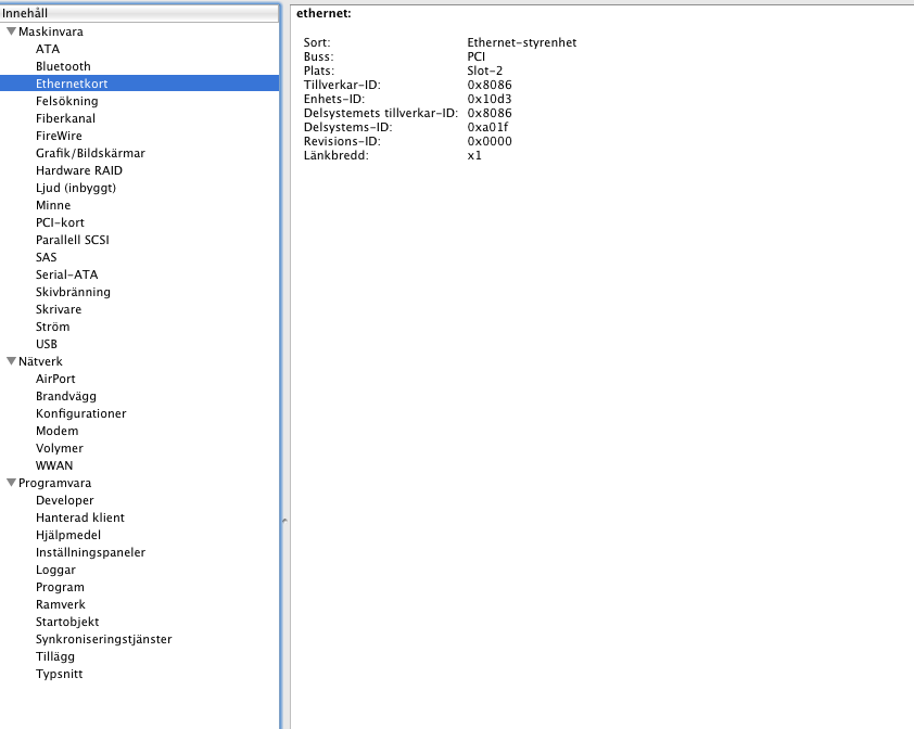

Daniel Gustavsson Posted February 2, 2010 Share Posted February 2, 2010 Oh, and just one more thing, This is on Snow Leopard 10.6.2.. Its working for me to Link to comment https://www.insanelymac.com/forum/topic/202183-82574l/#findComment-1401730 Share on other sites More sharing options...
