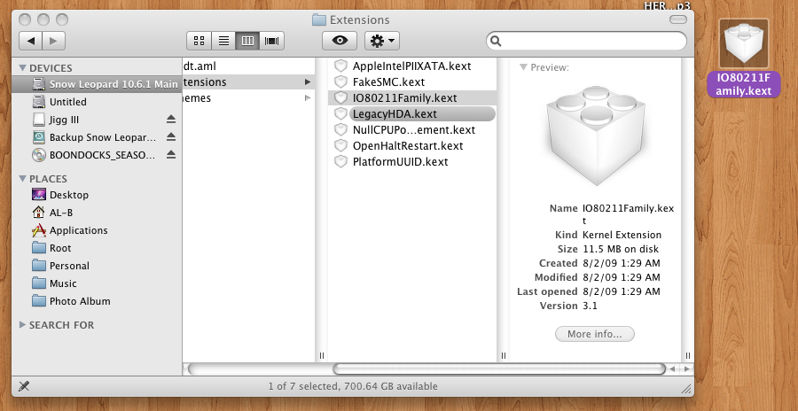

Following many others footsteps, what i've done is tried editing my 10.6.2 io80211family.kext:

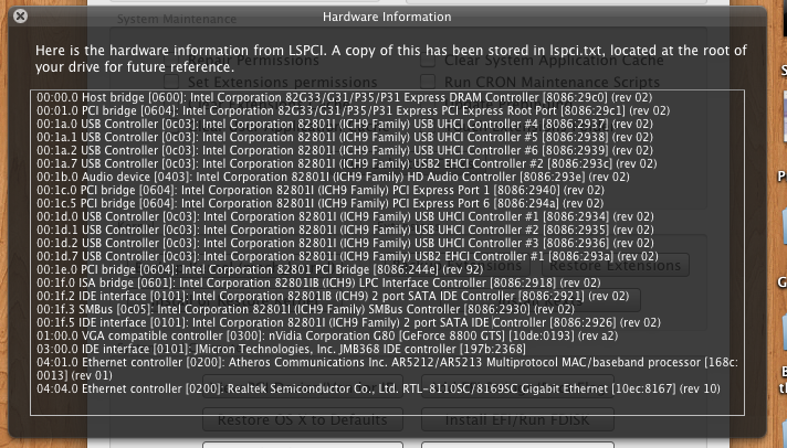

I start with finding my devices id by looking at the LSPCI
"168c:0013"

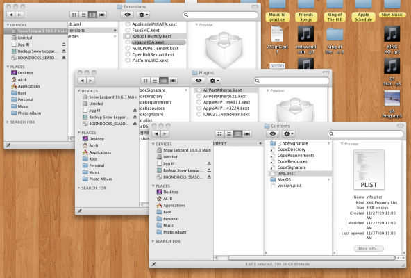

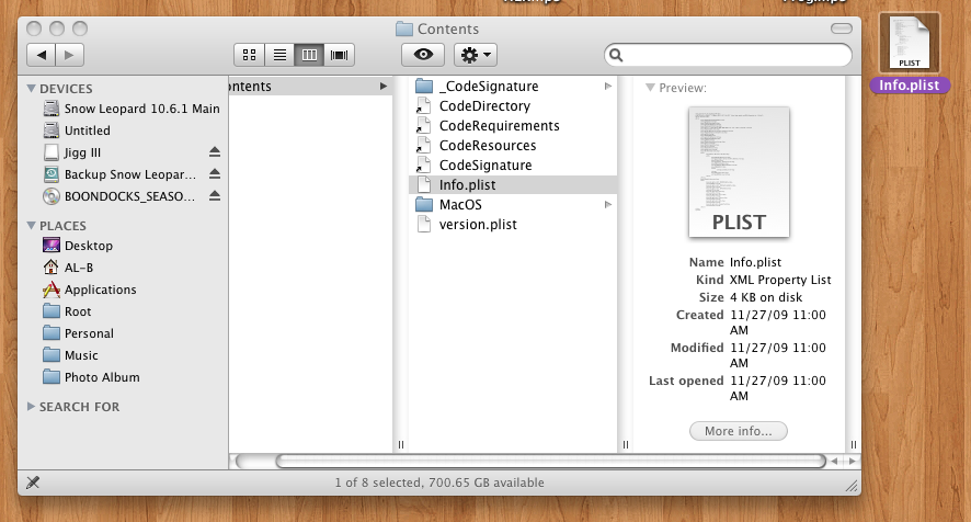

I then go into the io80211family.kext, and then go into the airportatheros.kext.

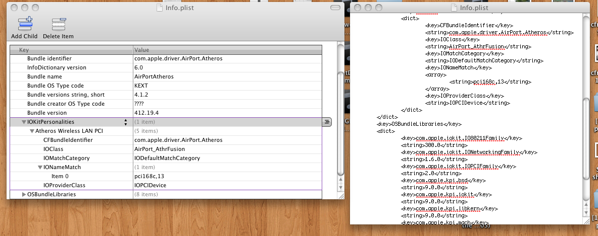

and then i edit the plist to list my device (note that i only have the device id of mine in here, i was having trouble simply adding it to the existing list as well)

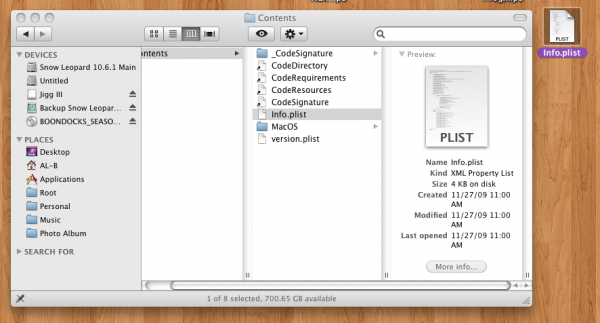

then i save the plist to my desktop (because it won't allow me to save over the current plist), drag it to the desktop and replace it in the airportatheros.kext

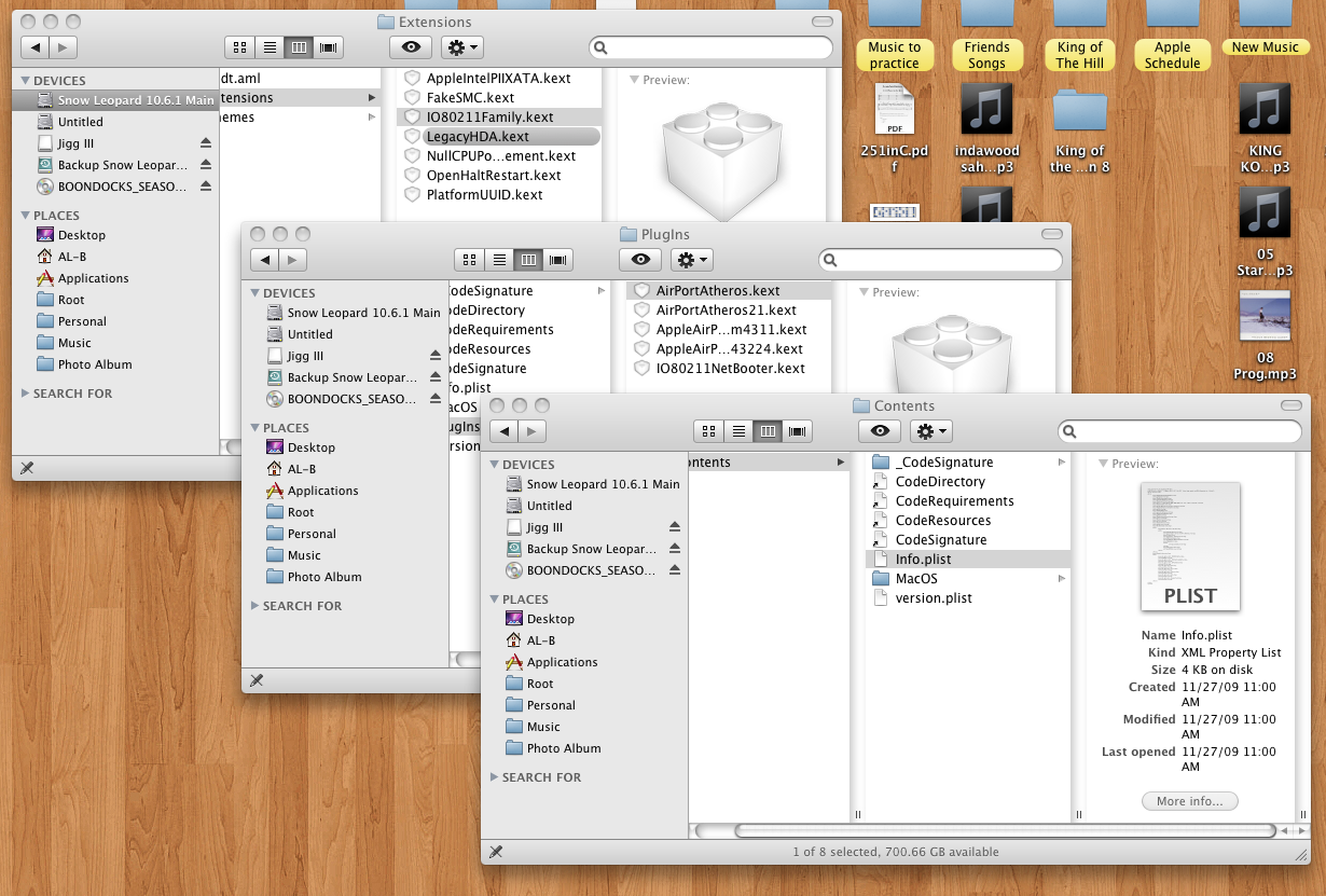

once it has been replaced i then proceed to put the kext into my extas folder

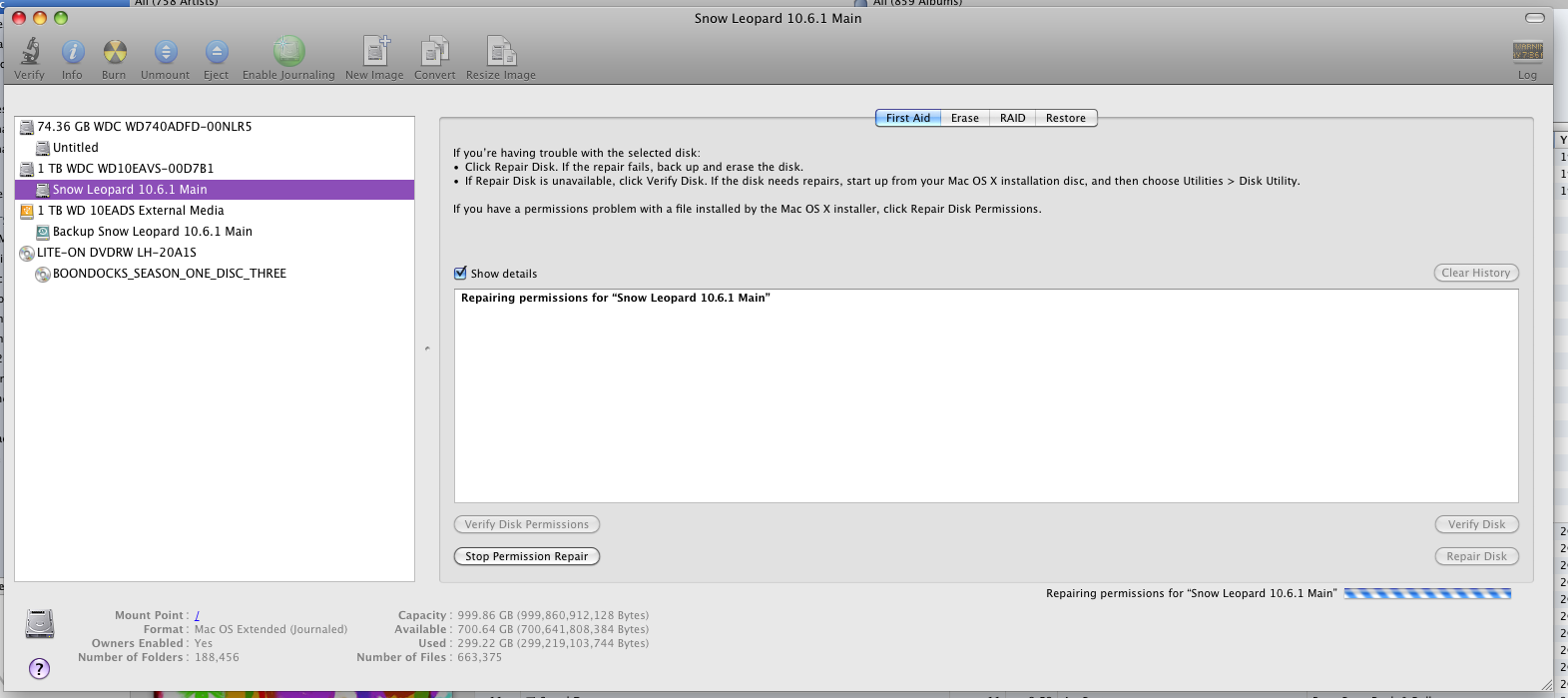

and repair permissions with disk utility as well as empty kext cache
i then boot and no mention of wifi in the boot log and just an empty funnel in the menu bar
