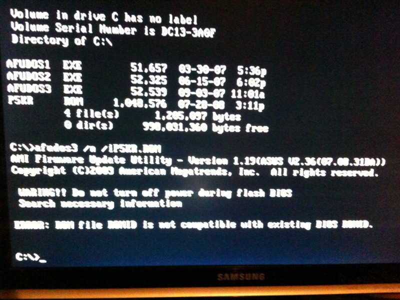

ggsm Posted February 18, 2010 Share Posted February 18, 2010 Hi, no change on my mainboard, I already tried it the first time with this method. But no success. AFUDOS1..3 are the three different versions I found on the Asus homepage. The error message is: ERROR: ROM file ROMID is not compatible with existing BIOS ROMID. I tryed "afudos /n /iROMFILE" and "afudos /iROMFILE /n" Link to comment https://www.insanelymac.com/forum/topic/200871-problem-with-asus-p5k-snow-leopard-106/page/2/#findComment-1412758 Share on other sites More sharing options...
Detrich Posted February 18, 2010 Share Posted February 18, 2010 ggsm Use this one: AFUDOS211.zip Link to comment https://www.insanelymac.com/forum/topic/200871-problem-with-asus-p5k-snow-leopard-106/page/2/#findComment-1412764 Share on other sites More sharing options...

ggsm Posted February 19, 2010 Share Posted February 19, 2010 AFUDOS211 works. But I get a bluescreen during booting Windows 7. So I give up at this point. Link to comment https://www.insanelymac.com/forum/topic/200871-problem-with-asus-p5k-snow-leopard-106/page/2/#findComment-1413415 Share on other sites More sharing options...
