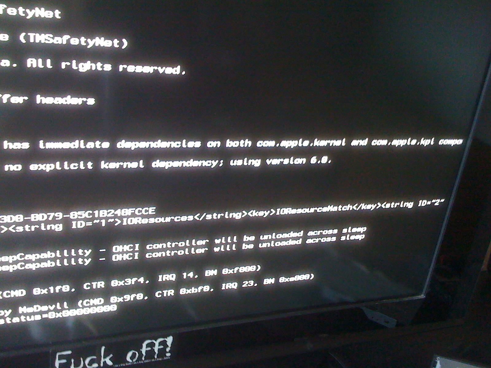

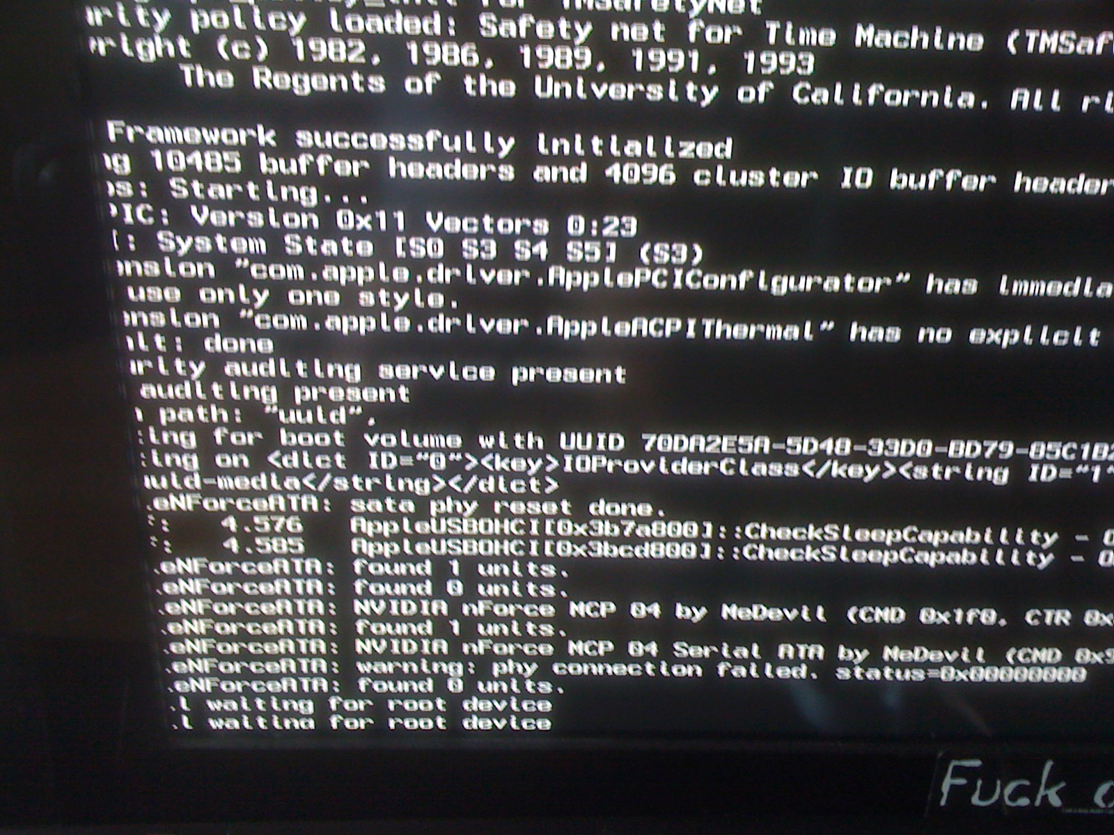

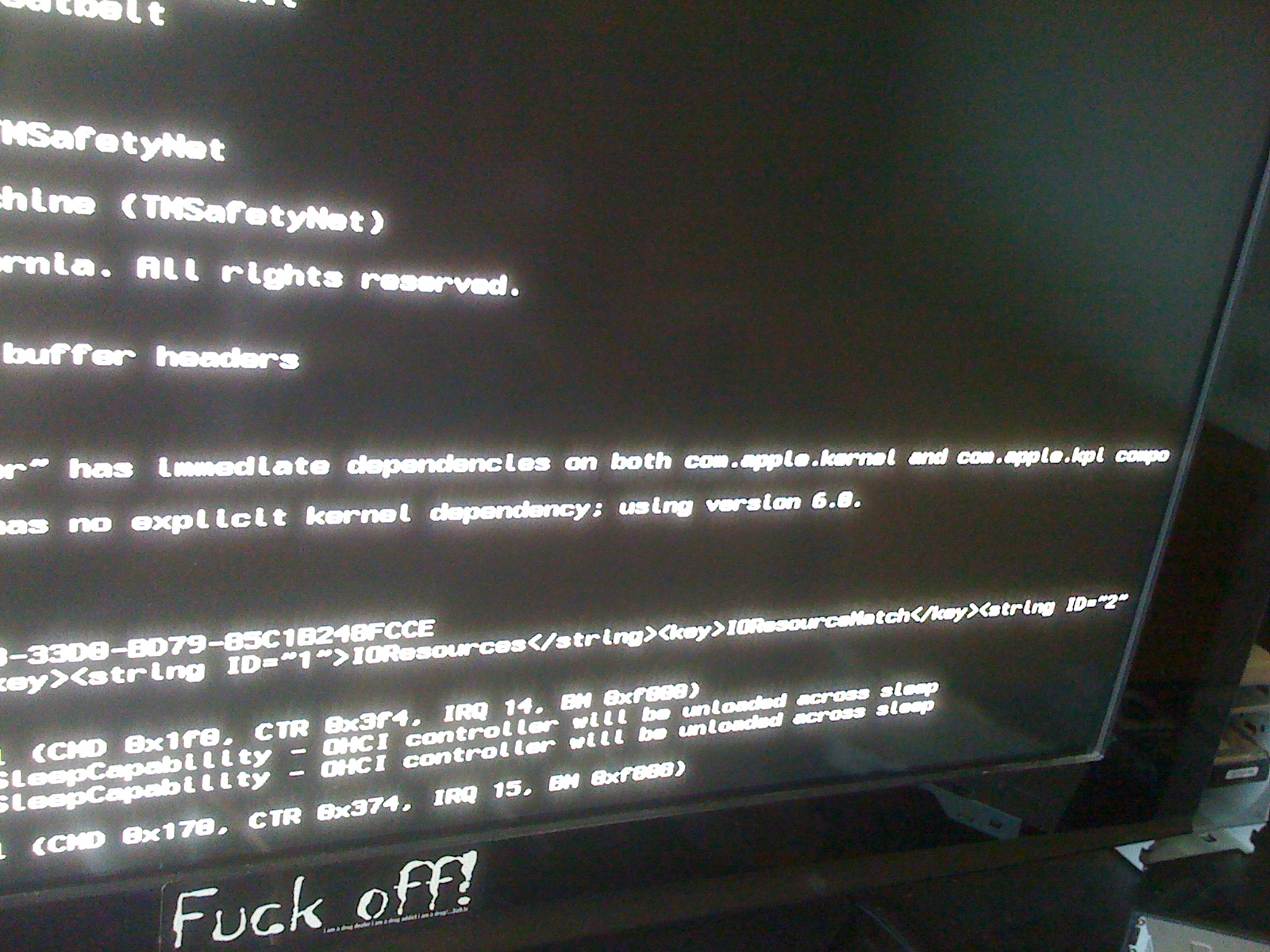

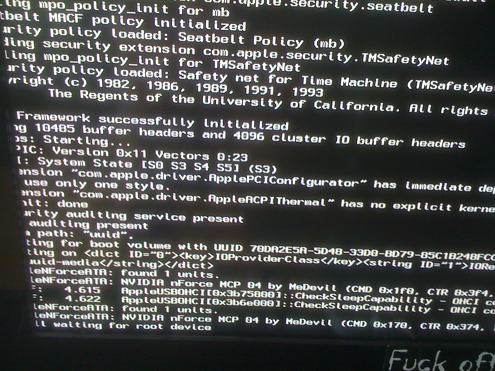

silversoul Posted November 16, 2009 Author Share Posted November 16, 2009 ok so these photos were taken w iphone, sry about the quality. the first ones (img20, img21) are using ide with i deneb 1.4 10.5.6. they are two parts and partly cut off cuz my plasma is my only monitor. the second photos (img 22, img23) are using sata with ideneb 1.4 10.5.6. i have read people useing this distro on with p5nd2 succussfully. thanks for ur help, it is much appreciated Link to comment https://www.insanelymac.com/forum/topic/197271-mac-os-x-install-wont-start/#findComment-1332879 Share on other sites More sharing options...

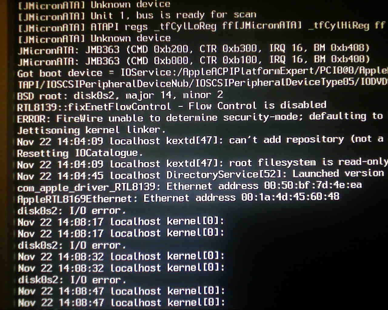

CsAbU Posted November 24, 2009 Share Posted November 24, 2009 Hey guys, I also need some help! I have: - iDeneb 1.5.1 (and 1.4, on different DVD-R discs) - Gigabyte GA-P35-S3 + Core2 Duo + 2GB RAM - SAMSUNG HD161HJ (149 GB) SATA HDD - Toshiba/Samsung TSSTcorp CD/DVDW SH-S183A SATA DVD I tried the HDD unpartitioned, partitioned without file system, and with FAT32. I also tried different AHCI settings in the BIOS setup. The installer stops with I/O error, when trying to reach disk0s2 or disk1s2 (this part is after writing some ethernet addresses in hexa). No other drives were connected (USB, IDE, SATA...). Any ideas? Thanks :-) Link to comment https://www.insanelymac.com/forum/topic/197271-mac-os-x-install-wont-start/#findComment-1340435 Share on other sites More sharing options...
