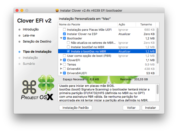

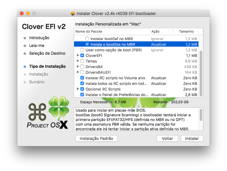

MaLd0n Posted March 16, 2017 Share Posted March 16, 2017 1- Clean install 2- Install Clover with options 3- Replace folder CLOVER GA-X58-UD3R.zip 4- Reboot with -v 5- Activate video if u have a problem, remove AppleAlc.kext, in many x58 chipset, system dont boot with kext, but if work, u have a vanilla system, native audio, etc Link to comment https://www.insanelymac.com/forum/topic/196771-ga-ex58-and-ga-x58a-dsdt-native-power-management-modifications/page/64/#findComment-2385489 Share on other sites More sharing options...
Rody Nunes Posted March 16, 2017 Share Posted March 16, 2017 1- Clean install 2- Install Clover with options 01.png 02.png 3- Replace folder CLOVER GA-X58-UD3R.zip 4- Reboot with -v 5- Activate video if u have a problem, remove AppleAlc.kext, in many x58 chipset, system dont boot with kext, but if work, u have a vanilla system, native audio, etc I dont believe is shutdown 20 times. cool The sensors no running, only temperature of HDs Link to comment https://www.insanelymac.com/forum/topic/196771-ga-ex58-and-ga-x58a-dsdt-native-power-management-modifications/page/64/#findComment-2385851 Share on other sites More sharing options...
