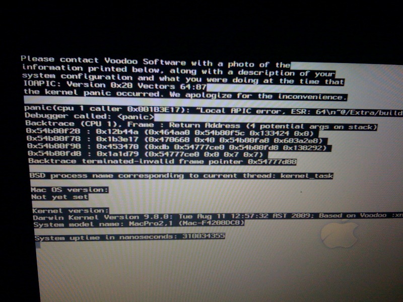

Kidfork Posted October 31, 2009 Share Posted October 31, 2009 Okay So I have attempted two install OSX86 with two distributions both Kaylway 10.5.2 and iDeneb 10.5.8 Lite and both gotten the same error. the installation is Flawless but when i get to boot i get: panic(cpu 1 caller 0x001B3E17): "Local APIC Error (more on Photo) My Computer is a HP Pavilion dv6-1352dx 4GB DDR3 Intel core 2 Duo Processor 2.2GHZ T66000 2MB L2 CACHE Intel Graphics Media Accelerator 4500MHD 250GB SATA All Help is apreciated Thank YOu. More Information Here http://h10025.www1.hp.com/ewfrf/wc/documen...=reg_R1002_USEN Link to comment https://www.insanelymac.com/forum/topic/195223-apic-error/ Share on other sites More sharing options...
vilpostus Posted November 1, 2009 Share Posted November 1, 2009 Try booting with another kernel. Like -v voodoo Link to comment https://www.insanelymac.com/forum/topic/195223-apic-error/#findComment-1316342 Share on other sites More sharing options...
Kidfork Posted November 1, 2009 Author Share Posted November 1, 2009 Try booting with another kernel. Like-v voodoo Voodoo was the kernel i installed when i used iDeneb. I've tried installing multiple kernels on both Distros and same error. Link to comment https://www.insanelymac.com/forum/topic/195223-apic-error/#findComment-1316369 Share on other sites More sharing options...
vilpostus Posted November 1, 2009 Share Posted November 1, 2009 http://www.insanelymac.com/forum/index.php...mp;#entry750125 Also may try different boot options. Like -v -f maxmem=2048 cpus=1 noapic Link to comment https://www.insanelymac.com/forum/topic/195223-apic-error/#findComment-1316634 Share on other sites More sharing options...
azhockey Posted November 1, 2009 Share Posted November 1, 2009 IT LIVES!!!!... without video or network drivers but we're really getting somewhere Booted iatkos v7 with -v -f cpus=1 noapic and then it installed like a charm. But no wifi is really the Achilles heel here. BTW I own this laptop also Link to comment https://www.insanelymac.com/forum/topic/195223-apic-error/#findComment-1316727 Share on other sites More sharing options...
Kidfork Posted November 2, 2009 Author Share Posted November 2, 2009 Thank you very much. The only think i have to add it You dont need to boot with the Maxmem=2048 you only need noacpi and cpus=1. (i installed the patch). So thanks again. Now i'm just working on Sound and Network. Ethernet Works but i need wireless for school. Link to comment https://www.insanelymac.com/forum/topic/195223-apic-error/#findComment-1317237 Share on other sites More sharing options...
