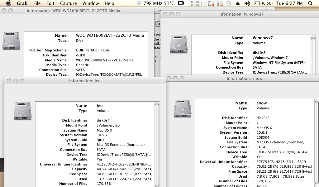

robi62 Posted October 27, 2009 Share Posted October 27, 2009 Incredible but true I managed to get the three os running on a guid partion I thought that windows7 would not as I have beeen reading but I managed it. I created 3 partitions on my hdd in guid on my aspire one d250 1st one snow 2nd windows 3rd leo. I installed my 2 osx os first then I put windows7 dvd in and it booted up and found my disk I format my partiton in ntfs then installed windows .Of course windows partition was in fat. Of course I could only boot with windows so on a usb stick installed chameleon 2 boot loader. Managed to boot in my leo partition then with osx86 tools not the latest build I run efi and installed chameleon to my leo partition then reinstalled chameleon 2 rc1 standard on my leo partition and that is is when I boot up I can choose which of my 3 os I want to go into. here is a photo to show you Link to comment https://www.insanelymac.com/forum/topic/194433-treble-boot-with-snow-windows7-and-leo-on-guid-partition/ Share on other sites More sharing options...
srs5694 Posted October 27, 2009 Share Posted October 27, 2009 A little Googling suggests that the Aspire One D250 has an EFI rather than a BIOS, although I have no way of positively verifying this. Windows 7 will (reportedly) boot from a GPT disk when a computer has an EFI. It will not do so on a stock BIOS-based computer. Very few computers today have EFI firmware; most still ship with a legacy BIOS. This is slowly changing. It's also conceivable that you're running a hybrid MBR configuration and don't realize it. From Linux, type (as root) "fdisk -l /dev/sda" to figure this out. A pure GPT configuration will show just one partition, of type 0xEE, spanning the entire disk, as in: $ sudo fdisk -l /dev/sda WARNING: GPT (GUID Partition Table) detected on '/dev/sda'! The util fdisk doesn't support GPT. Use GNU Parted. Disk /dev/sda: 500.1 GB, 500107862016 bytes 255 heads, 63 sectors/track, 60801 cylinders Units = cylinders of 16065 * 512 = 8225280 bytes Disk identifier: 0x00000000 Device Boot Start End Blocks Id System /dev/sda1 1 60802 488386583+ ee EFI GPT A disk with a hybrid MBR configuration will show multiple partitions, only one of which will be of type 0xEE. There are other ways to make this identification, such as with the OS X fdisk utility. (My OS X systems are shut down at the moment, so I can't present an example.) Link to comment https://www.insanelymac.com/forum/topic/194433-treble-boot-with-snow-windows7-and-leo-on-guid-partition/#findComment-1312400 Share on other sites More sharing options...
