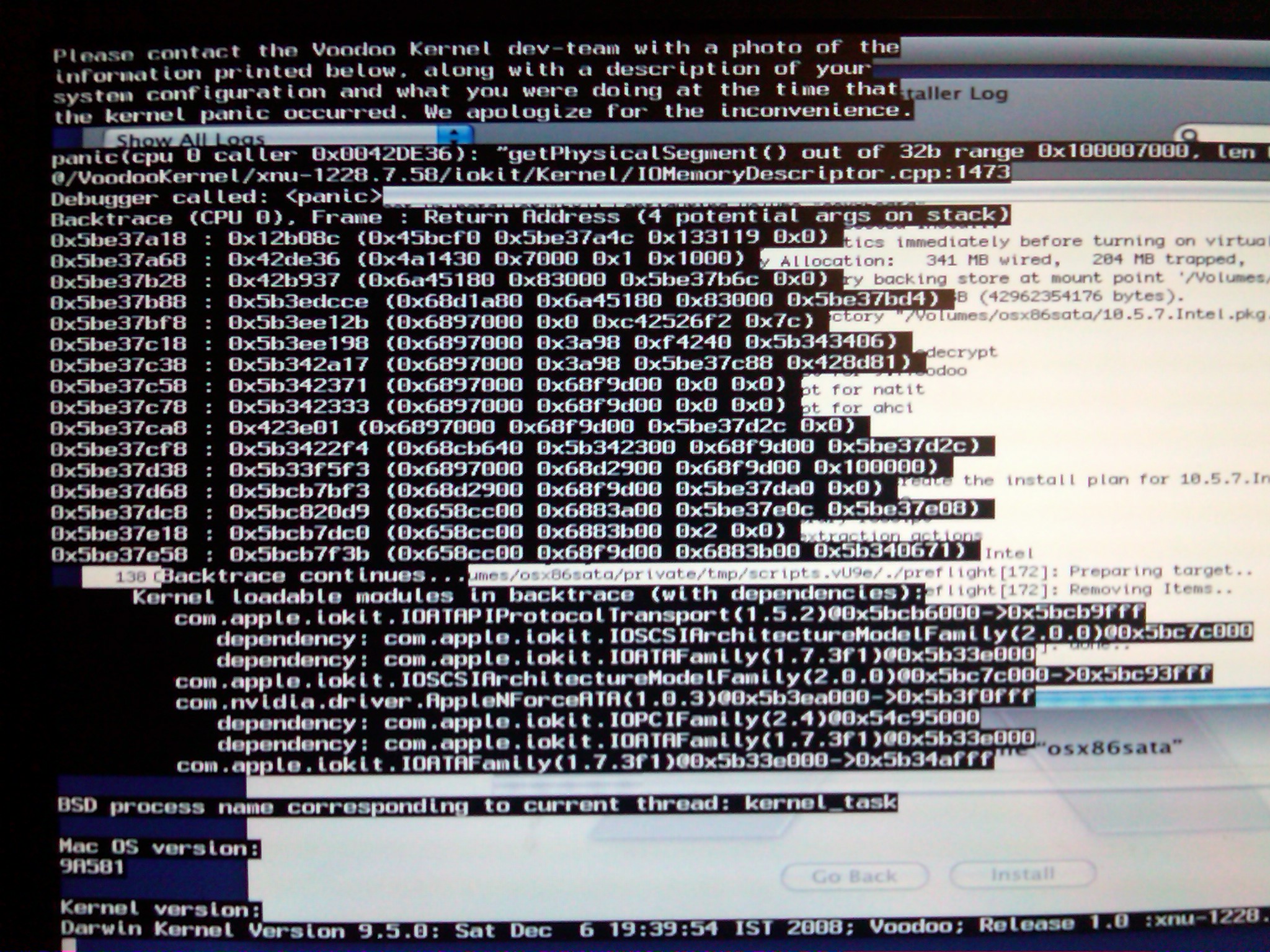

deesto Posted October 13, 2009 Share Posted October 13, 2009 No matter what options I select during the installation on my system (including the defaults with no drivers enabled), the installation crashes either during or just after the "payload verification" stage, with a kernel panic similar to the attached screen. It looks like a disk problem (IOATA), and I am trying to install to a partition on a SATA disk. I should also mention that I see "unable to mount partition" messages with the -v flag during the installation boot from the DVD. The BIOS is old (2007) and somewhat limited, but unless someone knows of an "unpublished" BIOS or mod for an ECS MCP61-PM AM motherboard (from a Gateway system ... what a nightmare they have been. never again ... ) I'm not sure what to do about that. Link to comment https://www.insanelymac.com/forum/topic/191739-iatkos-1057-kernel-panic-on-install/ Share on other sites More sharing options...

deesto Posted October 14, 2009 Author Share Posted October 14, 2009 http://www.insanelymac.com/forum/index.php...=190885&hl=Thanks for the tip. The following boot line got me through the install: -v -f maxmem=2048 debug=0x100 I selected drivers that corresponded to my hardware, installed, and tried to reboot. Chameleon v2 was installed by default as the default loader, and it came up and recognized all my partitions. I chose the new osx86 install (which was the default) and the machine rebooted. I tried a few more things, including the same command string above that got it through the install, but nothing worked. So I gave up and tried to boot into my Vista partition, but its loader was hosed; ditto for an XP partition. After two hours of playing with the Vista install disc, bcdedit, and other crappy Windows boot tools, I finally got Vista working again ... only after completely disabling every other disk in the machine except the one with Vista on it. Only then could I repair Vista's MBR. At any rate, the OSX install seemed to work, so it would be great to be able to use it if possible. I saved the install log and attached it here. I don't see a system log to check for crash info (in /private/var/log/ unless it's somewhere else). Installer_Log_13_Oct_2009.txt Link to comment https://www.insanelymac.com/forum/topic/191739-iatkos-1057-kernel-panic-on-install/#findComment-1297853 Share on other sites More sharing options...
