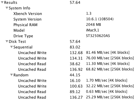

Weishauptus Posted September 29, 2009 Author Share Posted September 29, 2009 are you sure that this is the slow sata issue? i thought my xbench scores were allright, or am I wrong here? Take a look at thishttp://www.projectosx.com/forum/index.php?showtopic=564 It probably looks slightly different in your DSDT (Asus vs Gigabyte) but it should be possible to adapt it. If you search a bit maybe you can find a DSDT from someone with a P45 based Gigabyte motherboard and lift the fixes from there. Link to comment https://www.insanelymac.com/forum/topic/189508-videos-qt-dvd-not-as-fluid-as-they-should-be/#findComment-1284370 Share on other sites More sharing options...

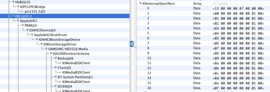

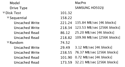

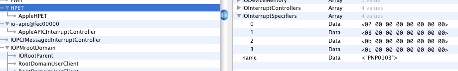

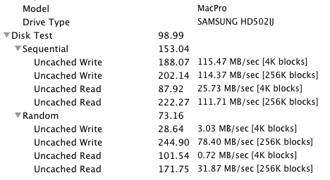

Weishauptus Posted September 29, 2009 Author Share Posted September 29, 2009 Tried the fix, got slower results, maybe i applied it wrong? my mobo does not show SATA in IoReg, shows IDE instead (but it is for sure a SATA Controller and HDD ) Here are some screenshots (they took place after the fix, right now its HPET at 08+14 and IDE at 13+00): (The IDE Controller did not switch its IRQ as in the guide, so I probably screwed up somewhere i guess, also the system liked to freeze after the patching, so I reverted to my initial DSDT) edit 2: wow, had to restore my Cham partition and my System Partition from Backups, because of subsequent freezes ^^ Link to comment https://www.insanelymac.com/forum/topic/189508-videos-qt-dvd-not-as-fluid-as-they-should-be/#findComment-1284487 Share on other sites More sharing options...
Beerkex'd Posted September 29, 2009 Share Posted September 29, 2009 LOL, sorry I got you into trouble, he did say that the fix is for ASUS boards but I thought it was worth a try because it fixes stuttering audio. Your issue sounds like a timing problem too. You could also try removing VoodooPower.kext to see if it has anything to do with CPU throttling. ICH10 is S-ATA only, so it's strange that you don't see SATA in ioreg. Do you have AHCI enabled in the BIOS? Make sure your SATA HDD(s) are actually plugged in to the ICH10 and not the Jmicron or whatever external drive controller your board has. OSX supports ICH10 natively since 10.5.6 so unless you have some funky device IDs and/or your BIOS settings are wrong it should show in ioreg. /EDIT hmm, my own scores are even worse.. It's an older drive though but still. I'm not sure if the scores should be better. Link to comment https://www.insanelymac.com/forum/topic/189508-videos-qt-dvd-not-as-fluid-as-they-should-be/#findComment-1284885 Share on other sites More sharing options...
